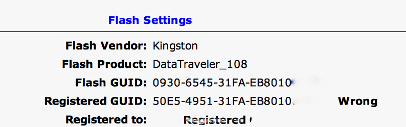

I'm still quite new to unRAID but I got to the point where my server was up and running. Once I had everything how I liked I shut it down and move it to the basement to it's permanent place. Upon starting it back up I found that the USB Flash Drive was dead. I couldn't read off it. I plugged it into another computer and nothing. Then I thought it was my MB's usb ports, nope as I was able to use another USB Flash drive in the same port and worked fine. As per the title I bought the Pro version of unRAID.
I naturally freak out as I thought I had lost everything, after some reading and breathing deeply for a few minutes I thought of emailing Lime Tech to see what they could do. I was pleasantly surprised that they told me they would be able to switch the Registered GUID from my dead flash drive to a new one. I sent the new Flash GUID and within 24hrs I got a new Pro.key. I stopped the server and copied over the new key, started the server back up again and to my surprise I still only got the Parity and two drive options.
Upon further inspection I noticed that when I sent the GUID to Lime-Tech support 8 digits out of the 27 were wrong. I took the GUID from the main page of unMENU (//tower:8080) and I think that may have been my mistake. I've included a screen shot.
I did send Lime-Tech another email explaining my situation but have not heard back. Is there anything that can be done within the config file or go file to set the correct GUID or am I out of luck? Any help is appreciated.
