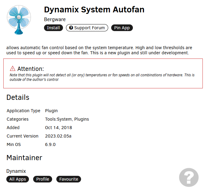

looks like this can be added and used with the Dynamix Fan Auto Control plugin

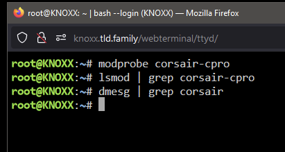

Hey @bmartino1!
Thanks for pulling that together. I didn't see that post you referred to!
I tried the cli commands and oddly enough.....nothing was returned for any of them?!
Did I miss something?

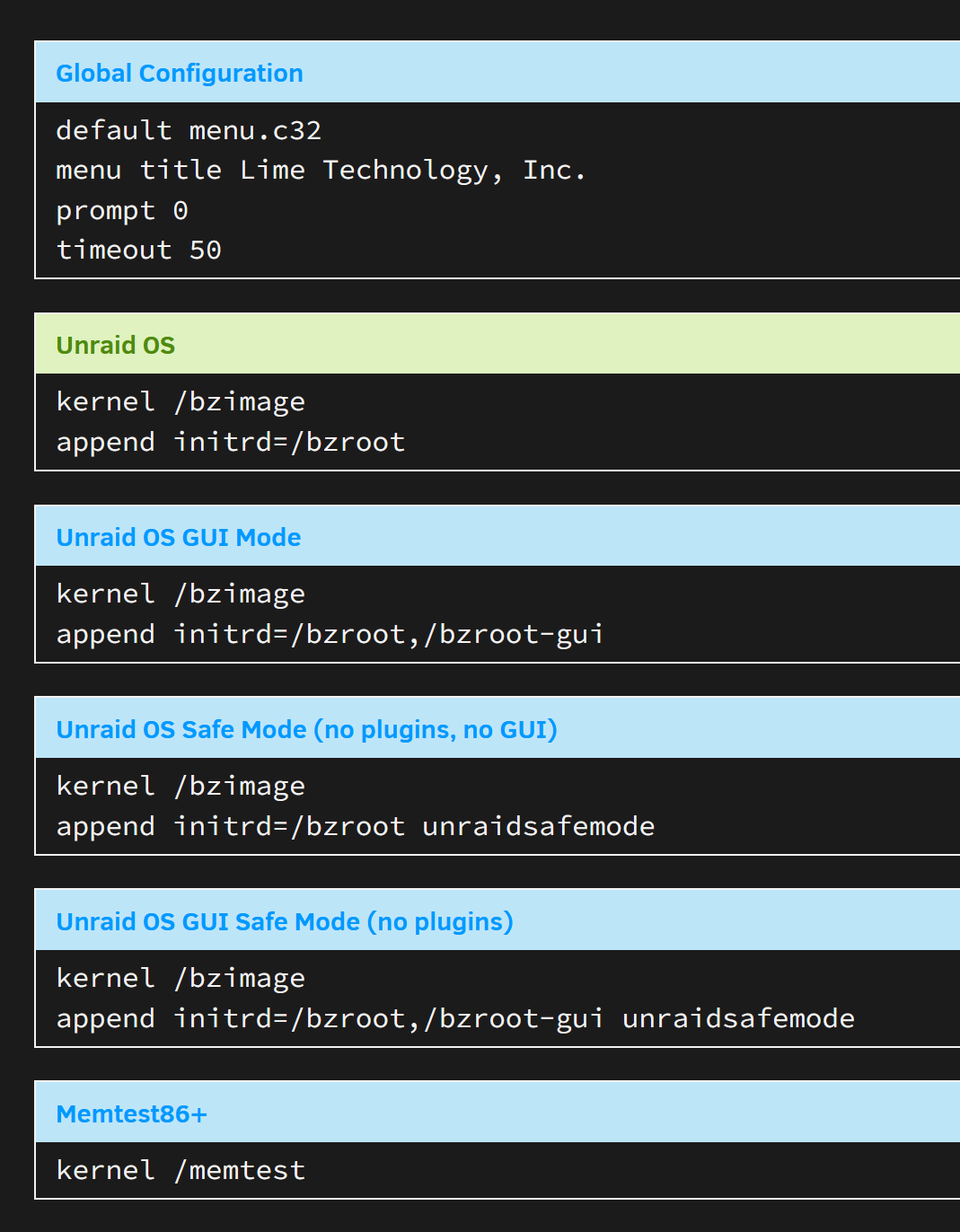

I started hunting for info on kernel options -I'd never heard of that before being a Linux newbie.
I found the config on the Flash drive, and it looks like mine is the default standard with no other options enabled. The thing is, I'm not sure what I need to put in there to enable the USB_HID. I tried wrapping my head around what was listed on the links you shared, but nothing was clear to me.
this is concerning:
this tell me that the unraid version and kernel you are running doesn't have the driver support installed and enabled.
Also, this wouldn't be something you add to grub/syslinux to boot to add to the kernel. Unraid builds this to be small and fit on a flash drive. This was a optional item in the kernel when they compiled it.

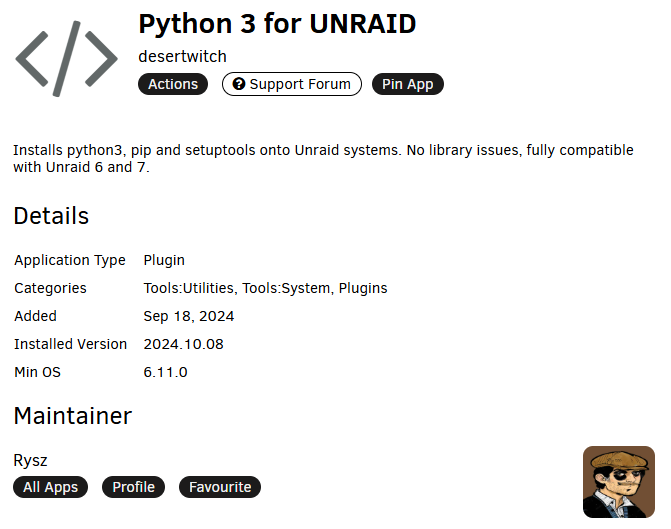

maybe plugin/app:
my searching for linux support keep bring me to this github project... Unkonw if uraid can or will support it..
https://github.com/liquidctl/liquidctl
as this is a python/shell system i can't guranteee a dashbaord.
However you could try and use the user script plugin and python plugin fo unriad
git clone the repo and try to run the commands...
this may no longer be compatible with unraid.. :/
