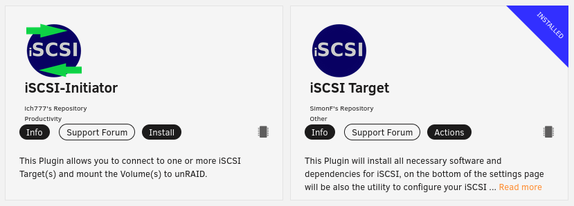

I don't know if my translator actually translated everything correctly but iSCSI (both Target and Initiator) is available on Unraid through Plugins:
Just search for "iscsi" in the CA App.

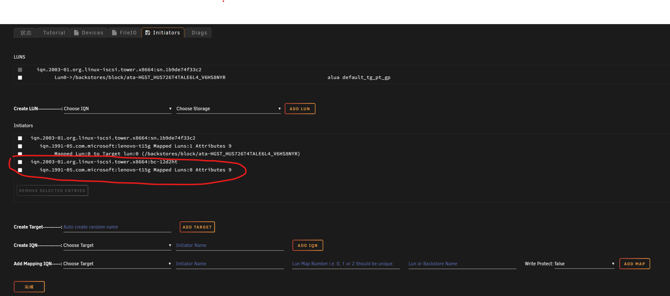

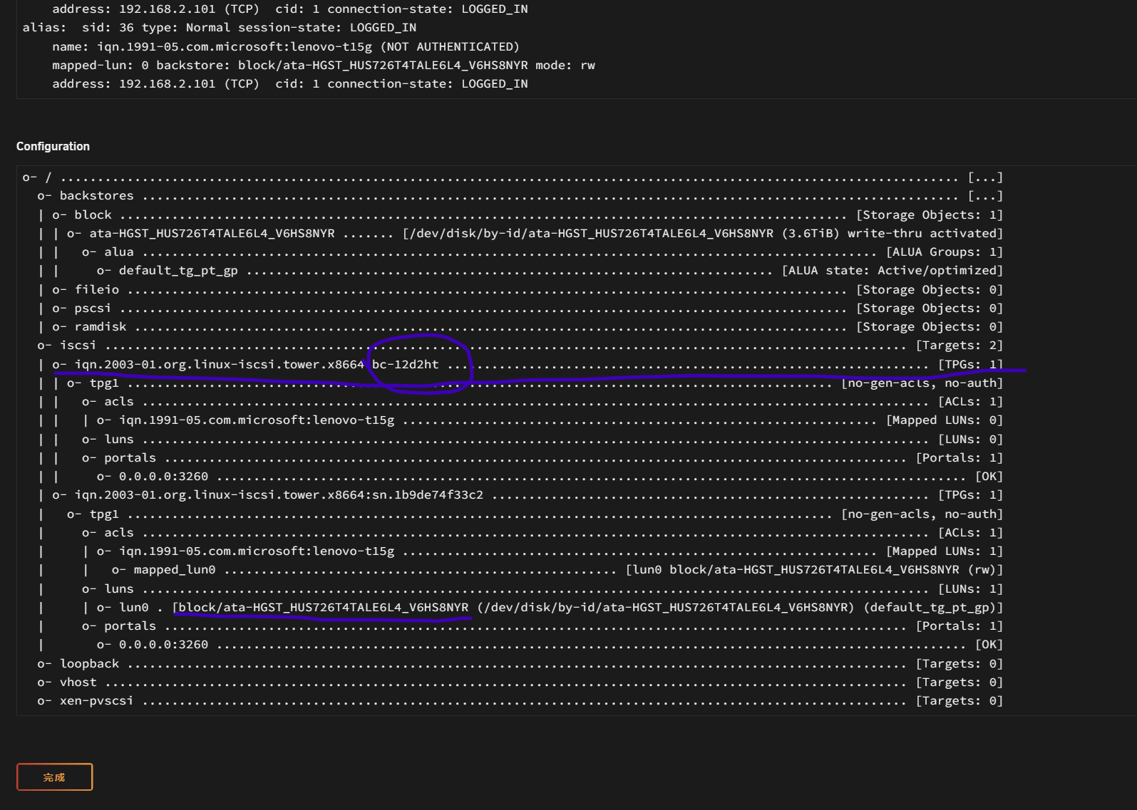

Here is the config, HDD works well., DVD driver had been remove and LUNS had been deleted 2024-12-16110906-2.thumb.png.f002dbbd2e9d5f955da5283607e81f4d.png2.thumb.png.7f5ded96a9274a8a5a3202cd3e98e7e7.png

I think you need to add a pscsi rather than block. The gui does not support a this time but you can do a manual entry.
pscsi backstore
Create a pscsi storage object if your storage object supports direct pass-through of SCSI commands. For creating a pscsi backstore, see Creating a pscsi storage object.
https://www.smetana.name/blog/2014/10/20/sharing-dvd-drive-over-iscsi/
