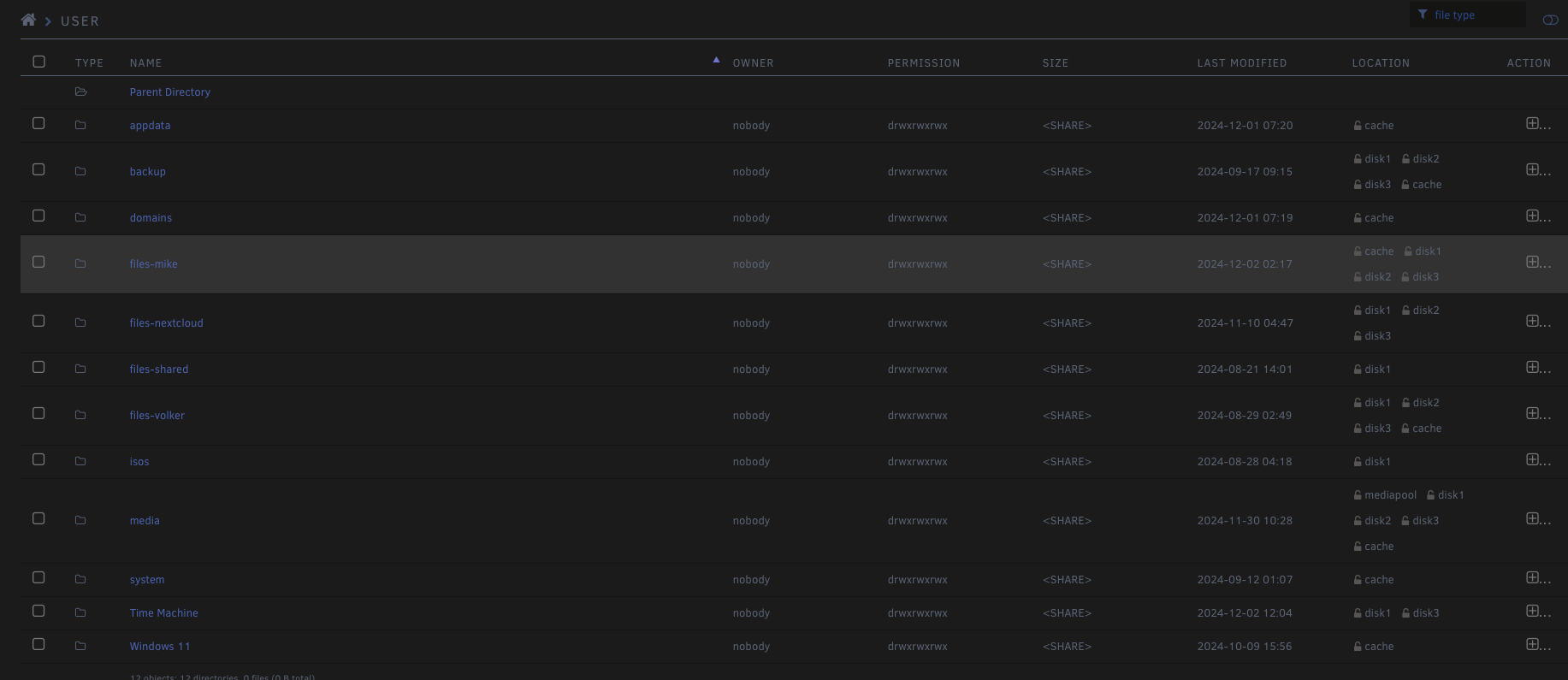

I'm still seeing share related errors, do you have anything mounting under /mnt/user manually? That mountpoint is reserved.
with manually you mean not setup in the shares tab? not that I'm aware of...
I have linke the VM to a share to access the unraid folders.
Besides that I can't see anything suspicious

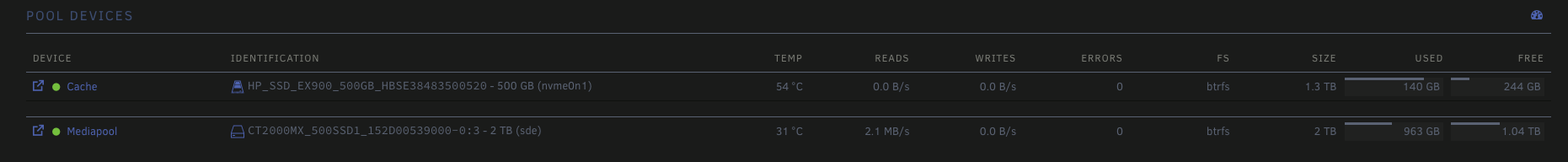

@JorgeB I found something suspiscious
My cache drive is 500GB but shows 1.3TB Size...
Pool has a missing device:
                  Data    Data      Metadata  System
Id Path           single  RAID1     RAID1     RAID1    Unallocated Total     Slack
 1 /dev/nvme0n1p1 1.00GiB 462.73GiB   2.00GiB 32.00MiB     1.02MiB 465.76GiB     -
 2 missing              - 462.73GiB   2.00GiB 32.00MiB     1.37TiB   1.82TiB     -
   Total          1.00GiB 462.73GiB   2.00GiB 32.00MiB     1.37TiB   2.27TiB 0.00B
You need to correct that, but still need to free up some space first.
I was able to free up some space and now docker is running again.
But I never had a second drive as cache. I have that drive setup as a second, independent pool
Any idea how to solve that issue? I also don't see a warning about a missing cache drive like in other posts on the forums.
