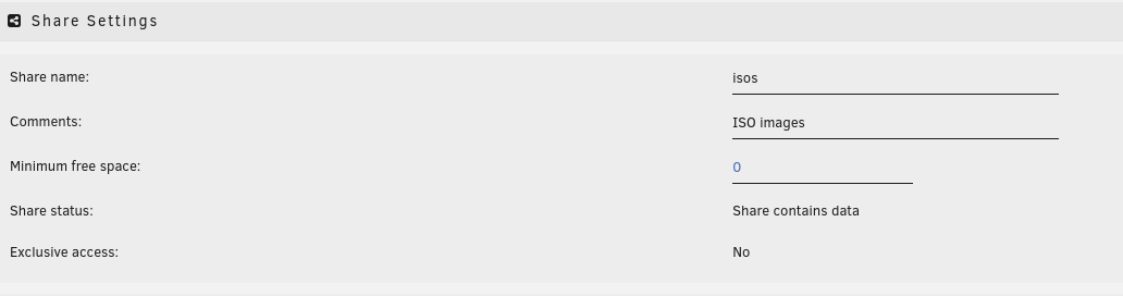

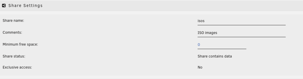

This is what I see in share settings:
As far as I can tell these shares are not set to go to cache?

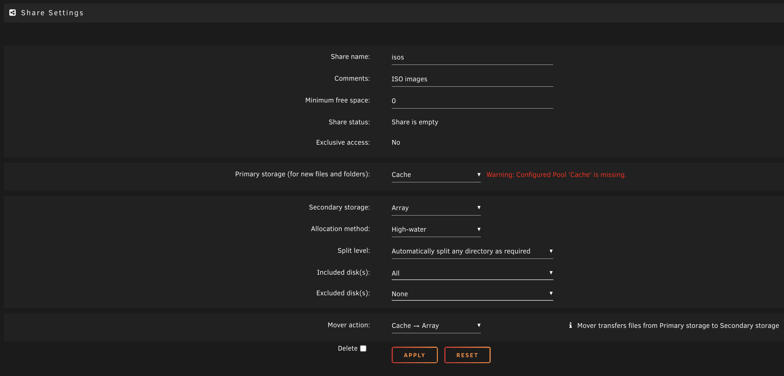

Same issue. A dummy change save did not resolve. This is a brand new install with one Array and the auto-created "appdata" & "system" shares. These 2 shares have the warning.
I did create an additional new Share, and this new share does not have the warning.

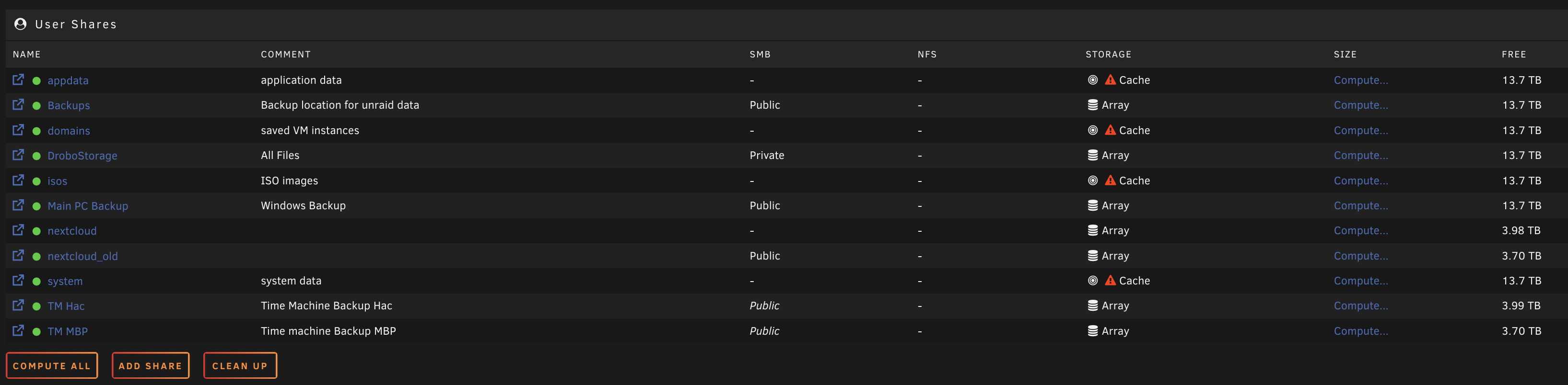

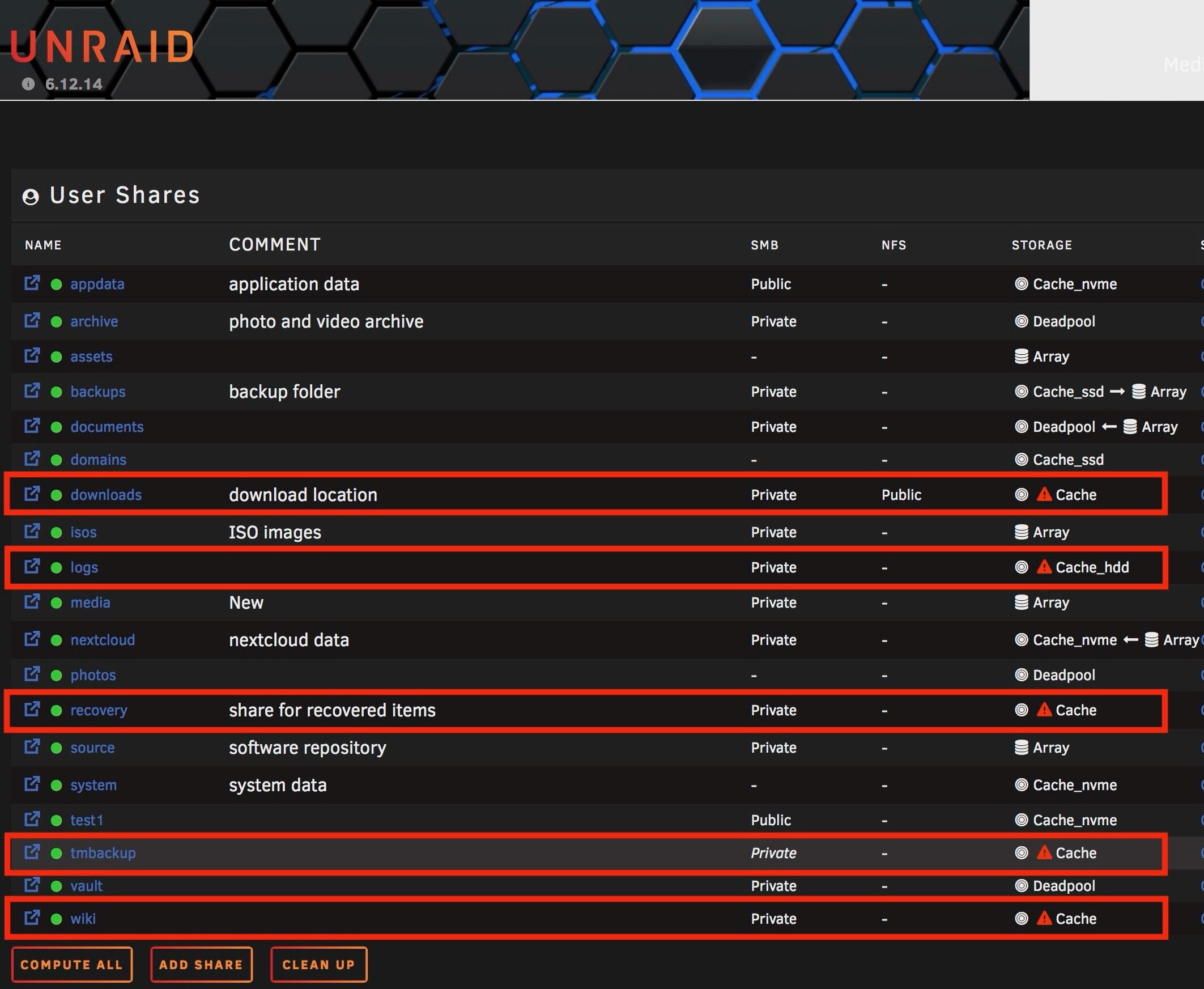

I seem to face a similar issue. Also likely since the 6.12.14 update.
Some of my "user shares" show as "This share is invalid, it references storage that does not exist". Storage shows as "cache", which doesn't even exist. When I select the user share, it shows all the files, which are on a different storage. So, I am not sure whether this issue impacts in any way or is just a UI issue?

Same issue here. The storage names were old and have not been used in a while but after the upgrade they reappeared. I did make a dummy change to each share using the Minimum free space setting and that seems to resolved it. They are now showing the correct storage (Array).
eos-diagnostics-20241207-1011.zip
This means the old share cfg files were still referencing the old pool, and by making the dummy changes it's now fixed.
Thanks JorgeB for the feedback. I can confirm that looking at a backup I do in fact see shareCachePool="cache" in some of the share cfg files.
