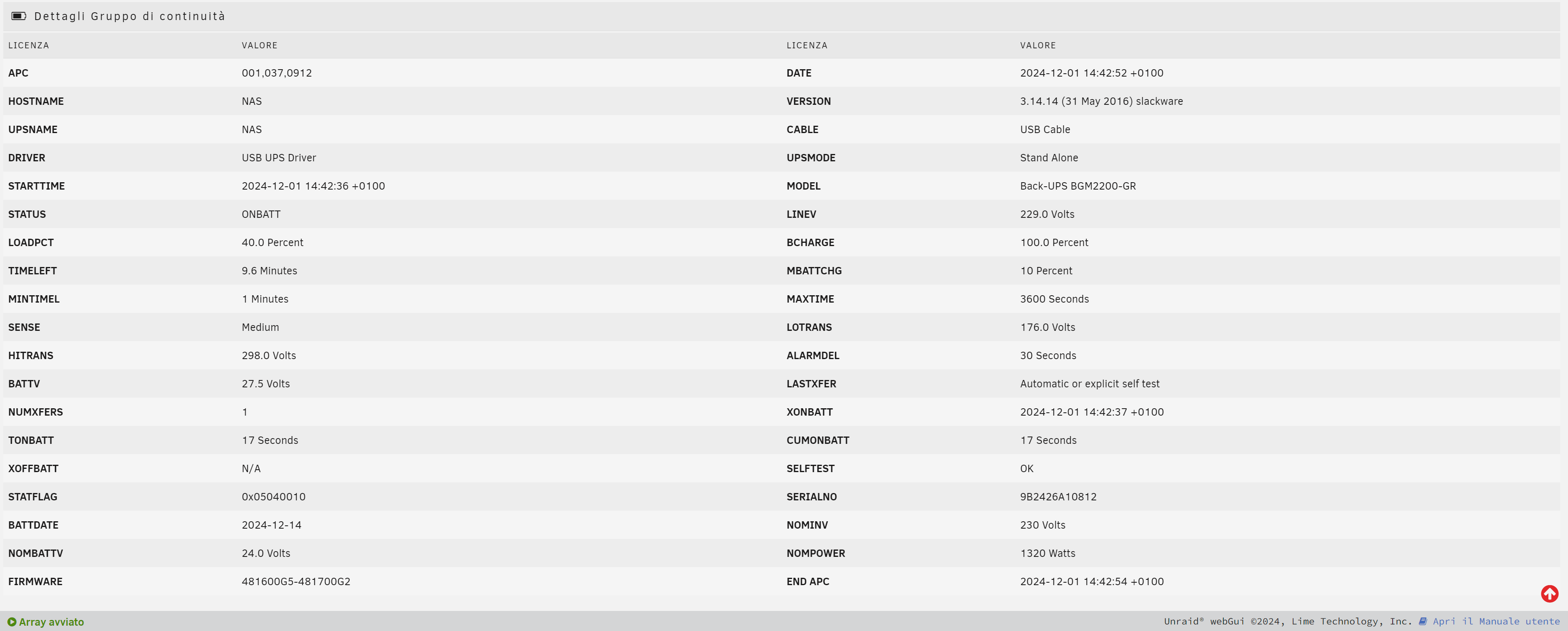

I just received a brand new APC BGM2200-GR UPS but I'm not able to get it working under Unraid (v. 7.0.0-beta.4).
I just connected my UPS to my UGREEN DXP6800 Pro and I enabled "Start APC UPS daemon" in the Unraid Settings.
Since it's a USB connect, I left any setting to default, but my UPS is always recognized as "On battery" and the shutdown process is performed.
These are the UPS specs recognized by Unraid:

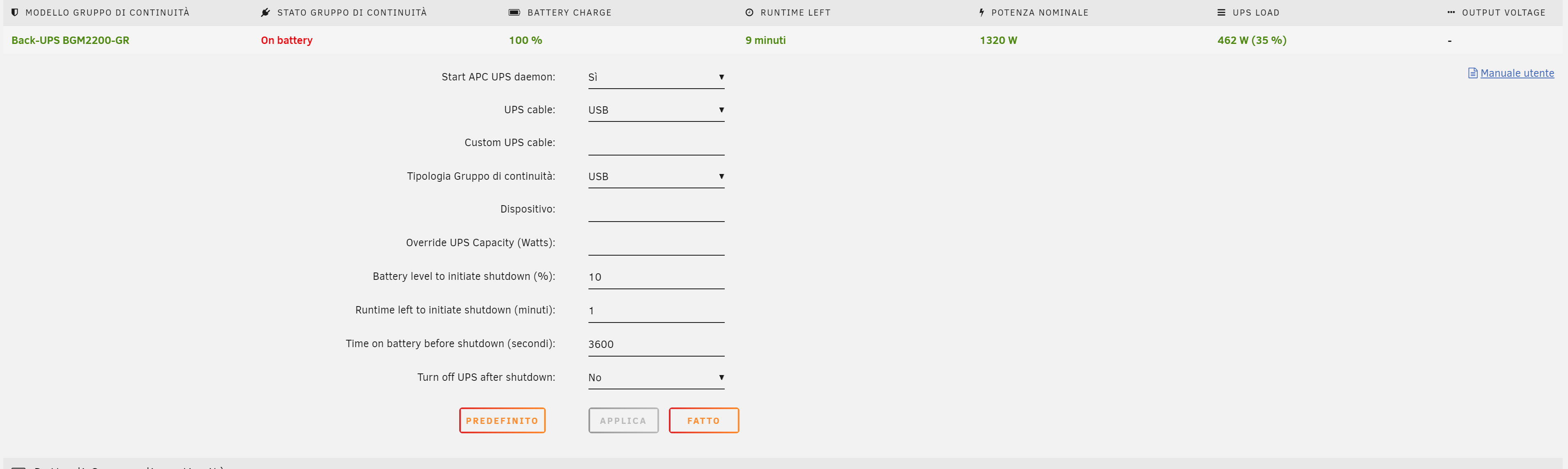

Then I changed the shutdown settings in order to have more time to try different settings.

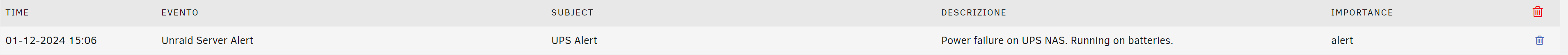

Anyway, whenever I enable the deamon, a warning will popup telling me that the NAS is running on battery.
Is there anyone who can help me?

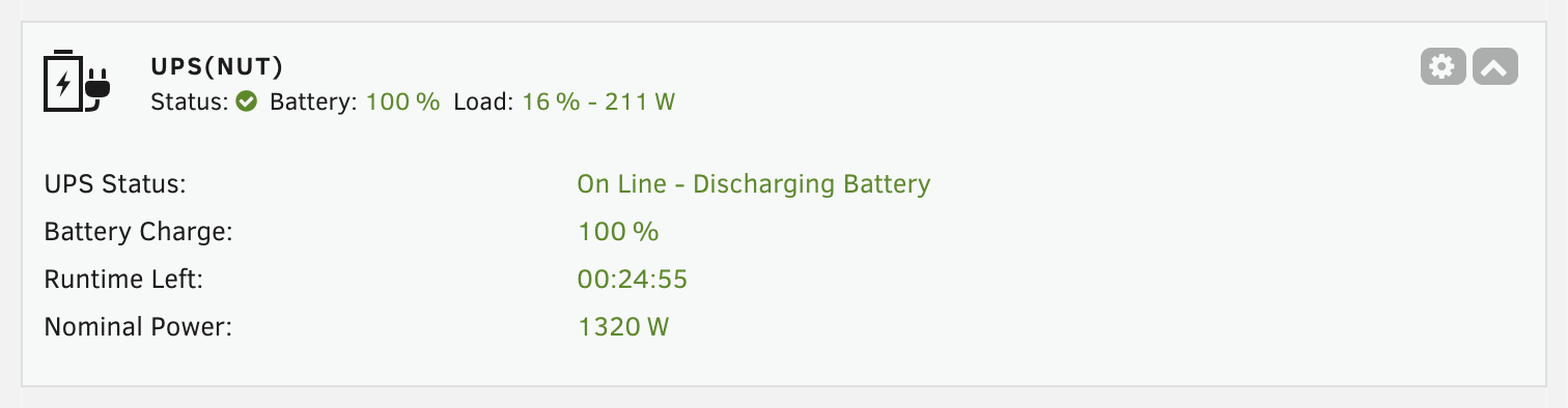

Hello,
I installed the NUT plugin but it works like a charm:
I don't know why it works with a 3rd party plugin but not natively since it's an APC UPS.
Strange, but great that it works there.
But still showing discharging battery, lucky NUT won't go to shutdown announcement.

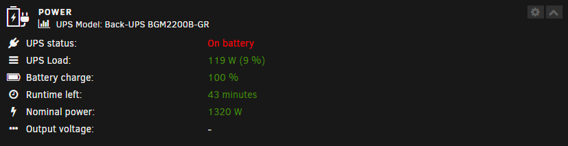

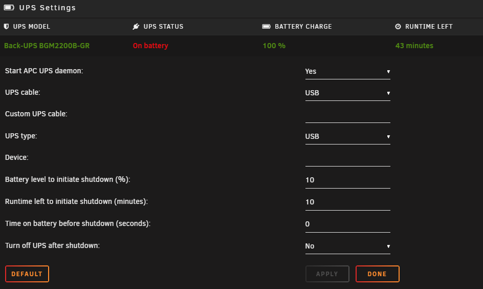

The same problem. Changed time on battery to 0 and system is not shutting down. Didsomeone have a fix for this?
image.png.385a8568b61655bfd6fc38616b06ff6c.pngimage.png.6dd7f5ce0a740f2d4534eb1da27446fd.png
Try the NUT plugin, but the UPS appears to be indicating the wrong status.
I have the same UPS and unfortunately the same error messages. However, when I let NUT run, after a while it causes my server to hang up. The error message repeats for about half an hour before it causes my server to hang up.
