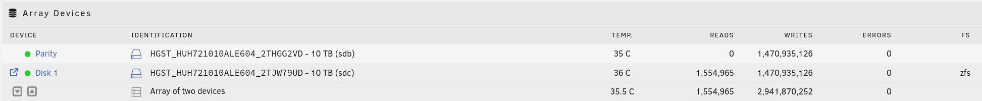

I made a 2 disk array using ZFS. A disk in parity and a disk in slot 1.
But this makes it seem like it is a single disk array, not raidz:

Am I correct? This is not raidz and my data is not protected from disk failure?
