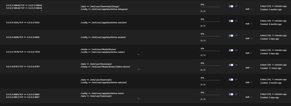

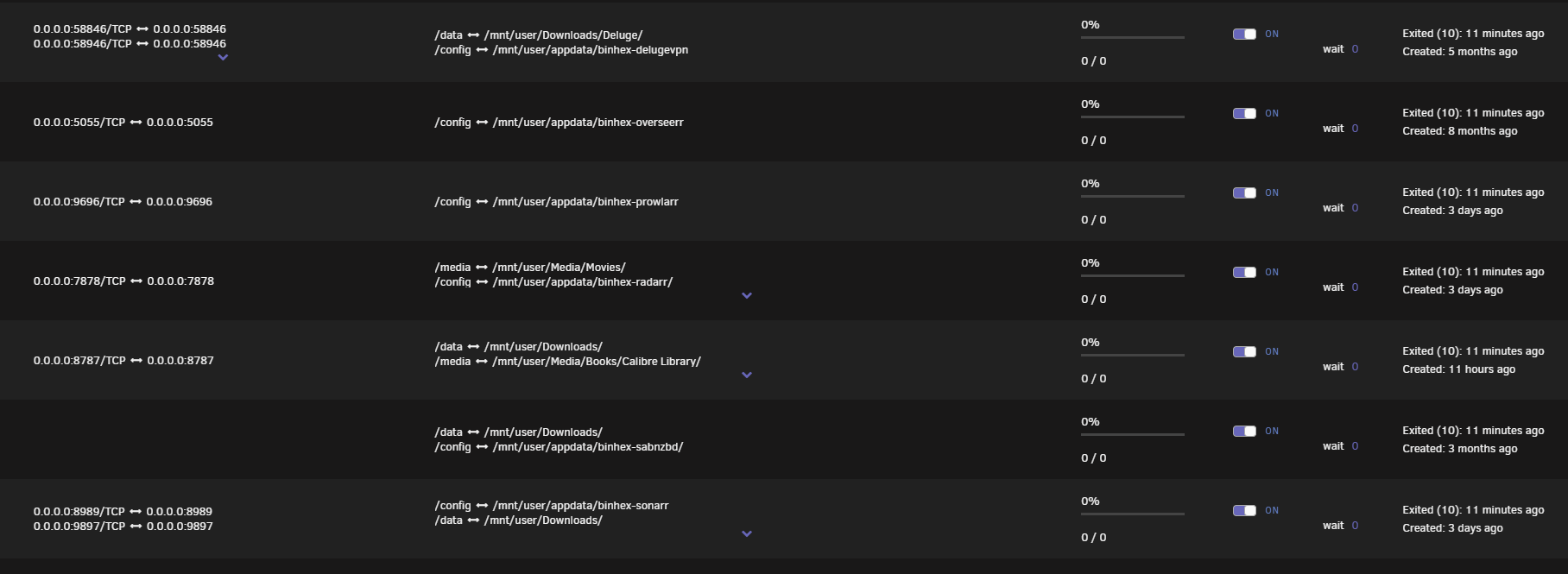

Another restart and the cache drive is back.. The following containers aren't running:
I was able to get the docker containers to fire back up by doing a force update on them.

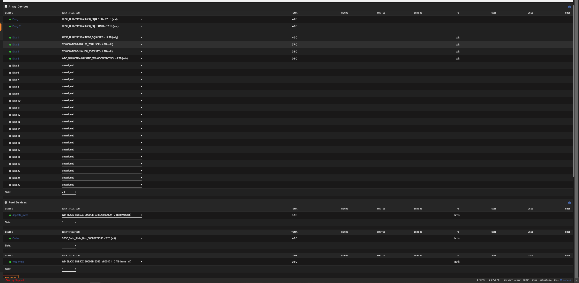

So how screwed am I, for whatever reason the cloud based flash backup is no longer active and I can't generate a backup from there (even though I have been able to in the past). The USB drive is now unreadable... I have a picture of the drive assignments but that is about it...
Edited by crspangenberg
For the devices you just need to reassign the as they, use the screenshot, did you manage to copy anything from the flash? You just need the config folder.
No, unfortunately the flash drive went belly up. Can any of this information be gathered from the diagnostics that were run on the server before this happened?
Some info/files can be gotten from the diags, but you can just assign the devices and then reconfigure the rest, like network, server name, etc.

@JorgeB, that cache drive that started this whole thing isn't being recognized, before I start the array, should I replace the drive with a different ssd? Does it matter the size?
In reality, I don't necessarily need the drive, could I use one of the existing NVME drives, and adjust the shares accordingly?
You can.

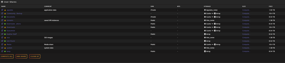

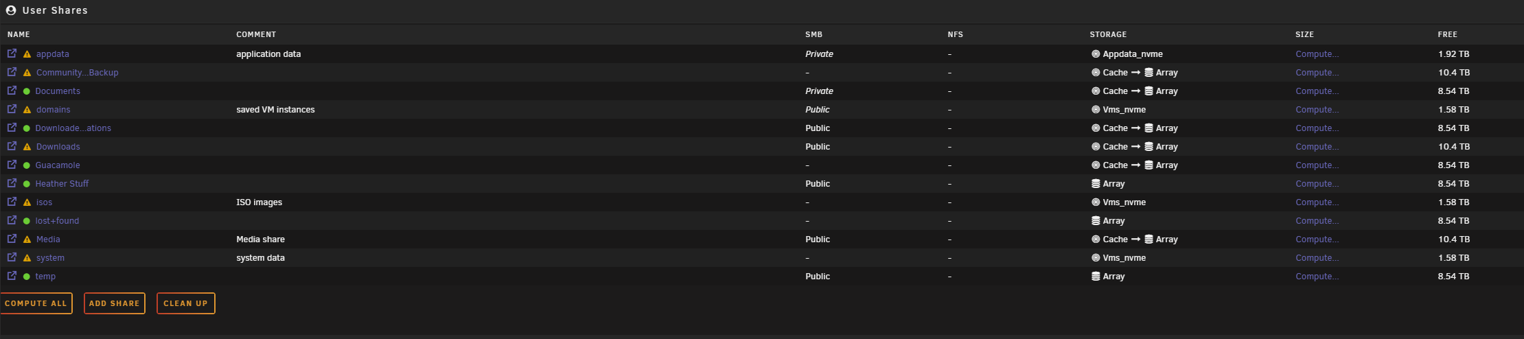

Shares are now showing errors:
I see in my community application backup there is a flash back from a few days ago.
Would my best course of action be to replace the SSD with a drive of the same size as a cache pool. And then restore from this backup?
I assume cache no longer exists? If yes, you just need to correct the shares and click apply.
@JorgeB, correct Cache doesn't exist. Changing the shares does fix the issue, however Inoticed that my Plugins are now missing as well. If I restore from the backup and add in a new Cache drive will I cause any issues? I really would like to be back to where I was before this all started occuring.
I've made so many changes to the system over the years that I really don't know where to begin in getting everything back to where it was.
Correct the share primary and secondary storage and clicking apply must fix the shares, you may need to just make a dummy change, the important part is to click apply.
