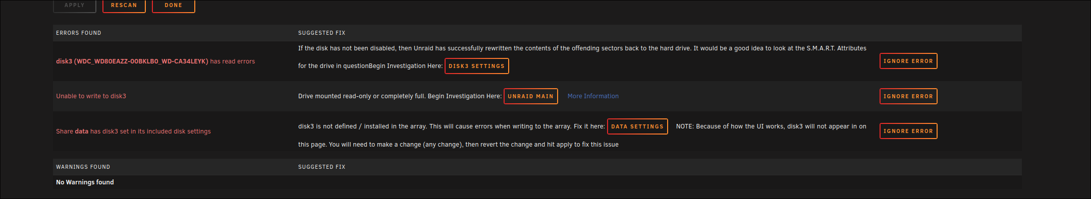

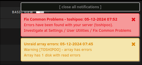

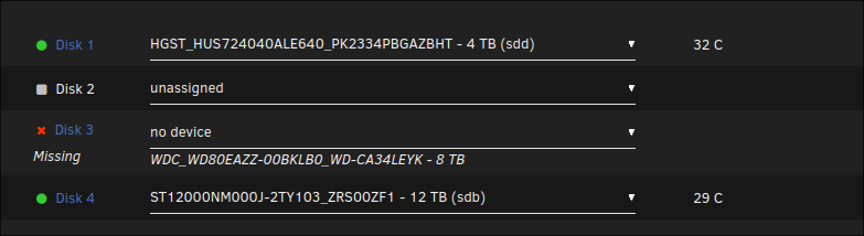

I'm having an issue where my server will be working fine but then I'll randomly get an error notification saying a disk in my array is having read errors. When this happens, I'll stop the array and the configuration will tell me I have a drive missing. Only when I reboot will all the drives appear to be there. Then after a while, be it 10 minutes of several hours, it will have read errors again then rinse and repeat. Sometimes I have to open my server and fiddle with the cords before the drive shows up again. It's done this with both Disk 1 and Disk 3. Although after gutting my computer and replacing all the SATA cables, it seems to be only disk 1 now. It should be noted that none of these drives were in an error state. They are simply having random read errors that sometimes cause my shares to disappear until a reboot.

So far, yes it's just those two disks. There was also a time when I removed all my drives from the controller and used just the SATA ports directly on the mother board and I still got the read issues, of course that was before i removed the parity drive that was going haywire. Whenever the read issues seem to happen, the sys log says disk 3 is having read errors but when I take the array offline, it's disk 1 that appears to be missing. As of right now, the disks have appeared to have lasted the night without any read errors, I'll attach an updated diagnostic just in case.

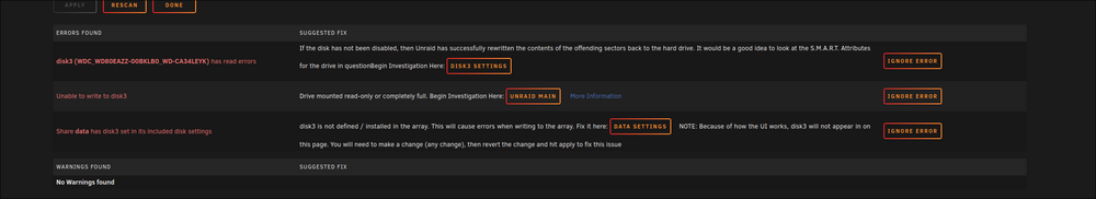

I spoke too soon...I have no notifications of read errors but Disk 3's file system seems to not be present now. From the Dashboard everything appears normal but DIsk 3's files are gone as well as some of my shares.
I am so confused, if it actually did disconnect, why did everything appear fine on the dashboard and the SMART status still healthy? And why were there no notifications of this happening?
Anyways, disk 3 seems to be the sole issue now but the problem was definitely present with disk 1 at some point so it may very well be where it was plugged in to the motherboard. Going to try again removing all drives from the controller and just use the SATA ports directly on the motherboard.

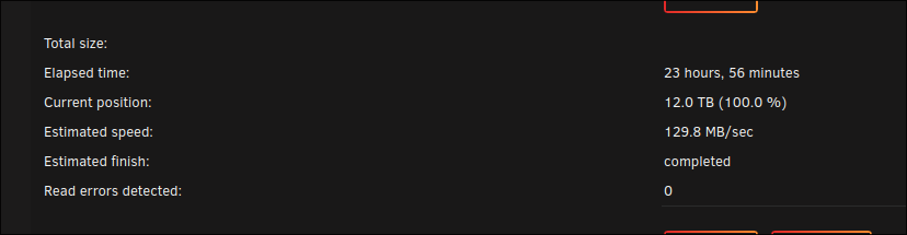

Cool, I'll run a read test. if it completes fine, I'll just mark this as solved. Thank you!
Beautiful. Thanks again!
