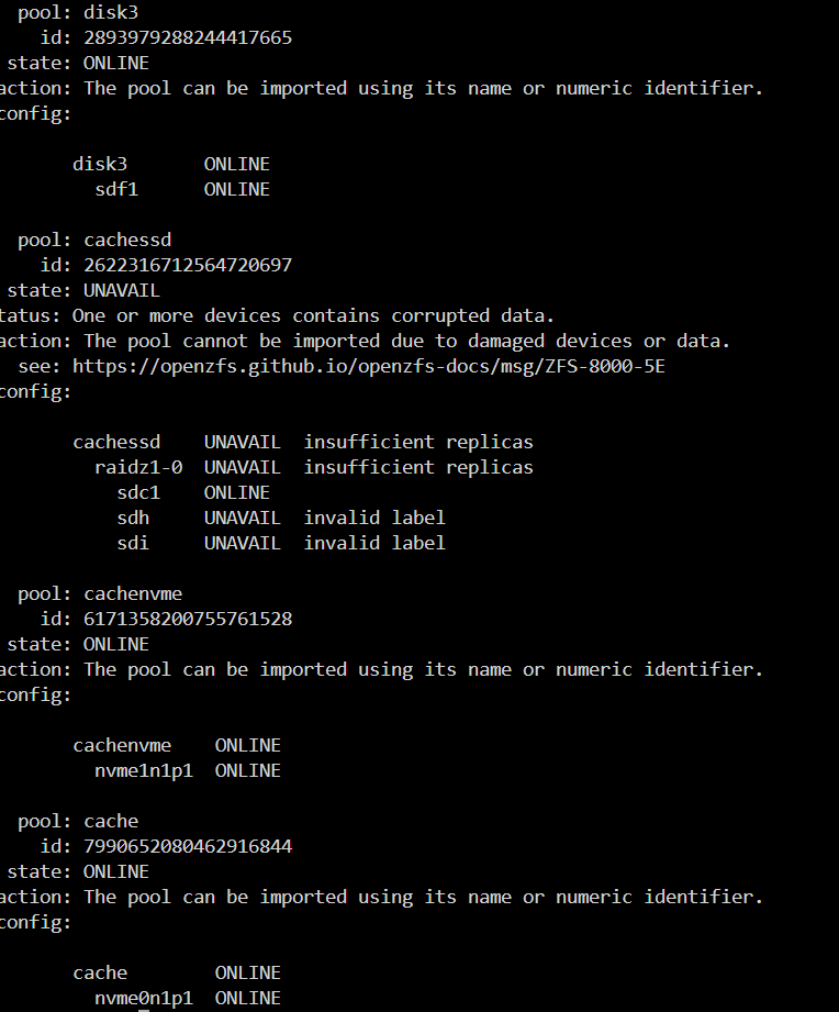

zpool import returns
Which is strange since I didn't do anything to the cachessd pool which  shows as unavailable.

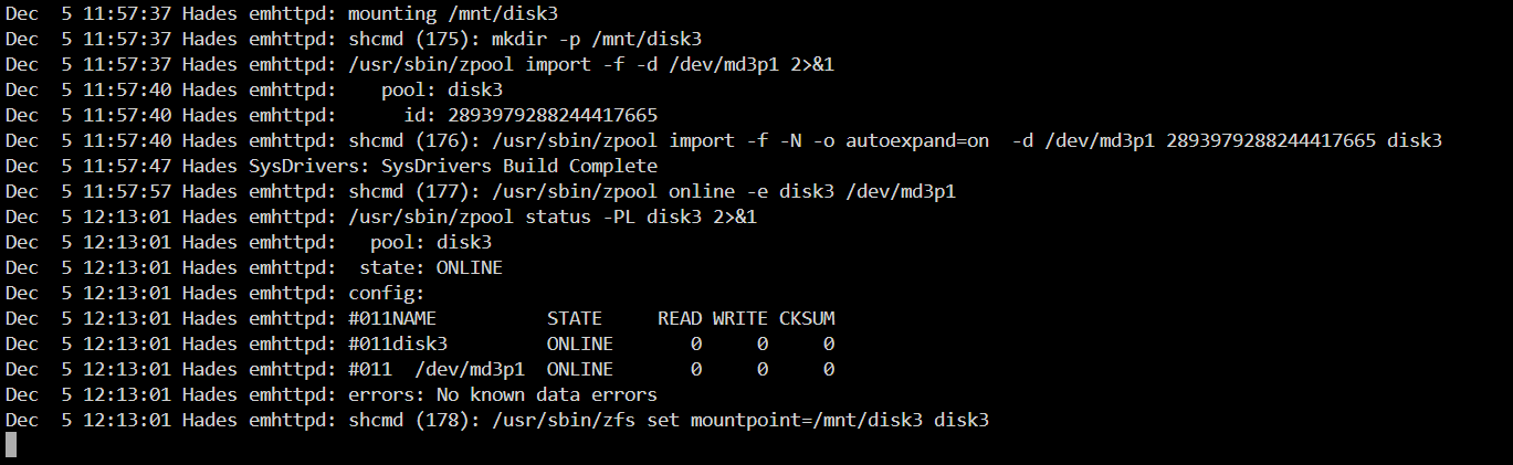

Not sure if the issue is disk3 or the pool, see if disk3 imports in the CLI:
zpool import disk3
zpool import disk3
I entered this , took like 10 mins and came online.
If not disk3 problem maybe its the cachessd pool zfs raidz1?

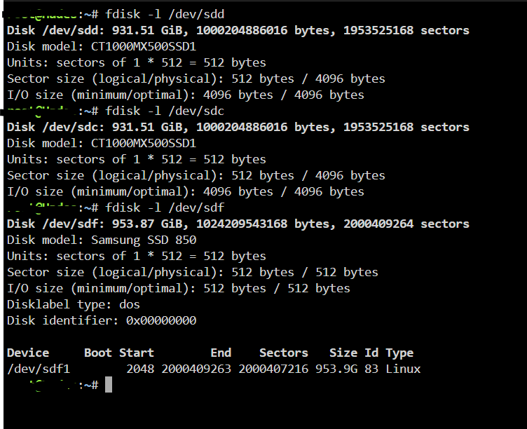

I came across this topic
Do you think it is a partition problem in my case as well?
Even though the two bad disks aren't identical to the still working one?
fdisk -l
image.png.2b561a14927363a56eab4546fed917b7.pngfdis
If there is no other ideas I think I will try this solution
Edited by Zentachi
If it took 10 minutes, this could be the delay, though the pool also has an issue.
Since two devices are missing the partition, was the pool created with Unraid?
Yes it was created with Unraid. I tried a couple of things but nothing worked for the cachessd pool. So I destroyed it and will rebuild it from scratch.
