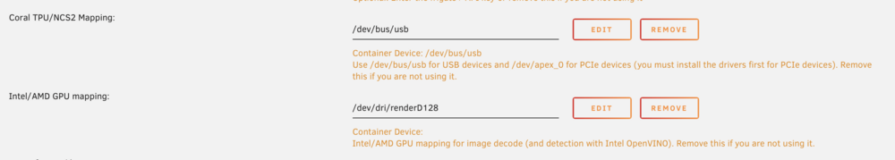

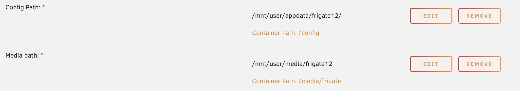

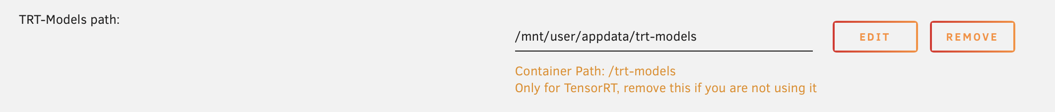

Checking all of the container maps nothing should be an issue:
I don't think I am using this so I probably need to remove it.

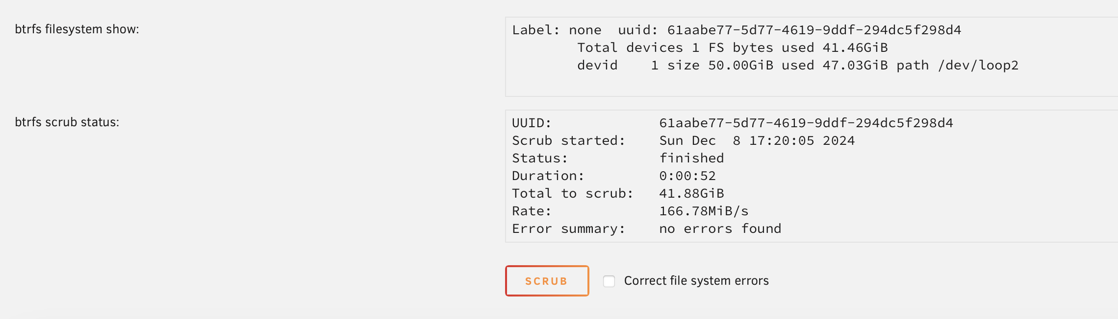

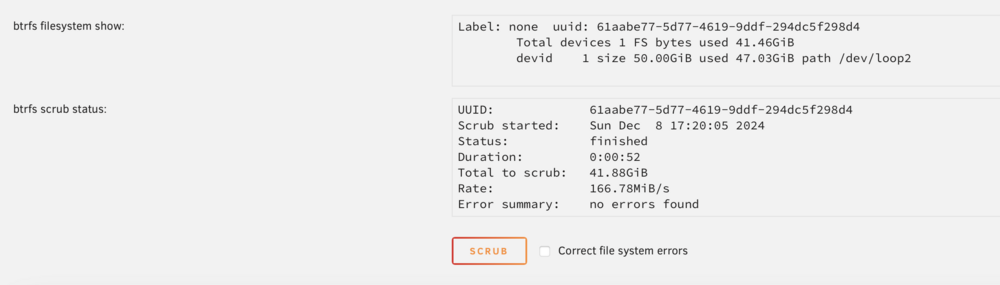

But this doesn't make sense -
My docker is set to 25GB and yet is showing this in the docker setup:
Label: none uuid: 539c2bc6-d6d9-461b-ae29-22dc0f3538f0 Total devices 1 FS bytes used 95.81GiB devid 1 size 100.00GiB used 100.00GiB path /dev/loop2
At one point I did set the docker image to 100GB to allow myself some space to figure out what is going on.  I moved it back to 25GB at some point but this seems to show that it is holding at 100GB?  I did run the scrub - not sure whether that is relevant.
Right now the docker image is reporting 100% full.  I restart Frigate and I immediately get a returned to normal.  So stuck.

Hi, I recreated the vdisk and I am still having the same problem.  Is there nothing I can look at when the image starts filling up to see what is causing it?  Container size says ~8.3GB and I have the docker image set to 30GB now.

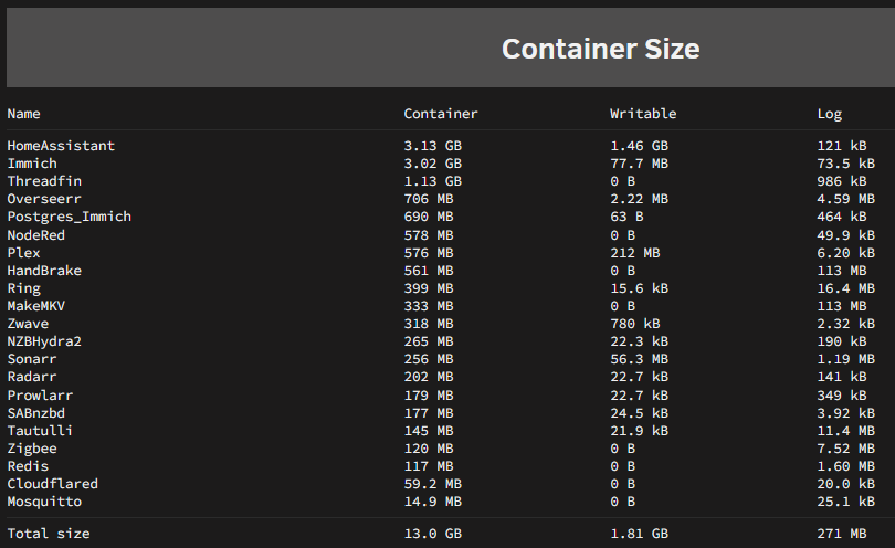

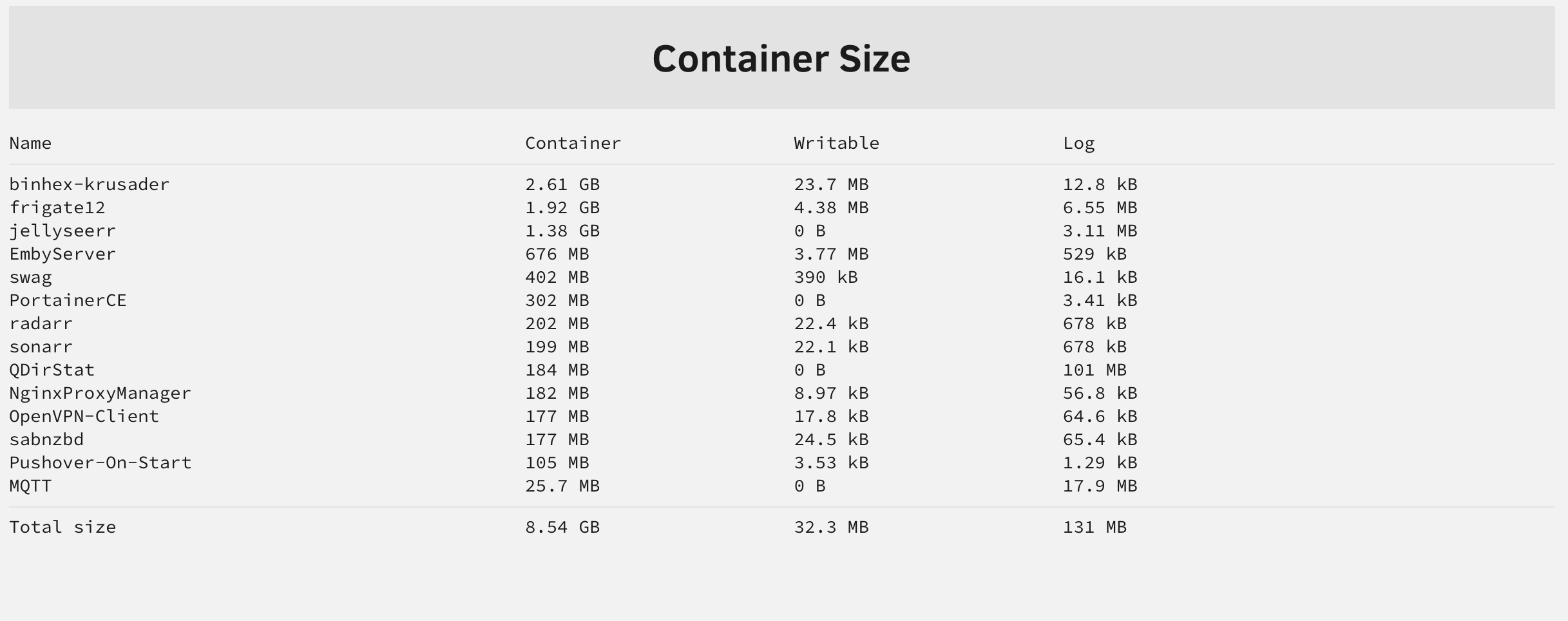

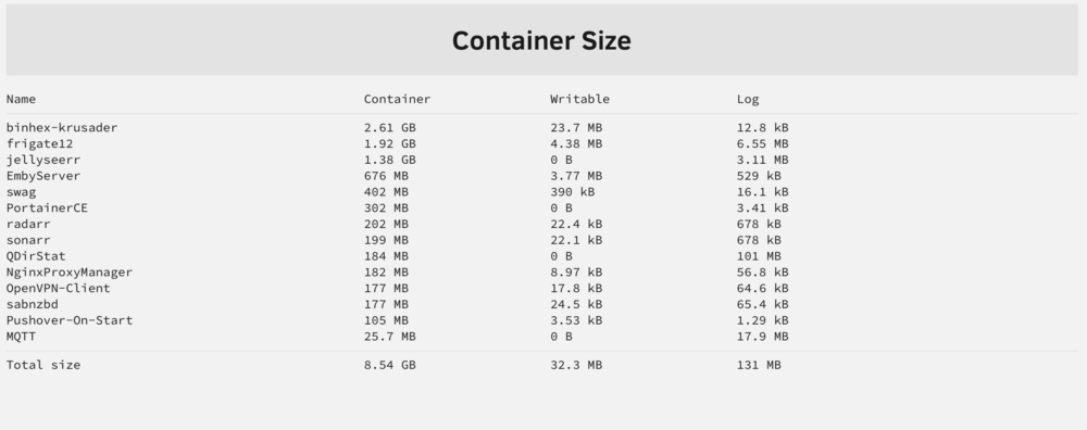

It is a little frustrating because the only evidence I have of the docker image filling up is this:
Nowhere else can I find evidence of what is going on and where.  I have done the following:
Check container size button - 8.54GB
Run the docker log size script - ~20MB
Run the Space Invader script - 10.29GB
Checked the /tmp and /dev/shm both inside the console for the docker and in general and see very low counts
Is there really no way to figure out where the files are that are causing that meter on the dashboard to report 85%. What does it represent?  It just went to 86%.

Was trying to see if there was a specific directory ballooning out of proportion but I don't see anything like that.
what does the container size button show on the docker containers page?
I also posted the NGINX Proxy Manager as I have suspicions that the issue is between Frigate and the reverse proxy.  Let me know if those numbers look ok.
Also, what line items specifically would I be looking at that are blowing up?  With docker container size around 9GB and image set at 25GB one assumes I am looking for something in the 10+GB range to achieve 80+%.  Thanks
8 minutes ago, The Transplant said:
It appears frigate is only using ~2GB of space. Are you 100% sure that your docker image isn't set to 10GB? because 86% of 10GB is 8.6GB which is how much space is currently being used.
Something isn't adding up here and nothing appears to be ballooning out of control from what I see here.
I did a test, I wrote a 10GB file inside one of my dockers to show you what it would look like:
So I should be seeing something in container size for one of my dockers?
I am almost 100% positive it is set to 25GB.  I don't know a way to figure out the size without shutting down and I want to leave it running a little longer in its blown up state to see what is going on.
The growth has slowed down significantly which points down to the external streaming of my cameras.  I shutdown all of the devices that were pulling camera feeds.
But still concerned that I can't see a smoking gun in terms of a file system that has gotten big.
Go to the settings page, click docker, you might have to enabled the advanced view. There should be a default size setting.
Alternatively you can see what the docker.img file's reported size is by checking the file from the webgui under your docker share.
I don't see it on the docker settings page.  I think you have to stop the docker service.  I do see this at the bottom but nothing here matches with what I would expect:
And this is what shows under the share:
Edited by The Transplant
