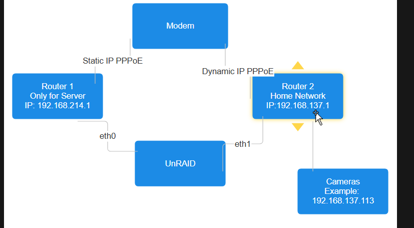

I'll read it in a bit and also here's the network layout, our ISP still Provides 7 Dynamic IP and 1 Static IP using PPPoE

Thank you for providing that layout. since you already have isolation and 2 separate routers. you may need to add a secondary docker network to assign eth1 to frigate to obtain a 192.168.137.x
I'm partial to maclvan.
Confirm and set unraid docker network settings.
*This will make the br0/bond0/eth0 network... To use the eth1 interface...
so lets make adocker network with terminal create commands:
macvlan example:
docker network create -d macvlan \
  --subnet=192.168.137.0/24 \
  --gateway=192.168.137.1 \
  -o parent=eth1 \
  mymacvlan
In this command:
-d macvlan specifies the driver.
--subnet defines the network range.
--gateway specifies the default gateway.
-o parent=eth1 sets eth1 as the parent interface.
Ipvlan example:
docker network create -d ipvlan \
  -o parent=eth1 \
  -o ipvlan_mode=l2 \
  myipvlan
-d ipvlan specifies the driver.
-o ipvlan_mode=l2 sets the mode to L2, which allows the containers to behave like they are on the same physical network segment.
Depending on if your using macvlan or ipvlan. I would recommend macvlan to get other networking required stuff such as each docker having its own unique mac address.
then you will see mymacvlan or myipvlan when you hit edit in the docker template as a drop down in the network option. this will tell frigate to use the docker network that you created (the docker network create comands survives reboots)... and when selected will use eth1 192.168.137.x for dockers networking.

Hmmmm But the Camera Network is only needed for the Frigate to access the Camera Feed over RTSP, data will never go out that connection.
Based on your network:
Router 2 has internet access via a dynamic IP. ? do you need 2 nics attached to frigate then?
Data from first post. You may need to add ip route to unraids netowrk gui, enabled ipv4 / ipv6 forwarding.
Edited by bmartino1
you may need to go docker compaose to beter handle network attacehd conatiner with 2 nics....
*I would go a LXC/VM at that point for more granulat controll over the networks in the system...
Step 1: Create the Docker Networks
Step 2 use docker compose
Example:

Things give the docker container 2 nics, the custom macvlan at a statric ip to talk to the cameras and uses the default unraid netwrok bridge for eth0 internet access.
if you already have friagte created. make a template change. then change it back and hit apply to get the docker run line and use https://www.composerize.com/
to make a docker compose file...
as any system ctl / ipvlan or other is all termanl cams wihtin the docker when having 2 nics... But I belve this is the outcome you want.
So Pretty much I'll need Frigate able to access the camera under home network while I'll access the site via Static IP.
Both of them have internet access but I'd prefer internet only go out and in from the Static IP one
Edited by LunarstarPony
I would still recomend a VM instance this way you have a bit more granular contorl over a sytem and have shell access to setup and use 2 nics:
