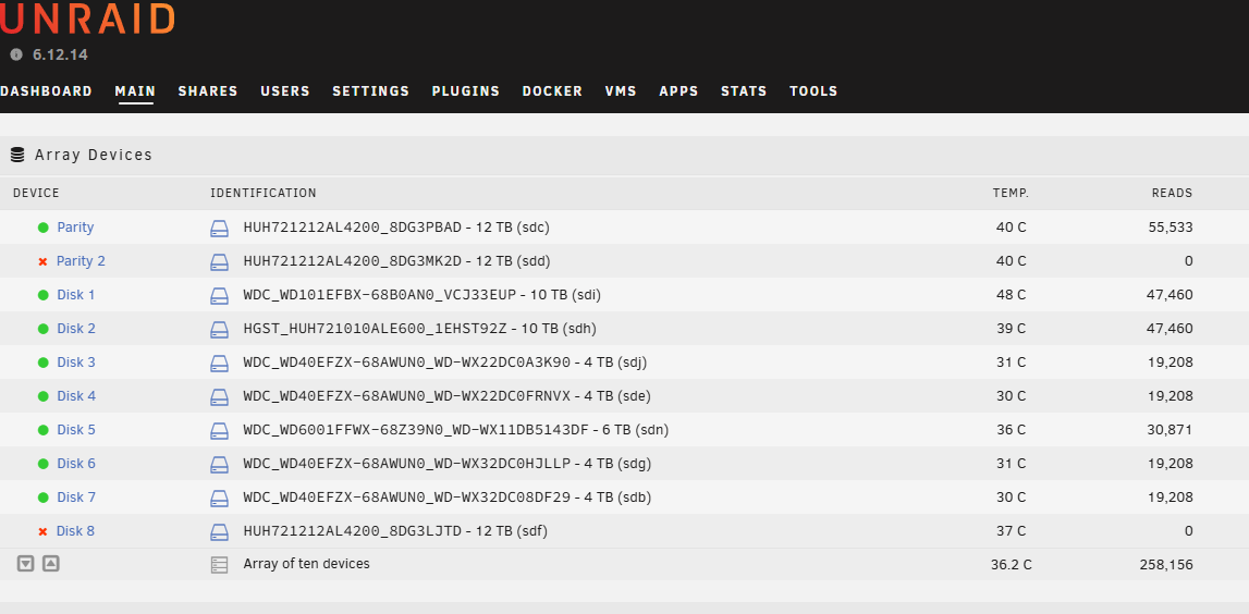

4 Days ago, I acquired 3 x HGST 12TB SAS drives and installed them into the array (cf Xeus Array.png). 2 were installed as new parity drives, and the other as Disk 8. I rebuilt parity first, then installed Disk 8 after pre-clearing. All was fine at this point.
I then moved all files from the 4TB disks in turn with Unbalance starting with Disk 7, the 6, 3 & 4 in turn respectively. All went fine until the final transfer of files from Disk 4 last night.
Midway through the process, I noted that Parity 2 & Disk 8 were disabled and that Disk 8 was being emulated. As there were only 3 or so hours to run til completion I let Unbalanced finish doing its thing. I do not know in which order the drives were disabled.

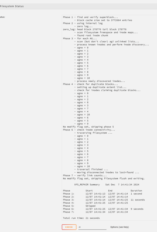

I then generated the diagnostics, SMART reports & screenshots attached which you will note include a File System check of Disk 8

I'm not sure what to do from here to resolve the issues. I'm hoping both SAS drives aren't toasted as I do not have spares to replace them at hand.

Looks more like a power/connection issue, check/replace cables and post new diags after array start.
