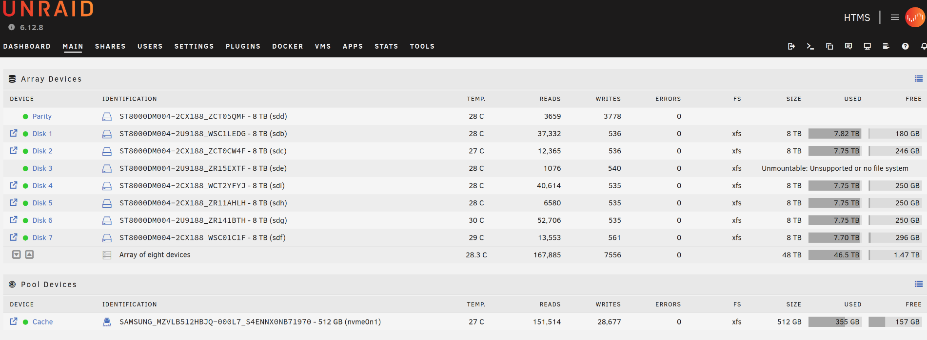

git a problem with one of my XFS Disks in unraid.
Suddenly i was not able to get onto the disk in terminal, it just was not there.
Restarted the array it was shows as unmountable, so i follow the Guide to repair the FS in the Wiki.
After restarting the array it showed up for a minute or so before the FS was show down again with that message: Corruption of in-memory data (0x8) detected at xfs_defer_finish_noroll
I have rebooted the server and checked the FS again, now it shows o whole bunch of errors:

What can i do now?
Is there any way to emulate the contents of the disk, it does not seem to be kicked out by unraid.
Edited by darkside40
1 hour ago, darkside40 said:
What can i do now?
Remove the -n from the command options and re-run
Any corruption would also be carried over to the parity system, so no.  But, in all cases of file system corruption its always a good idea to run memtest from the boot menu, as bad RAM is.a leading cause of corruption.
When i remove the disk physically, it seems to get emulate 😳
And isn't it still unmountable?
