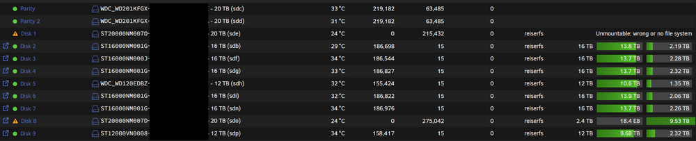

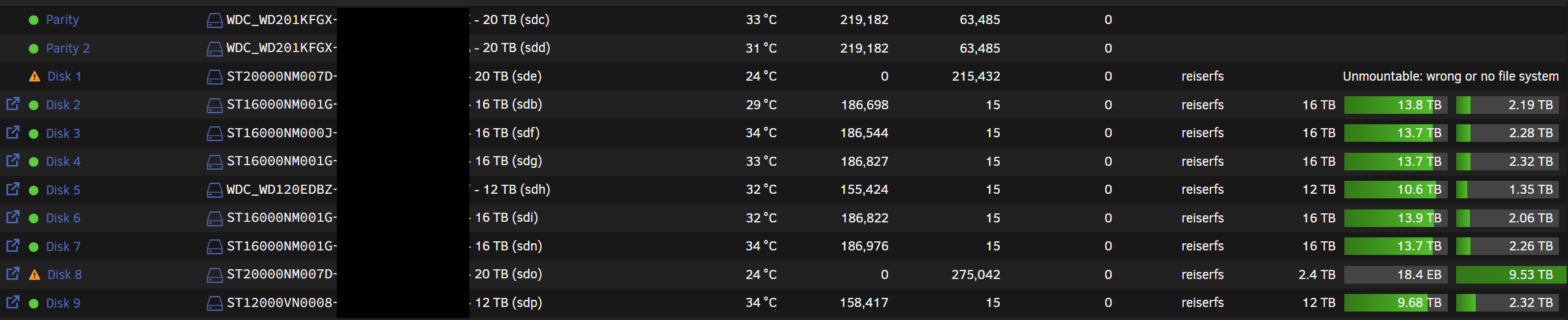

New drives came today. Trying to replace bad drive disk 1 (removed couple days ago) and replace/upgrade good drive disk 8. Dual parity so it should be okay, right? I am getting an error on drive 1 "Unmountable: wrong or no file system" but it appears to be participating in the data rebuild (drive writes incrementing). Drive 8 is also participating but is showing the weird capacity values like drive 1 did before (see previous post) Size: 2.4TB, Used: 18.4EB, Free 9.53TB (this looks right, it was a 12 now being replaced with a 20).
I just started the data rebuild. What's going on here? (ps pic is just first 9 disks)

Just noticed the Format option is showing for Disk 1. Should I stop and do that or will the rebuild take care of it?Screenshot_2.thumb.png.8326c3c4c5645b192031f11f026b7c8a.png

Reiserfs doesn't support partitions over 16TIB, also it's been recently removed from the Linux kernel, so it will stop being supported by Unraid in the near future, assuming you still have old diosk1 intact, it can be a good opportunity to start converting them to xfs.
Thanks Jorge. That explains a lot. Have stopped the rebuild and will put D1 & D8 originals back in and go from there. The purpose of the new drives was to make space to start the conversion process for the 11 reiserfs drives I have (ugh). I was able to upgrade D18 to 20TB as it was already XFS. That will have to be enough to get started.
