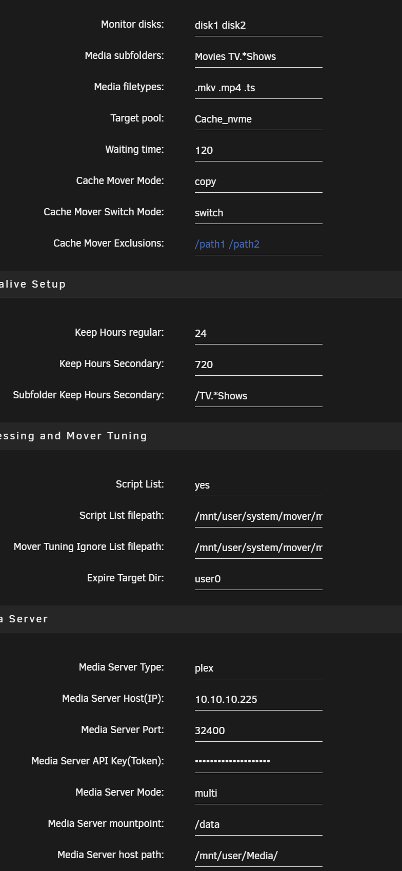

Alturismo,
I am getting error when the mover is trying to move files to the cache. It detects the files that are running in Plex without any issues. When it tries to copy the file to the cache it errors out.
The first error that I notices is no space left on device. The cache has 1.5 TB of free space.
The second error is that it can not find the mover_excl.txt. Not sure about that one.
The third error is parse error: Invalid numeric literal at line 1, column 60.
Below is a copy of the log when it is trying to move the file/s to the cache. I also attached a screenshot of the settings in case that helps.
Thanks in advance for any help you can provide.

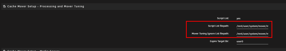

7 hours ago, KillerHacker said:
write failed on "/mnt/Cache_nvme/Media/TV Shows/Thunderbirds/Season 1/Thunderbirds - S01E26 - Security Hazard Bluray-720p.mkv": No space left on device
may i ask (just to make sure)
when you do a
ls -la /mnt/
is Cache... really uppercase or may lowercase ?
cannot open file `/mnt/user/system/mover/mover_excl.txt' for reading: No such file or directory
thats the path you can configure yourself, i assume you dont have a folder "mover" on your system Share, so may either
1/ just make a folder there (Rest should be done by cache mover)
2/ point to a place and filename you like
its mandatory for post processing !!!
I created the mover folder like you said and that resolved the mover_excl error. Thanks

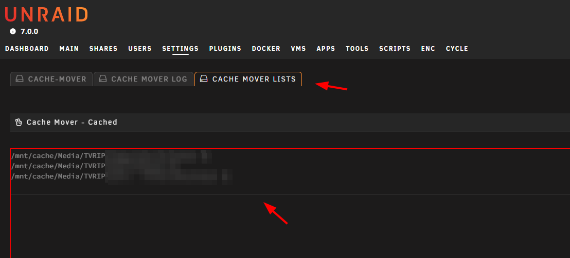

Correct, it is showing up at after the gdb process. Below are some examples of the error:
Jan 14 00:59:41 Server root: cache-mover: (gdb) update access time: /mnt/cache_nvme/Media/TV Shows/Thunderbirds/Season 1
Jan 14 00:59:42 Server root: cache-mover: parse error: Invalid numeric literal at line 1, column 60
Jan 14 01:17:12 Server root: cache-mover: (gdb) Detaching from program: /usr/libexec/unraid/shfs, process 15492
Jan 14 01:17:12 Server root: cache-mover: [Inferior 1 (process 15492) detached]
Jan 14 01:17:13 Server root: cache-mover: (gdb) update access time: /mnt/cache_nvme/Media/Movies/Kaskasero (2024)
Jan 14 01:17:14 Server root: cache-mover: parse error: Invalid numeric literal at line 1, column 60
Yes, the cache Mover Lists are popululating as expected.

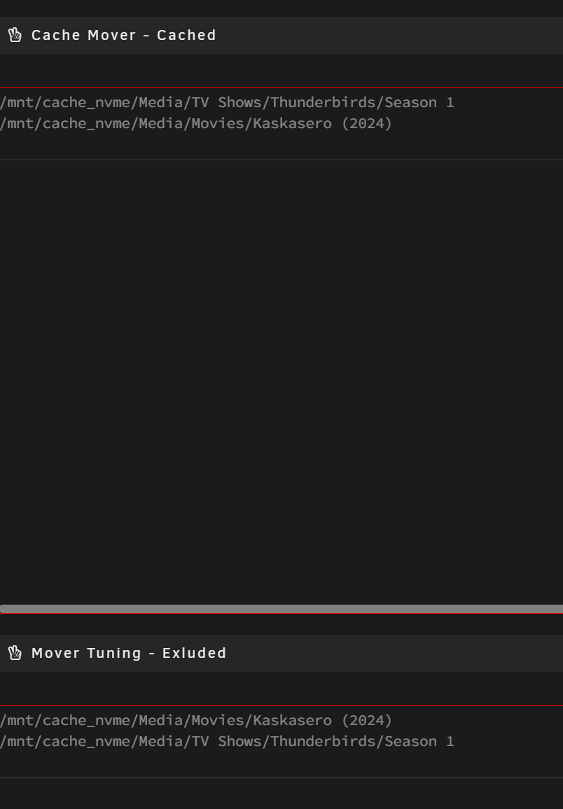

1 hour ago, mmm77 said:
Hi
For me regular mode works....
Tried to use  "only" mode and set up Plex...
I also only get this error during playback.
Thanks for the feedback, I ll take a look later.

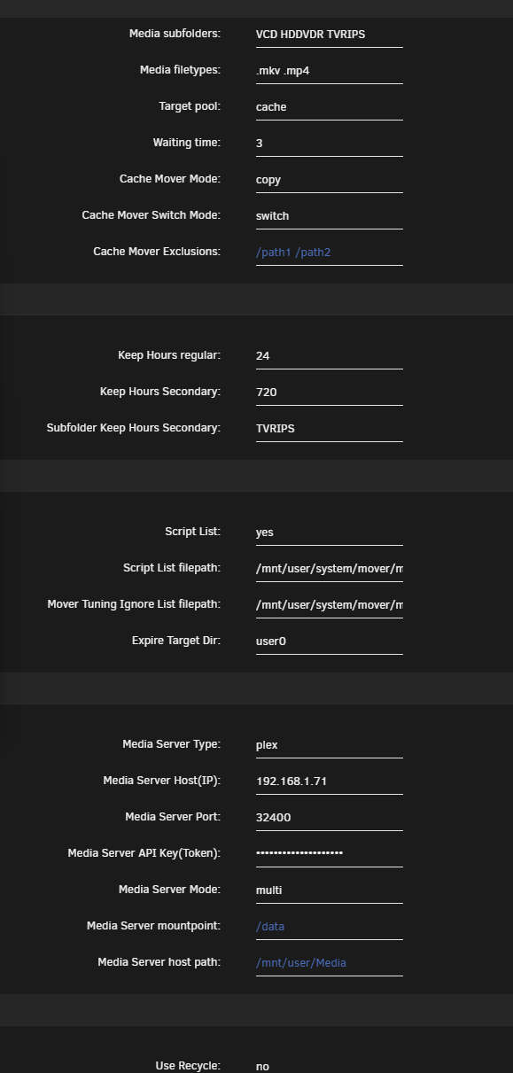

5 hours ago, mmm77 said:
switching back to "regular" during playback:
could you may post your setup page here ... i cant reproduce it here with any mode, only, multi, off ...
Jan 15 18:21:25 AlsServerII root: cache-mover: update access time: /mnt/cache/Media/TVRIPS/Supernatural/Season 08
Jan 15 18:22:03 AlsServerII root: cache-mover: update access time: /mnt/cache/Media/TVRIPS/Supernatural/Season 08
Jan 15 18:22:14 AlsServerII root: cache-mover: update access time: /mnt/cache/Media/TVRIPS/Supernatural/Season 08
Jan 15 18:22:43 AlsServerII root: cache-mover: update access time: /mnt/cache/Media/TVRIPS/Supernatural/Season 08
Jan 15 18:22:48 AlsServerII root: cache-mover: update access time: /mnt/cache/Media/TVRIPS/Supernatural/Season 08
Jan 15 18:22:57 AlsServerII root: cache-mover: update access time: /mnt/cache/Media/TVRIPS/Supernatural/Season 08
Jan 15 18:23:01 AlsServerII root: cache-mover: update access time: /mnt/cache/Media/TVRIPS/Supernatural/Season 08
Jan 15 18:23:08 AlsServerII root: cache-mover: update access time: /mnt/cache/Media/TVRIPS/Supernatural/Season 08
Jan 15 18:23:12 AlsServerII root: cache-mover: update access time: /mnt/cache/Media/TVRIPS/Supernatural/Season 08
Jan 15 18:25:17 AlsServerII root: cache-mover: update access time: /mnt/cache/Media/HDDVDR/The Last Boy Scout (1991)
Jan 15 18:25:21 AlsServerII root: cache-mover: update access time: /mnt/cache/Media/HDDVDR/The Last Boy Scout (1991)
Jan 15 18:25:25 AlsServerII root: cache-mover: update access time: /mnt/cache/Media/HDDVDR/The Last Boy Scout (1991)
Jan 15 18:25:30 AlsServerII root: cache-mover: update access time: /mnt/cache/Media/HDDVDR/The Last Boy Scout (1991)
Jan 15 18:25:57 AlsServerII root: cache-mover: update access time: /mnt/cache/Media/TVRIPS/Buffy/Season 02
Jan 15 18:26:02 AlsServerII root: cache-mover: update access time: /mnt/cache/Media/TVRIPS/Buffy/Season 02
Jan 15 18:26:25 AlsServerII root: cache-mover: update access time: /mnt/cache/Media/TVRIPS/Buffy/Season 02
Jan 15 18:26:31 AlsServerII root: cache-mover: update access time: /mnt/cache/Media/TVRIPS/Buffy/Season 02
thanks ahead
