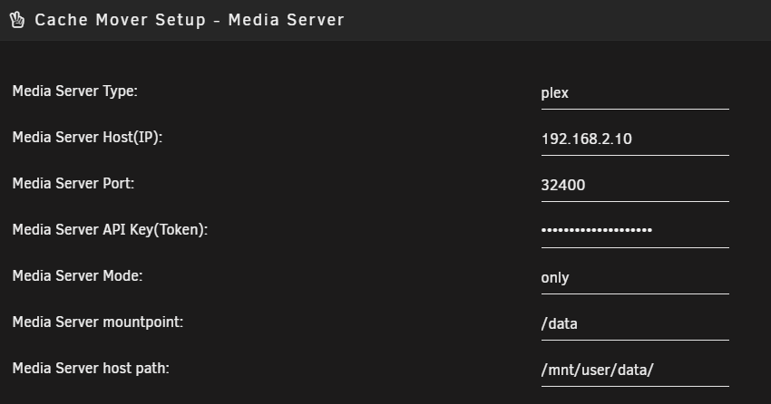

13 hours ago, alturismo said:
could you may post your setup page here ... i cant reproduce it here with any mode, only, multi, off ...
Jan 15 18:21:25 AlsServerII root: cache-mover: update access time: /mnt/cache/Media/TVRIPS/Supernatural/Season 08
Jan 15 18:22:03 AlsServerII root: cache-mover: update access time: /mnt/cache/Media/TVRIPS/Supernatural/Season 08
Jan 15 18:22:14 AlsServerII root: cache-mover: update access time: /mnt/cache/Media/TVRIPS/Supernatural/Season 08
Jan 15 18:22:43 AlsServerII root: cache-mover: update access time: /mnt/cache/Media/TVRIPS/Supernatural/Season 08
Jan 15 18:22:48 AlsServerII root: cache-mover: update access time: /mnt/cache/Media/TVRIPS/Supernatural/Season 08
Jan 15 18:22:57 AlsServerII root: cache-mover: update access time: /mnt/cache/Media/TVRIPS/Supernatural/Season 08
Jan 15 18:23:01 AlsServerII root: cache-mover: update access time: /mnt/cache/Media/TVRIPS/Supernatural/Season 08
Jan 15 18:23:08 AlsServerII root: cache-mover: update access time: /mnt/cache/Media/TVRIPS/Supernatural/Season 08
Jan 15 18:23:12 AlsServerII root: cache-mover: update access time: /mnt/cache/Media/TVRIPS/Supernatural/Season 08
Jan 15 18:25:17 AlsServerII root: cache-mover: update access time: /mnt/cache/Media/HDDVDR/The Last Boy Scout (1991)
Jan 15 18:25:21 AlsServerII root: cache-mover: update access time: /mnt/cache/Media/HDDVDR/The Last Boy Scout (1991)
Jan 15 18:25:25 AlsServerII root: cache-mover: update access time: /mnt/cache/Media/HDDVDR/The Last Boy Scout (1991)
Jan 15 18:25:30 AlsServerII root: cache-mover: update access time: /mnt/cache/Media/HDDVDR/The Last Boy Scout (1991)
Jan 15 18:25:57 AlsServerII root: cache-mover: update access time: /mnt/cache/Media/TVRIPS/Buffy/Season 02
Jan 15 18:26:02 AlsServerII root: cache-mover: update access time: /mnt/cache/Media/TVRIPS/Buffy/Season 02
Jan 15 18:26:25 AlsServerII root: cache-mover: update access time: /mnt/cache/Media/TVRIPS/Buffy/Season 02
Jan 15 18:26:31 AlsServerII root: cache-mover: update access time: /mnt/cache/Media/TVRIPS/Buffy/Season 02
thanks ahead
yes sure, when I change to "empty"  (regular mode) it works.
That's my docker setup for plex:
Cache Mover Setup:
grafik.thumb.png.047560858da5dea83eba8dfb345706db.pnggrafik.thumb.png.9deef67333f4831f02f1c8bc7e58ffd5.png

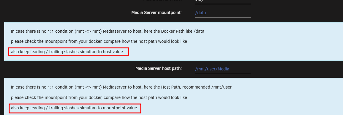

I have the same issue with the "Invalid numeric literal at line 1, column 60" spam after enableing the server option with plex.
Config look likes this:
root@Lisa-System:~# jq --version
jq-1.6
Im still on unraid 6.1.2.14
may please correct the trailing slashes
either change
Plex Path: /data >> /data/
or
Host Path: /mnt/user/data/ >> /mnt/user/data
jq-1.6
thanks for the feedback
still couldnt reproduce this error message for a quick fix for this message, but im on a rewrite anyway already
may as note, plex users usually dont need this option as plex should work anyway, only nice if you dont want other file access (smb, whatever, ...) completely exclude this plugin ...
so @flash2000 just to make sure, ONLY occuring with plex mode set, not before (regular mode), correct ?
either change
or
Thanks for the correction of the fille path. i guess my poor skills of english are challenging sometimes :)
Yes, if i use the option "only" then the issue occures. In regular mode i do not have this issue :)

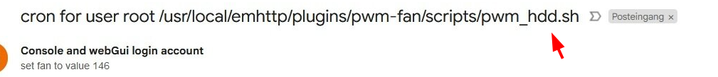

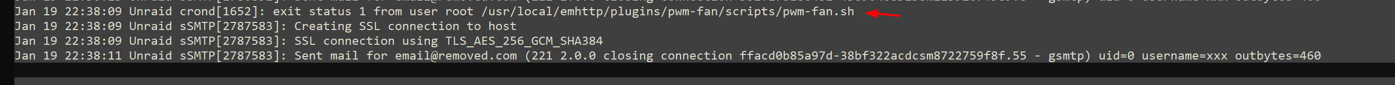

I have the same issue with the PWM Fan plugin. It is sending email any minute after the configuration.
thanks for the diags
may ahead, the pwm plugin does not have any email notification buildin ... but i see now there is an exit called and you may have some warning email notifications enabled ...
i assume now you have aggressive mode enabled, i can now look into it and will report back.

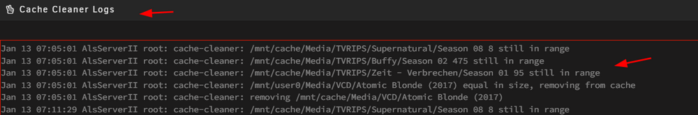

2 hours ago, Gursh said:
I was just wondering how the app moves files/del files when it has been watched…

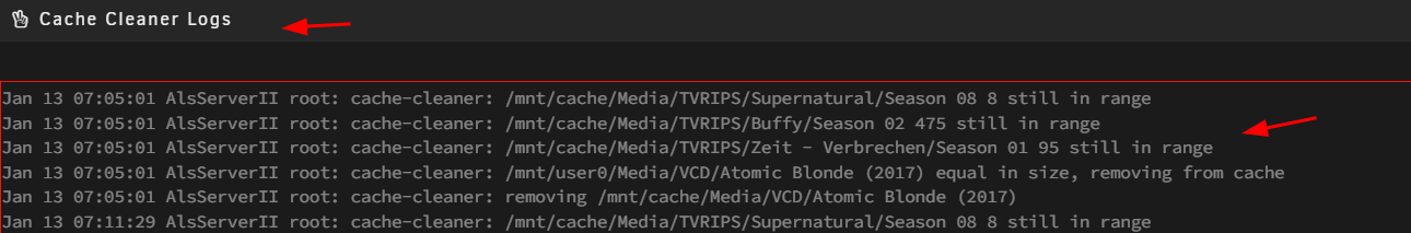

may a screen from your cache mover settings page which handles file delete by itself.
you can follow the state on the cache mover settings page, tag CACHE MOVER LOG
still in range would mean its not ready to be deleted as last access was inside the keep hours.
i assume there is something not properly configured.

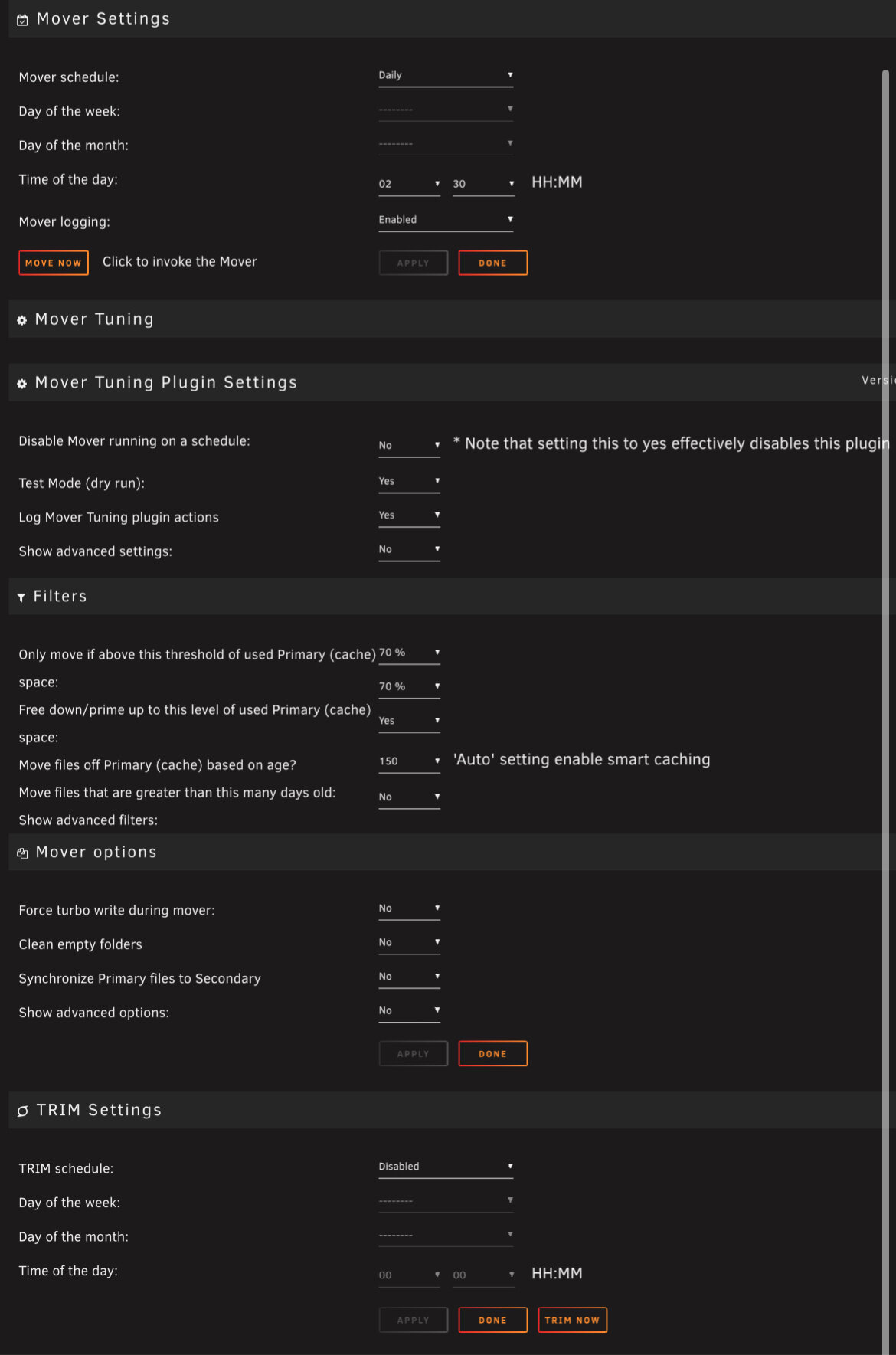

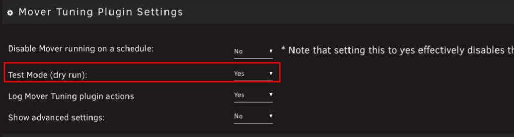

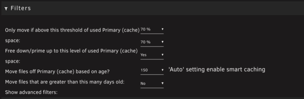

may as note, your mover tuning setup is not really ...
70 / 70 setup means
upper 70 free to lower 70, sample
71% filled will clean to 69 and then stop ... rather take something like 70 / 50 ... so 20+ % gets moved
age 150 ... means files needs to be at least 150 days old (5 month on cache only ...)
and so on ... may take a look there too ;)
but cached files from this plugin will be removed anyway by the plugin itself

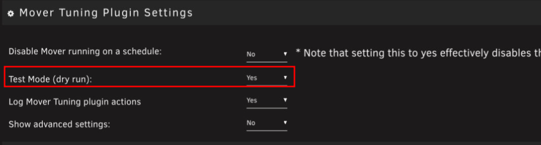

finally your mover tuning setup
dry run ... means mover will never really move, just showoff what could happen ;)

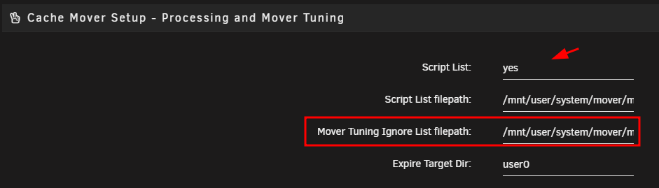

as mentioned, not related now about cached files deletion, only relationship between mover tuning and cache mover is
mover tuning setup, exclusions should be enabled and point to the same file
like in cache mover filepath
those have to match ...
could reproduce it now
i ll look into it for a fix, for now rather disable the aggressiv function and let it adjust every minute
the mail is coming from unraid's crond in combination with my aggressiv policy ...
update pushed, cant tell when its on CA 20250120, shoul dbe fixed now
Update is installed, but the error persists.
The SMTP data is entered in the notification settings but no emails are activated. Just the notifications via Gotify
unraid-diagnostics-20250120-1713.zip
Edited by Viper020GER

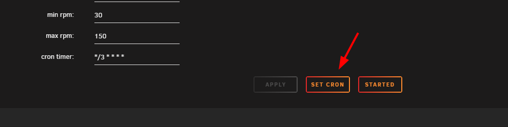

could you may please post a screen from your pwm settings page ?
what do you mean with disable the aggressiv function?
that was before i fixed the CPU fan emaii messages ...
i pushed a small update, may give a try and check AFTER you clicked set cron again
should look something like this then
root@AlsServerII:/usr/local/emhttp/plugins/pwm-fan/scripts# crontab -l
# Cron Job for HDD pwm-fan plugin
*/3 * * * * /usr/local/emhttp/plugins/pwm-fan/scripts/pwm_hdd.sh >/dev/null 2>&1
thanks ahead for looking (i dont get any errors on HDD fan here, CPU i could reproduce ...)
Update installed, cron job reset but emails continue to be sent
unbelievable ...
could you may look at
crontab -l
 if the change took effect
should look like this
and may run from terminal
if there are any errors coming up ...
this part ">/dev/null 2>&1" is missing by me
