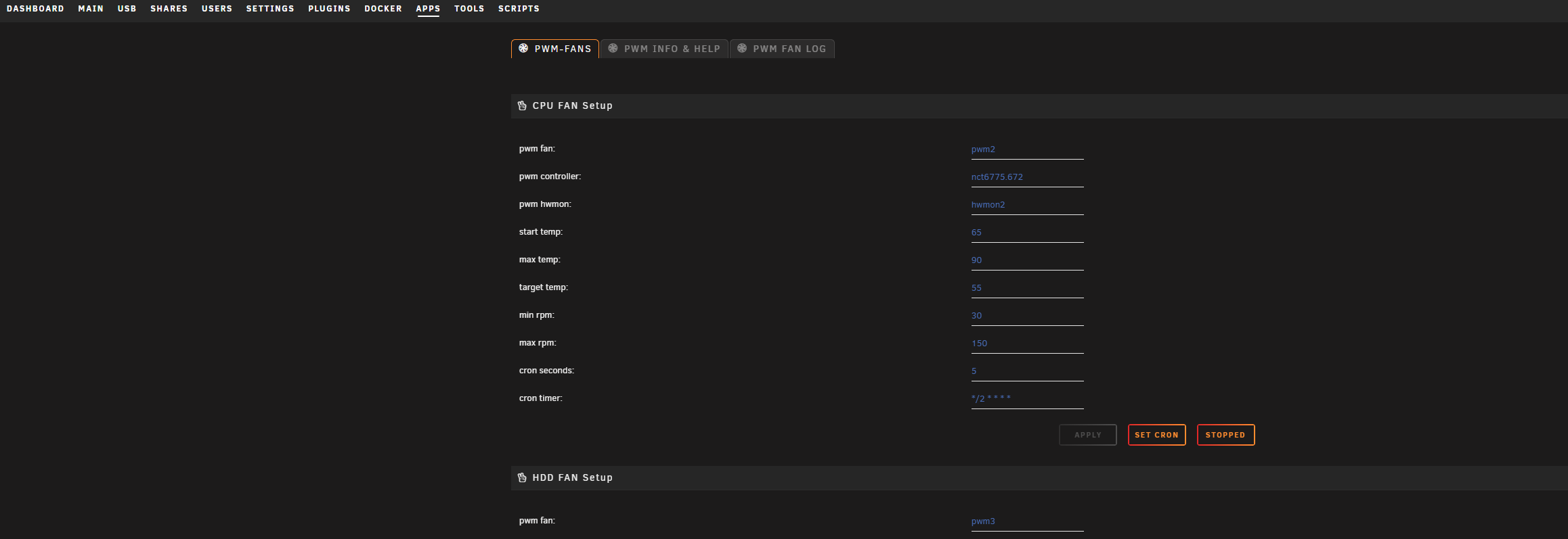

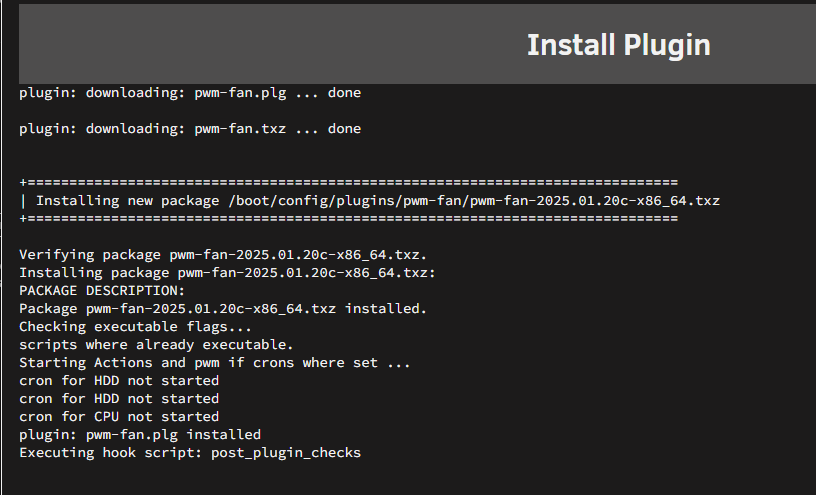

reinstall without reboot doen´t work

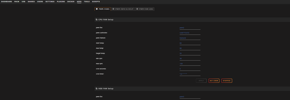

after the reinstall the setting page is empty
i assume you mean the Info & help page or really the settings page ?
i mean the settings page in the pwn-plugin
apps/pwn-fan/actions/settings
and under User Utilities it is missing
then there is something wrong ...
just made a cross check here on another test sys, uninstall, fresh install
and i see on your screen
may uninstall, remove plg and everything from /boot/config/plugins/ ... seems something is somehow broke

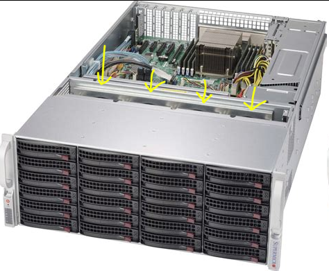

For the pwm-fan plugin, is there a way that I can add additional extra HDD configs? The chassis that I am using has 4 fans that cool an independent set of HDD's. Right now I can set the first & second columns of drives as one group, and the third and forth columns as a secondary group, but I would prefer to have each column to adjust the fan speed independently.
I've included photos of the chassis to help clarify how its setup (yellow arrows point to the fan's).
clear understood, but actually no intention to extend ... already extended once ;)
there is the autofan plugin if you want to controll all individually, may the better choice in your case for now.
never say never, but currently no priority here ... its on a feature list actually but cant tell when ...

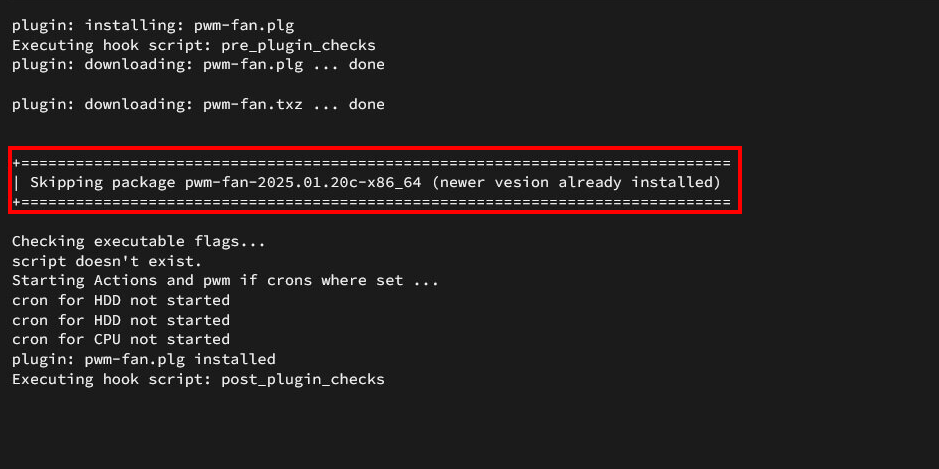

could reproduce this now too on v7, will inform later
must been some git hickup, just changed the version tag and now it installs properly again ...
all plugins updated with that cron issue ...
i wasnt aware that Unraid had some buildin "feature" to send Mails anyhow if there is a cron triggered ...
nevertheless you want Email messages or not ... and doesnt care if the plugin want to send messages or not ...
sorry guys, will be supressed now (at least it should be ...)
special Thanks @Viper020GER for pushing me to look deeper ;)

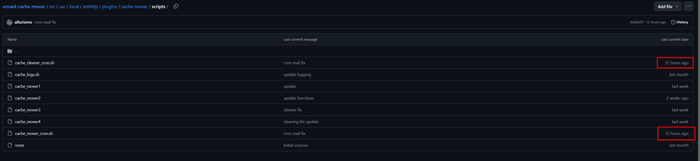

Hi, was there an update to Cache Mover relating to file paths? It's not working now. I just updated to 2025.01.21, still does not work. It was working correctly last weekend.
Jan 21 22:46:02 Vault root: cache-mover: move / copy /mnt/user0/media/library//movies/Star Trek First Contact (1996) 0/ to /mnt/cache_media/media/library//movies/Star Trek First Contact (1996) 0/
Jan 21 22:46:02 Vault root: cache-mover: sending incremental file list
Jan 21 22:46:02 Vault root: cache-mover: rsync: [sender] change_dir "/mnt/user0/media/library//movies/Star Trek First Contact (1996) 0" failed: No such file or directory (2)
Jan 21 22:46:02 Vault root: cache-mover: sent 19 bytes  received 12 bytes  62.00 bytes/sec
Jan 21 22:46:02 Vault root: cache-mover: total size is 0  speedup is 0.00
Jan 21 22:46:02 Vault root: cache-mover: rsync error: some files/attrs were not transferred (see previous errors) (code 23) at main.c(1338) [sender=3.3.0]
Jan 21 22:46:02 Vault root: cache-mover: grep: Invalid range end
this is the folder path for the movie:
/mnt/user/media/library/movies/Star Trek First Contact (1996) [imdbid-tt0117731]
a folder on the cache_media pool is created, but it's not correct:
/mnt/user/media/library/movies/Star Trek First Contact (1996) 0
actually not
but im aware that brackets can cause issues and im rewriting currently some parts ... also to look for it ...
but actually in my point of view, brackets in filenames ... post processing in other apps can cause issues ...
but yes, on my todo list, but i wont invest endless time therefore ... in my personal opinion, its a failed naming schema, i followed all Plex rules actually and there are no brackets ;) but im aware other "sideapps" are including imdb in brackets ...

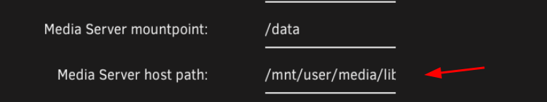

11 minutes ago, jleach said:
Thanks, hope this helps!
and may as note, im pretty sure your rewrite rule is not correct
i guess there is a tralling slash on your Media Server Host Path
3 minutes ago, alturismo said:
actually not
understood - thank you. Odd it was working exactly as intended last weekend though. I did testing with you on January 13 related and my logs all have movies with bracketed names. I have not changed any Cache Mover settings since then. See attached image.
Correct, there was a trailing slash, I just removed it and applied change. But again, it was like that last weekend, too.

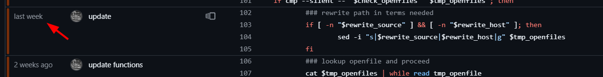

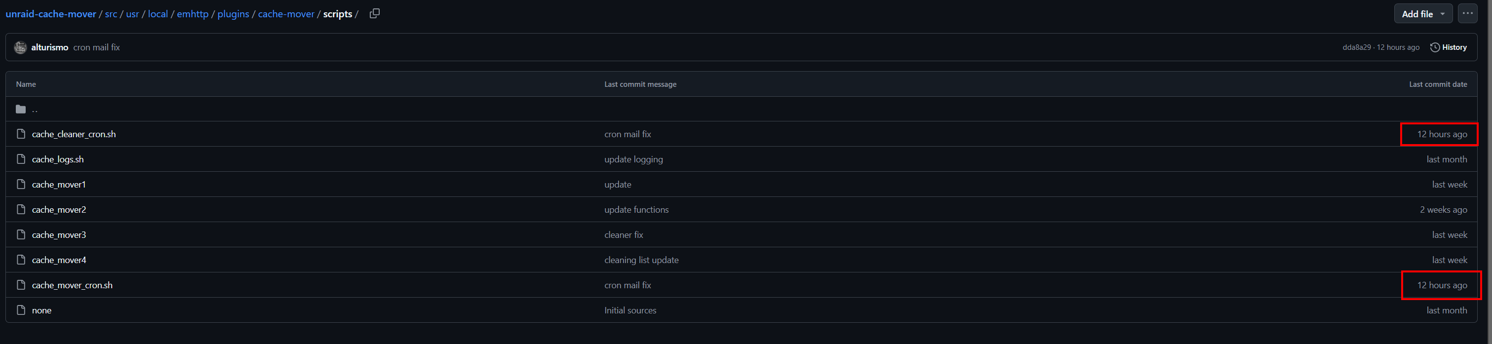

i believe so ... i know alot using brackets (meanwhile im aware of that ...) and there was a fix for brackets in the exclusion lists ...
but the core didnt change (yet), last change was rewrite addition ...
you can check yourself on git ;)
the last update for now was just a quick fix to solve Email spam on cron triggers, see some posts above, came up related to pwm fan ... but i added this to all my plugins as i wasnt aware that a cron triggers always a mail (if mail address was setted up)
so only the 2 cron setup procedures where changed ...
so for now, cant tell what should have changed ... but there is a rewrite "work in progress" and im also looking forward ...
but as mentioned, brackets are "command" characters ... so really a bad idea in terms of coding and escaping ... ;)
