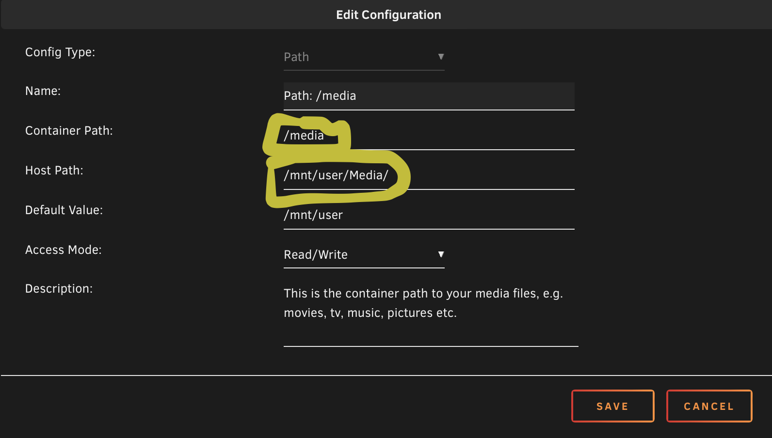

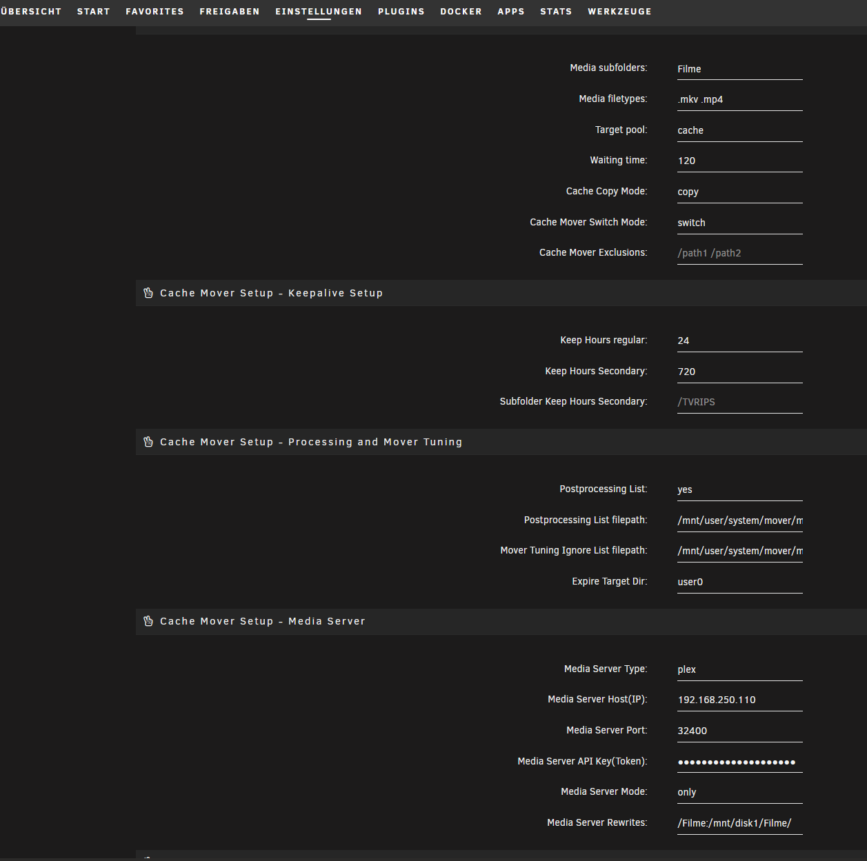

45 minutes ago, Gursh said:
for the Plex section is it supposed to be these two here?
IF you are using the mediaserver Option (this is a optional feature), then those 2 should be setup in the rewrite parts ... as there is no 1:1 relationship /mnt/user/... but while we on there, please also read the help sections for each setting,
/media
/mnt/user/Media << WITHOUT the trailing slash like described ;)
as Plex user you dont actually need the Mediaserver setting ... when does it makes sense
1/ you want ONLY to cache files which are used by your MediaServer
2/ you are a Jellyfin (sometimes also Emby) user which behaves different on regular file access ...
3/ if you often balance your Shares (move files from disk1 > disk2 as sample manually)
these scenarios are cases when ... thats why there is also the multi Option, cause if you want also VLC smb caching ... and using Jelly or Emby as Mediaserver ... then Multi makes sense, so all is covered.

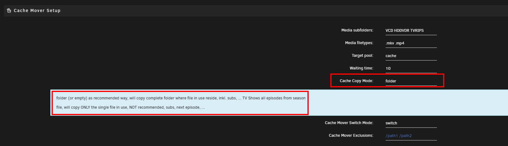

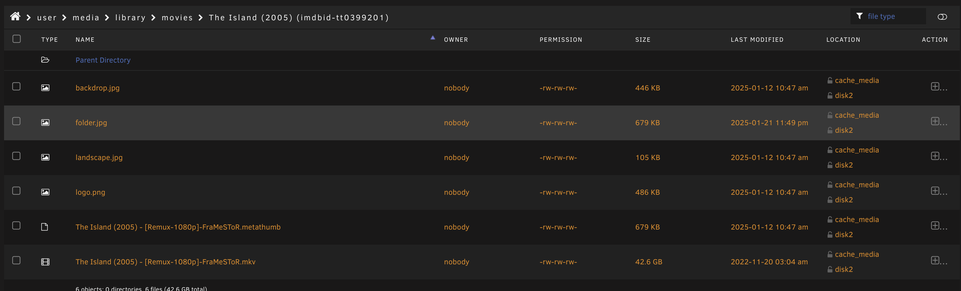

4 hours ago, jleach said:
Two odd things are now happening. Cache Mover is moving the entire movie directory including any meta files poster images. Also, even with "switch" used instead of "close,"
g morning,  yes, thats  intended to ... makes no sense to keep subs as sample on hdd while running the movie, the show ... would always end up in spinups ... but, new version (currently here in beta) has the option to "file only"
next update will include this but will be a "not recommended" feature as described ...
also "binge" watching a TV Show, regular it ll copy the whole season folder, file mode will only copy the 1 episode, so next episode will then again call the hdd 1st ... just as note before.
btw, you should use copy mode, not move mode, will be removed in future releses ... so the copy will be removed then anyway after watched and keep hours is done.
looks like you already using it, just to make sure ...
the "mode" switch or close has nothing todo with the file transfers ... its whats happening afterwards ...
close > kill the running file access to hdd, your playback on client will freeze ... you need to stop / start to have the benefit to use the cache (pool) file instead array (disk), while switch mode will do it "live" and you have no interruption.

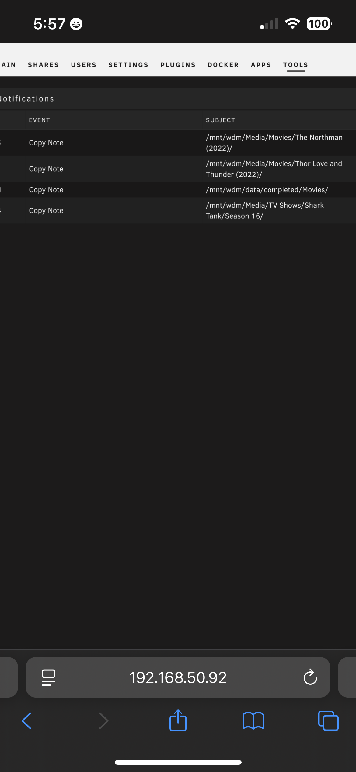

Thanks for the support on the lease question. I noticed all of sudden my radarr doesn’t have access to move. I also noticed the movies filter from the downloader is in the list of cache and ignor. If I take it manually would that help? Now sure how it got there.IMG_2154.thumb.png.3035d835cbd8e967ecdd9741326b9564.png
well ... if your ARR Apps are reading files from array (i never will understand why ARR should run on array) and you did use multi function or regular only instead mediaserver only ... you have multiply choices ...
in the end its like read from disks (no media playback), then turn it off while using or use mediaserver option only ...
or, use the exclusion function therefore (extra builded in therefore ...)
so like /completed ... would exclude this subdir from running anything ...
or adjust your cron times while you have your ARR tasks running
i cant imagine what else would be needed to not collide with ARR, encoding, ... apps ?
if you have a recent scenario, let me know ;) feedback always welcome, but may please check the existing buildin functions.

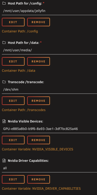

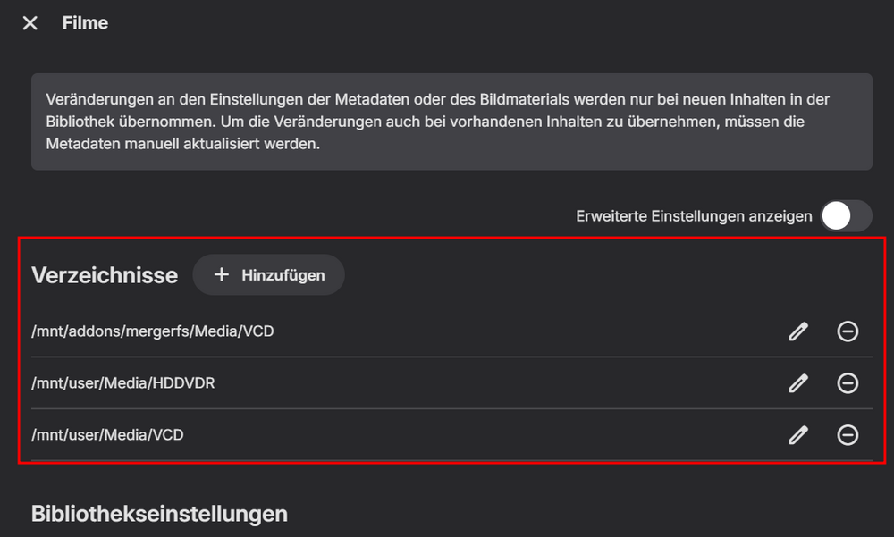

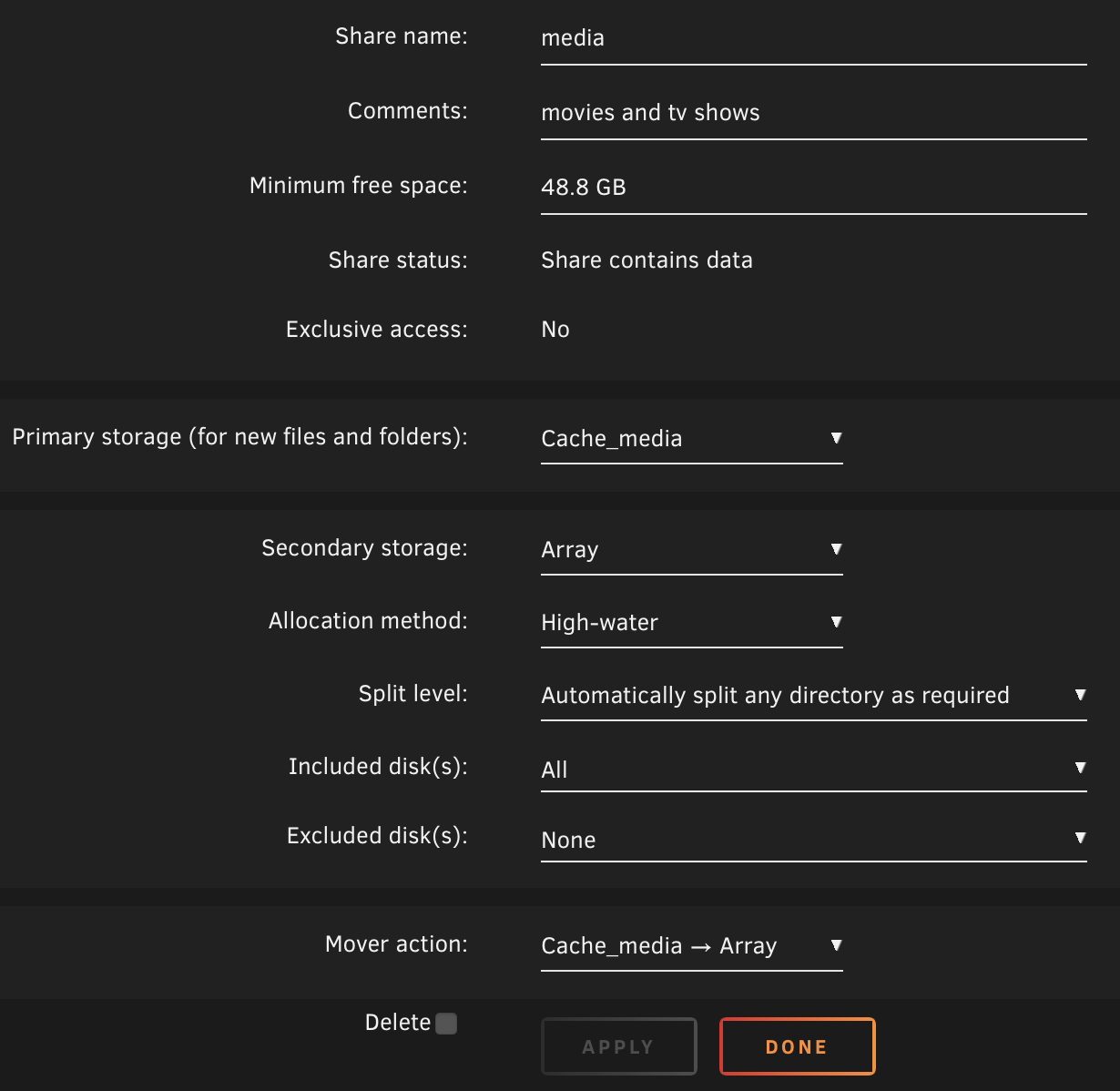

On 1/22/2025 at 10:40 PM, alturismo said:
so, please check
1/ is your Share which Jelly access also /mnt/user/... with a cache > array setup on Unraid
2/ is jelly setup to use /mnt/user/... and not /mnt/cache + /mnt/disk1 + /mnt/disk2 + ....
may a screen from your cache mover setup page with non working jelly ... also Share setting and jelly library path setting

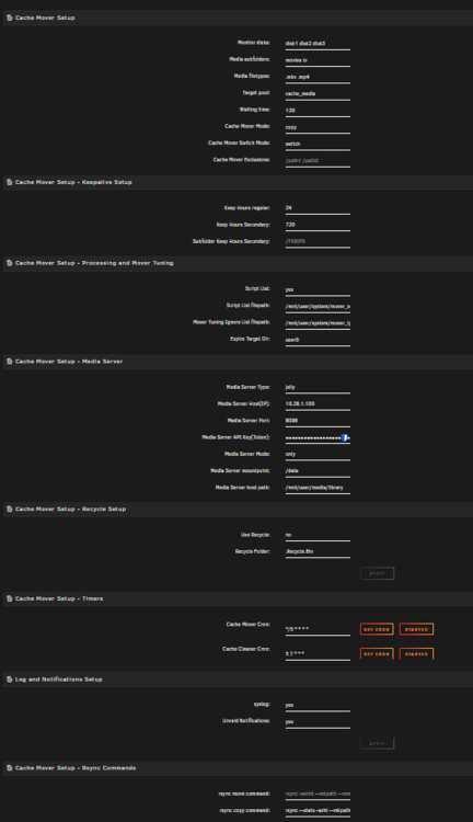

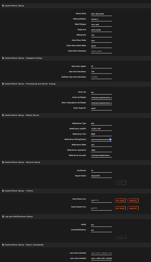

Yes, I believe I have all the Cache Mover settings correct. See image.
Here's my Jellyfin docker volumes:
/data <--> /mnt/user/media/library
/config <--> /mnt/user/appdata/jellyfin
Cache Mover copies the movie file to cache_media, but Jellyfin does not "switch" to the pool, instead it continues to read from the array.

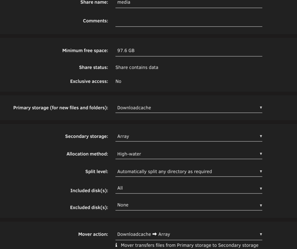

ok, how do you check this ? can you provide the cache mover log from a non working switch after copy ?
also, may a screen from your library setup pathes and Share settings for /media, thanks ahead
the way I checked it was to view the Main page, watching the array disk with the original copy continue to be read every few seconds. I confirmed this with the Open Files plugin showing that Jellyfin continued to use the file on disk2 instead of the newly created copy on cache_media
Jan 26 20:57:02 Vault root: cache-mover: move / copy /mnt/user0/media/library/movies/The Dark Knight (2008) (imdbid-tt0468569)/ to /mnt/cache_media/media/library/movies/The Dark Knight (2008) (imdbid-tt0468569)/
Jan 26 20:58:16 Vault root: cache-mover:
Jan 26 20:58:16 Vault root: cache-mover: Number of files: 3 (reg: 2, dir: 1)
Jan 26 20:58:16 Vault root: cache-mover: Number of created files: 2 (reg: 2)
Jan 26 20:58:16 Vault root: cache-mover: Number of deleted files: 0
Jan 26 20:58:16 Vault root: cache-mover: Number of regular files transferred: 2
Jan 26 20:58:16 Vault root: cache-mover: Total file size: 18.90G bytes
Jan 26 20:58:16 Vault root: cache-mover: Total transferred file size: 18.90G bytes
Jan 26 20:58:16 Vault root: cache-mover: Literal data: 18.90G bytes
Jan 26 20:58:16 Vault root: cache-mover: Matched data: 0 bytes
Jan 26 20:58:16 Vault root: cache-mover: File list size: 0
Jan 26 20:58:16 Vault root: cache-mover: File list generation time: 0.001 seconds
Jan 26 20:58:16 Vault root: cache-mover: File list transfer time: 0.000 seconds
Jan 26 20:58:16 Vault root: cache-mover: Total bytes sent: 18.90G
Jan 26 20:58:16 Vault root: cache-mover: Total bytes received: 57
Jan 26 20:58:16 Vault root: cache-mover: sent 18.90G bytes  received 57 bytes  253.73M bytes/sec
Jan 26 20:58:16 Vault root: cache-mover: total size is 18.90G  speedup is 1.00
Jan 26 20:58:16 Vault root: cache-mover: grep: Invalid range end
Jan 26 20:58:16 Vault root: cache-mover: update access time: /mnt/cache_media/media/library/movies/The Dark Knight (2008) (imdbid-tt0468569)

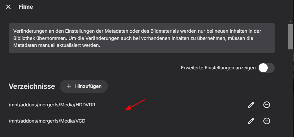

ok, may please as
still missing, how is your setup to libs inside jelly
/mnt/user/media/... ? sample from Emby
what you see, there is no switch happening (possible jelly behaviour), but this shouldnt be the big issue as long Jelly reopens properly, so may a final screen from your media setup inside jelly please
ok, here the changelog for the following update later today

>>>> IMPORTANT, pool (cache) device 1st !!! see further Infos down
>> Plex setup, use mergerfs Share like /mnt/addons/mergerfs/Media instead Standard (simulated Array via mergerfs with pool disk 1st)
>> Plex setup, docker path mounts ... recommended 1:1 relation, like /mnt<>/mnt ... then there are NO rewrite rules necessary
>>>> there is a rewrite section like /data:/mnt/user/Media /data2:/mnt/addons/mergerfs/Media just in case, see recommended /mnt ...
>>>> its a ":" sepearated for each mount (already configured ones are taken over)

Thanks for all the support. The issue with my radaarrr was due to plex. For soem reason when I had this pointed at my media folder it didnt allow radarr to save anything to it, but tv worked. When I changed to mnt/user it worked. I see this error do you know it may mean? IMG_2225.thumb.jpeg.e60db42a65bec9d07b95baf6844ca6e6.jpeg

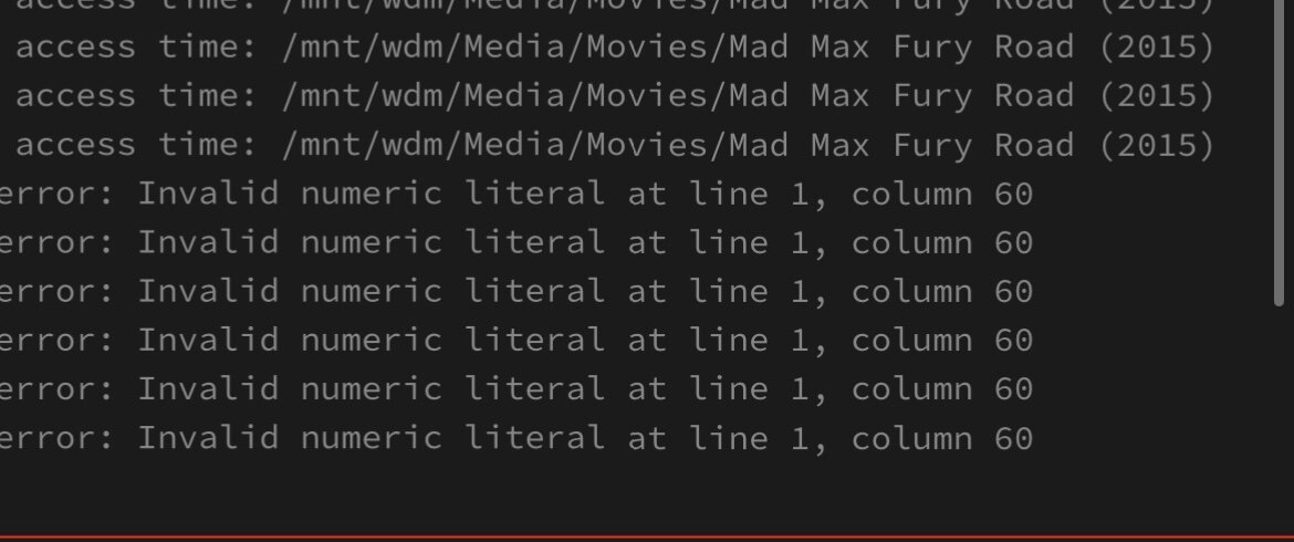

actually not, its been mentioned before but i never was able to reproduce it.
are you on the current version ? i rewrote almost any parts ... just to make sure its still there on the latest version.
as its a error which occurs while playback, its nothing mandatory to the function, but i still would like to tear it down what ... if you are on the latest version let me know please, then i ll look for this "cosmetic" issue.
thanks for the feedback
Yes I am on the latest, and could it because plex is noting to mnt/user rather then mnt/user/media?
thanks for the note ... too bad ;)
and no, shouldnt belong to this, i ll look into it on the weekend ... somehow i have to reproduce it ;)

The newest Version don´t work at my system.
The last version with the source disk selection was working
I think i have mistake at the configuration but i don´t know
The only error message I get is when I set the media server mode to "only".
grafik.thumb.png.5dc886f5f9461f06994c63a7a374ef54.pnggrafik.png.04d6c1aa8cc04123843cbf153753b9de.pnggrafik.png.aa7f4cc85f6b9585d08e4f2a97538b7b.png
actually i dont see any fails, you can change the following setting (but doesnt bother now and has nothing todo with non working now)
i ll setup a test scene with mounts like yours and also i see a small bug from me on multi mode, but shouldnt affect "only" mode.
i leave a note here, sorry ... if you need a fallback, pm me
