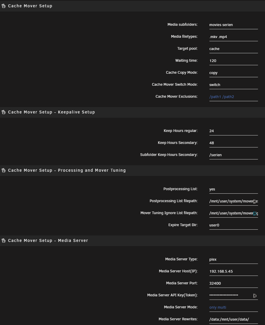

here are my settings:

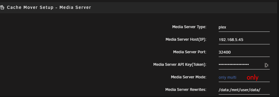

may set following mode (type only there)

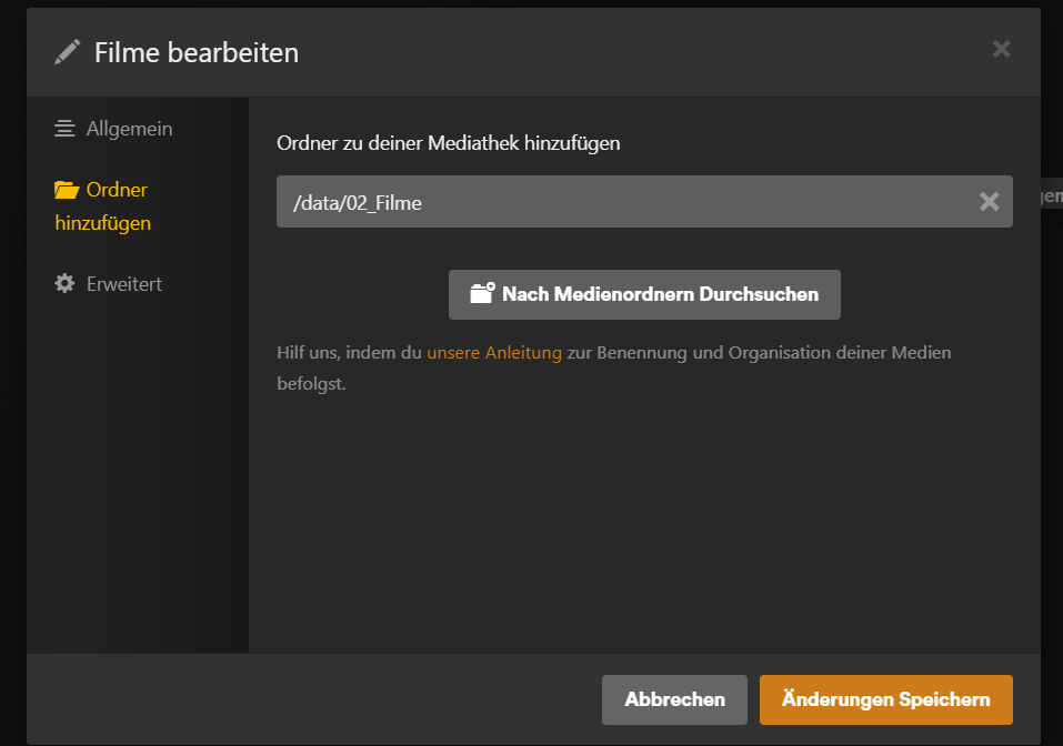

and your plex mount from docker is for real /data <> /mnt/user/data ? just to cross check ;)
I did the changes and here is the plex mount
lets wait and give it a try because last time the media server only mode did not move anything to the cache
I'll keep you posted
ok this error message disapeared, but now its not copying to the cache!
