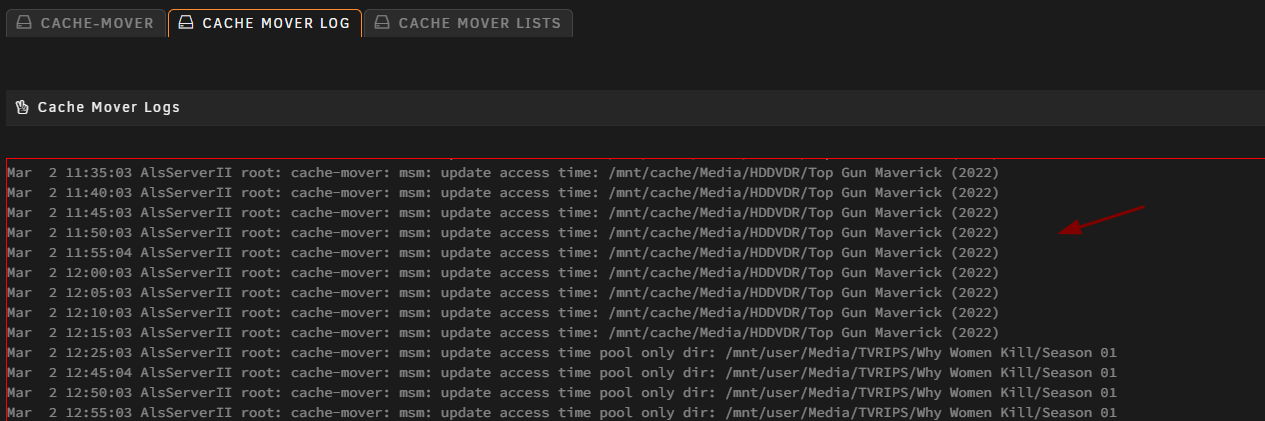

so it looks like chache mover is changing te last access time.
pretty sure not, at least you would see it in th elogs (if enabled), all activity is logged there
you have any entries there from cache mover ?
and i can say, working as it should, sample here
if there is cache mover activity, let me know so i can look what could be causing this, bus as mentioned, every access time change from cache mover comes with an (echo) syslog entry ... from code as sample

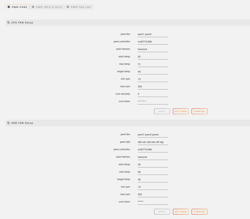

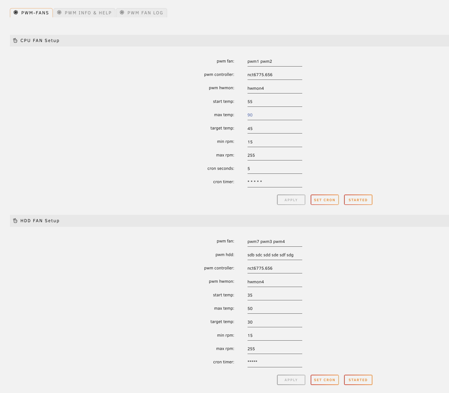

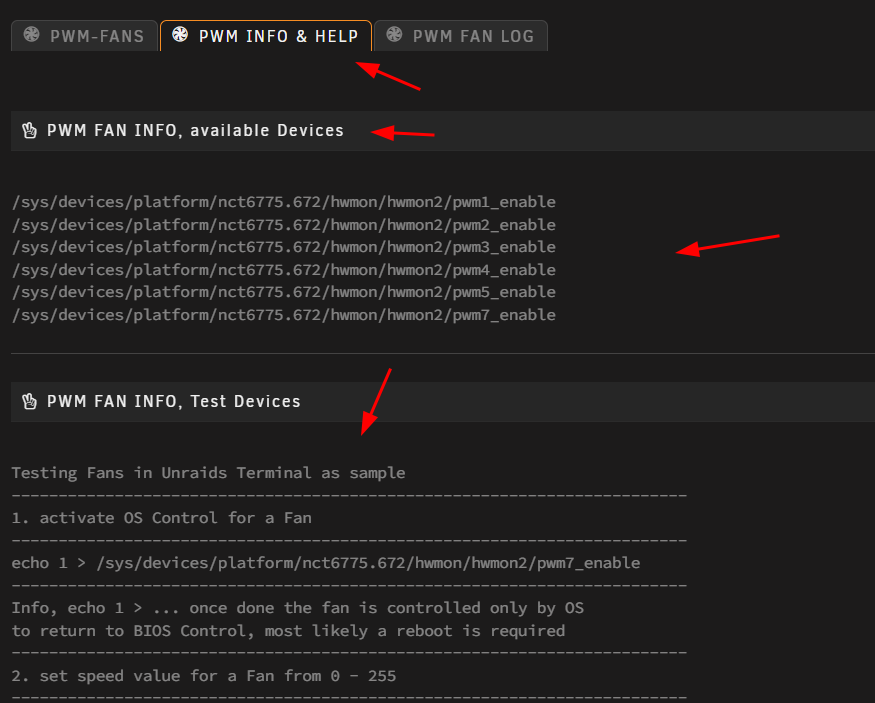

i used information gathered form dynamix system autofan, but pwm-fans can't work

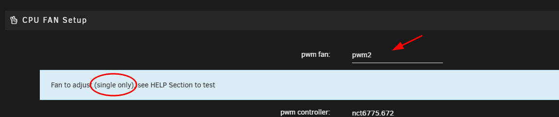

you know there are some helpers included
CPU Section
no max setted (only blueprint ...)
HDD Section, looks like wrong cron format (no spaes ?)
and overall, you see if your extries are correct as there is also a help page with found ... and howto test
but may start correcting your settings first ;) values should be the same from autofan and here ;)

thanks bro!

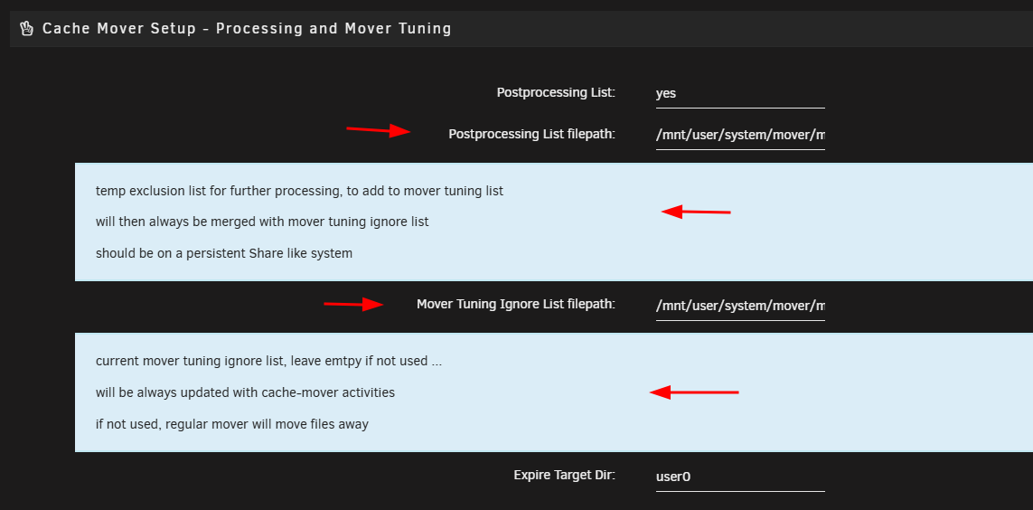

cache mover is only transfering from array >> cache (pool disk), all existing files which are only on pool (new media) are only updated access times while playing, thats it ... but of course not deleted if thats the question ;)
plugin has its own "cached" list, only the files processed by the plugin are then deleted from cache AFTER a check if the file exists on array too (same size).
therefore you would also have to mkdir /mnt/user/system/mover/ where the lists are stored ... as you see in your logs its not existent ... so cache mover plugin cant store its list ... or set a path of your choice which exists.
also beware, your scheduled mover settings ... in terms you use mover tuning, enable exlusion list and point mover tuning AND this plugin to the same file ...
should be self explaining ;)

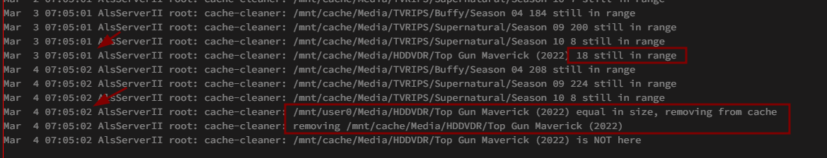

yes, clear enough ;) for this case ...

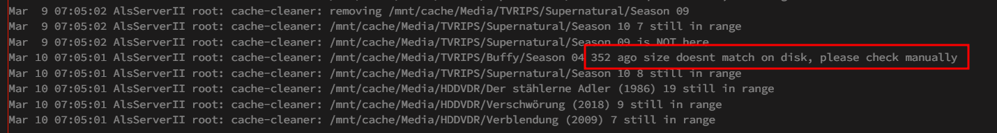

the "cleaner" process does a checkup before deletion, i compare source (cached folder) & target (array folder), if they are not equal, you get a message only
"size doesnt match on disk, please check manually" ...
so no, no delete from files on cache which doesnt exist on array ...
so i wait until season is done, then i remove them from "exlusion list" and mover will move the missing files over.
21 hours ago, farco said:
What happens if after 7 days the series is deleted from the cache (via script) with episode 5 in the Folder because it was not yet copied to the HDD? In the "Mover Tuning - Exluded" only the whole folder is displayed or does the script treat each file in the season folder separately.
here may a sample what happens
i replaced now a file with a different version, so i have a "missmatch" in size
its now out of scope of cache mover, but will stay in mover exclusions "just in case"

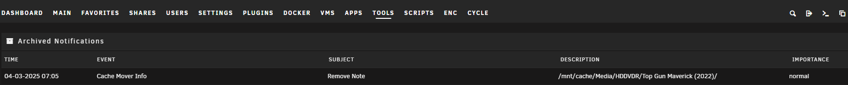

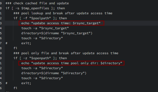

On 2/22/2025 at 4:47 PM, alturismo said:
exactly
you see in my logs while playback when cache mover is updating access times while playing
sorry, but i have no control on other apps accessing ... and thats the most reliable time i can fetch in my point of view.

as I understand you look for the last access time of the cached folder.
exactly, which is modified by cache mover when something is triggered, sample Mediaserver playback.
7 hours ago, mmm77 said:
So the folders are the problem.... (for me)
Is it possible to look only for the access time of the main media file inside the cached folder ??  *.mkv *.avi *.mp4 .....
currently not designed like this, but may i ask what is triggering an access there on your folders ?
may as additional note why i ve chosen folder ... sample
you watch a TV Show, i copy the season folder, there will be no further action on other files as they are cached already (besides updating access time on folder).
if i would look for files, i would have to loop through all single files inside a folder, technically no big deal, but one of my goals always been, as light and fast as possible ... as we see currently with mover tuning, one point is the insane looping through big amount of files and producing huge lists which may also like to produce issues ...
so, once you watched your movie, your tv show season, ... then there shouldnt be any apps accessing the files inside or something else, may another question, do you see in the cache mover logs something about updating your folders after watched state ? if so, we should find a solution therefore, if not, its really some edge case as even Unraid itself doesnt modify access times while accessing them ... thanks ahead for the feedback.

In the cache mover log there is no entry since 08.03.
Only in the cleaner log there are new entries I showed you
Thanks for the explanation, one more quick question.
What do the numbers in front of “still in range” mean?
hours from last access ;)

cache-mover:
the cache mover won´t delete the movie on the cache drive
Cache Cleaner Logs:
Mar  4 07:05:02 Unraid root: cache-cleaner: /mnt/cache/Filme/Independence Day (1996) 0 still in range
Mar  4 07:05:02 Unraid root: cache-cleaner: /mnt/cache/Filme/Independence Day - Wiederkehr (2016) 0 still in range
Mar  5 07:05:01 Unraid root: cache-cleaner: /mnt/cache/Filme/Independence Day (1996) 0 still in range
Mar  5 07:05:01 Unraid root: cache-cleaner: /mnt/cache/Filme/Independence Day - Wiederkehr (2016) 23 still in range
Mar  6 07:05:02 Unraid root: cache-cleaner: /mnt/cache/Filme/Independence Day (1996) 0 still in range
Mar  6 07:05:02 Unraid root: cache-cleaner: /mnt/cache/Filme/Independence Day - Wiederkehr (2016) 0 still in range
Mar  6 07:05:02 Unraid root: cache-cleaner: /mnt/cache/Filme/WarGames - Kriegsspiele (1983) 0 still in range
Mar  7 07:05:02 Unraid root: cache-cleaner: /mnt/cache/Filme/Independence Day (1996) 0 still in range
Mar  7 07:05:02 Unraid root: cache-cleaner: /mnt/cache/Filme/Independence Day - Wiederkehr (2016) 0 still in range
Mar  7 07:05:02 Unraid root: cache-cleaner: /mnt/cache/Filme/WarGames - Kriegsspiele (1983) 0 still in range
Mar  8 07:05:01 Unraid root: cache-cleaner: /mnt/cache/Filme/Independence Day (1996) 23 still in range
Mar  8 07:05:01 Unraid root: cache-cleaner: /mnt/cache/Filme/Independence Day - Wiederkehr (2016) 23 still in range
Mar  8 07:05:01 Unraid root: cache-cleaner: /mnt/cache/Filme/WarGames - Kriegsspiele (1983) 23 still in range
Mar  9 07:05:01 Unraid root: cache-cleaner: /mnt/cache/Filme/Independence Day (1996) 0 still in range
Mar  9 07:05:01 Unraid root: cache-cleaner: /mnt/cache/Filme/Independence Day - Wiederkehr (2016) 0 still in range
Mar  9 07:05:01 Unraid root: cache-cleaner: /mnt/cache/Filme/WarGames - Kriegsspiele (1983) 0 still in range
Mar 10 07:05:01 Unraid root: cache-cleaner: /mnt/cache/Filme/Independence Day (1996) 0 still in range
Mar 10 07:05:01 Unraid root: cache-cleaner: /mnt/cache/Filme/Independence Day - Wiederkehr (2016) 0 still in range
Mar 10 07:05:01 Unraid root: cache-cleaner: /mnt/cache/Filme/WarGames - Kriegsspiele (1983) 0 still in range
Mar 11 07:05:01 Unraid root: cache-cleaner: /mnt/cache/Filme/Independence Day (1996) 0 still in range
Mar 11 07:05:01 Unraid root: cache-cleaner: /mnt/cache/Filme/Independence Day - Wiederkehr (2016) 0 still in range
Mar 11 07:05:01 Unraid root: cache-cleaner: /mnt/cache/Filme/WarGames - Kriegsspiele (1983) 0 still in range
Mar 12 07:05:02 Unraid root: cache-cleaner: /mnt/cache/Filme/Independence Day (1996) 0 still in range
Mar 12 07:05:02 Unraid root: cache-cleaner: /mnt/cache/Filme/Independence Day - Wiederkehr (2016) 0 still in range
Mar 12 07:05:02 Unraid root: cache-cleaner: /mnt/cache/Filme/WarGames - Kriegsspiele (1983) 0 still in range
Mar 13 07:05:02 Unraid root: cache-cleaner: /mnt/cache/Filme/Independence Day (1996) 0 still in range
Mar 13 07:05:02 Unraid root: cache-cleaner: /mnt/cache/Filme/Independence Day - Wiederkehr (2016) 0 still in range
Mar 13 07:05:02 Unraid root: cache-cleaner: /mnt/cache/Filme/WarGames - Kriegsspiele (1983) 0 still in range
Cache Mover Logs
ver: reg: ready to switch live
Mar  2 20:23:32 Unraid root: cache-mover: reg: -: No such file or directory.
Mar  2 20:23:32 Unraid root: cache-mover: reg: (gdb) Attaching to process 13410
Mar  2 20:23:32 Unraid root: cache-mover: reg: [New LWP 778682]
Mar  2 20:23:32 Unraid root: cache-mover: reg: [New LWP 778680]
Mar  2 20:23:32 Unraid root: cache-mover: reg: [New LWP 26227]
Mar  2 20:23:32 Unraid root: cache-mover: reg: [New LWP 20667]
Mar  2 20:23:32 Unraid root: cache-mover: reg: [New LWP 13544]
Mar  2 20:23:32 Unraid root: cache-mover: reg: [New LWP 13542]
Mar  2 20:23:32 Unraid root: cache-mover: reg: [New LWP 13414]
Mar  2 20:23:32 Unraid root: cache-mover: reg: [New LWP 13411]
Mar  2 20:23:32 Unraid root: cache-mover: reg: [Thread debugging using libthread_db enabled]
Mar  2 20:23:32 Unraid root: cache-mover: reg: Using host libthread_db library "/lib64/libthread_db.so.1".
Mar  2 20:23:32 Unraid root: cache-mover: reg: 0x000015006e26ac4f in __futex_abstimed_wait_cancelable64 ()
Mar  2 20:23:32 Unraid root: cache-mover: reg:    from /lib64/libc.so.6
Mar  2 20:23:32 Unraid root: cache-mover: reg: (gdb) $1 = 23
Mar  2 20:23:32 Unraid root: cache-mover: reg: (gdb) $2 = 22
Mar  2 20:23:32 Unraid root: cache-mover: reg: (gdb) $3 = 0
Mar  2 20:23:32 Unraid root: cache-mover: reg: (gdb) Detaching from program: /usr/libexec/unraid/shfs, process 13410
Mar  2 20:23:32 Unraid root: cache-mover: reg: [Inferior 1 (process 13410) detached]
Mar  2 20:23:34 Unraid root: cache-mover: msm: update access time: /mnt/cache/Filme/Independence Day (1996)
Mar  2 20:32:03 Unraid root: cache-mover: reg: update access time: /mnt/cache/Filme/Independence Day (1996)
Mar  2 20:32:05 Unraid root: cache-mover: msm: update access time: /mnt/cache/Filme/Independence Day (1996)
Mar  2 20:42:03 Unraid root: cache-mover: reg: update access time: /mnt/cache/Filme/Independence Day (1996)

mover Settings
any Idee?
