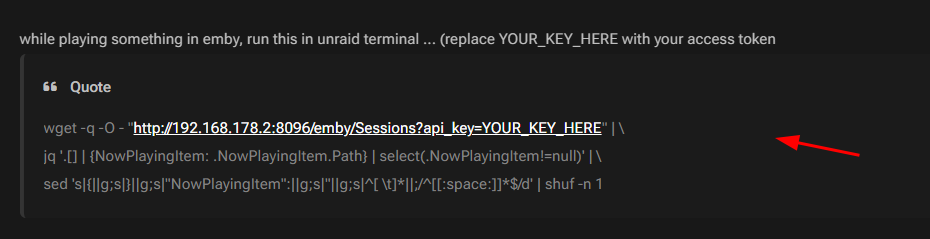

9 minutes ago, alturismo said:
nope
root@Server:~# wget -q -O - "http://192.168.178.2:8096/emby/Sessions?api_key=" | \jq '.[] | {NowPlayingItem: .NowPlayingItem.Path} | select(.NowPlayingItem!=null)' | \sed 's|{||g;s|}||g;s|"NowPlayingItem":||g;s|"||g;s|^[ \t]*||;/^[[:space:]]*$/d' | shuf -n 1
\\\\192.168.178.2\\Media\\Filme\\The.Surfer.2024.German.EAC3.DL.1080p.BluRay.x265-VECTOR\\The Surfer (2024).mkv
ok, that is not a normal respond ... ;)
may i ask, did you use smb in emby for your media ?
Did you mean the attachment ?
exactly ... that is not supported, and also, shouldnt be needed as you have your mounts in emby ...
root@Server:~# wget -q -O - "http://192.168.178.2:8096/emby/Sessions?api_key=2e5701c3fc314112b67b4f10c6483e7b" | \jq '.[] | {NowPlayingItem: .NowPlayingItem.Path} | select(.NowPlayingItem!=null)' | \sed 's|{||g;s|}||g;s|"NowPlayingItem":||g;s|"||g;s|^[ \t]*||;/^[[:space:]]*$/d' | shuf -n 1
/media/Media/Filme/The.Surfer.2024.German.EAC3.DL.1080p.BluRay.x265-VECTOR/The Surfer (2024).mkv

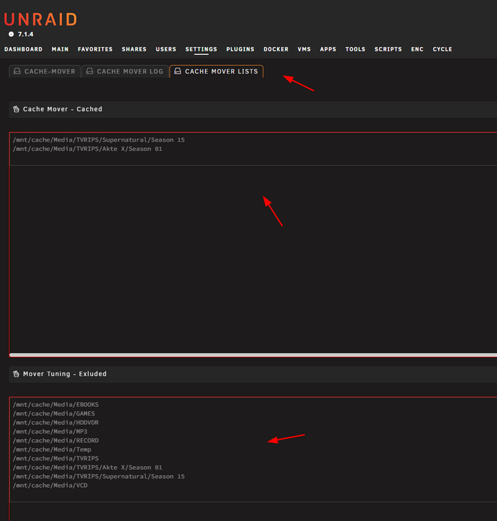

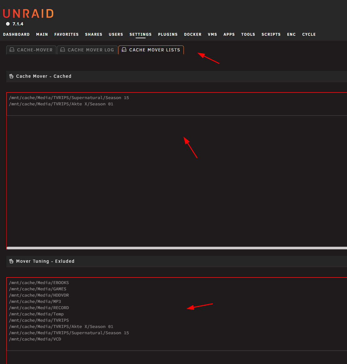

check your list screen in cache mover ...
and here ...
as your setup was missconfigured ... may need to clean your exclusion and cached ... manually ...

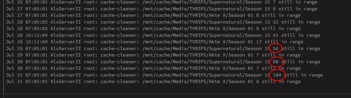

Ok, the cache cleaner is not working at all.
Every file is " still in range"

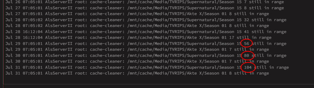

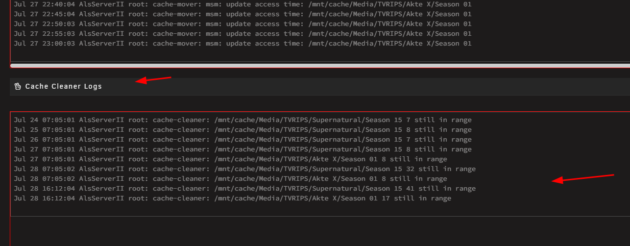

it definately is working ... ;) may not at your place ;)

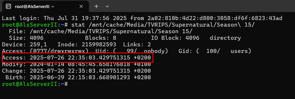

therefore, if it says "still in range", may check last timestamp on your folders ...
either "something" else is accessing always the file/s on your drives, or if its a zfs pool ... thats on todo if that may causes this behaviour.

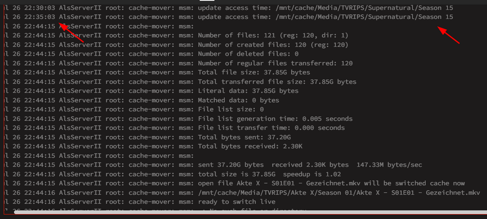

may as sample @Gepelmario
thats what i am using, as you see here ...
its counting up, there you can look for when the last access happened ...
one upper you see the logs if cache mover would update access times, i guess not, so "something" is happening ... sample to this
there was the last update ... from my plugin, anything else if timestamps differ ... coming from "elsewhere" on your system, either some app, some filesystem thing, some ...

yep, what does cache cleaner logs say ?

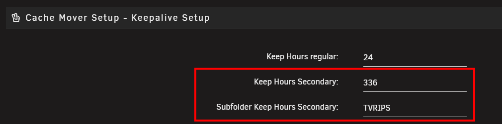

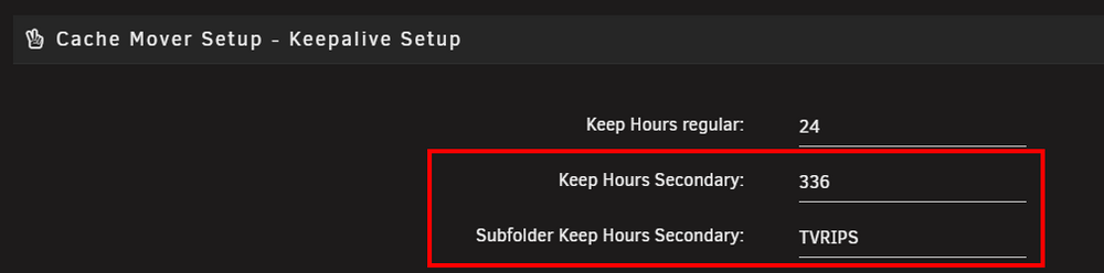

as you dont use any "Extra" Dir, i guess something ...
may out something like "abcdefg" in the keep sub section, or set the time similar to main (24)
I have no idea what you mean :)
AHH, ok , thank you.
That did the trick:)
Thank you very much for your patience
