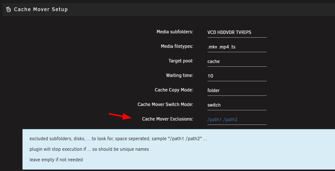

Hi hoping to get some help. I have noticed that the cache mover moves things quite quickly and have noticed that when it moves it out of the folder it shows as the file "is NOT here". I also noticed some yellow notices which I don't quite know what it means. Please see the attached and would love your advice. Thanks.Screenshot 2025-08-11 at 7.36.31 PM.png
on another note this folder relates to the downloads and it is listed as an exclusion. I added to the exclusion list under settings do I need to add anything else? do I need to remove it from the list?
Thanks appreciate the help.
the shown list is exclusions for mover tuning, NOT for cache mover.
cache mover is excluding them for the mover so they wont get moved to array again in the daily schedule ...
to exclude "download" folders etc ... try the proper setting
so like /completed in there will exclude this subdirectory.

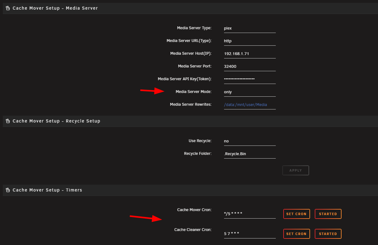

I configured this plugin and it doesn't seem to be doing much of anything. I want it to move 4k content when it gets loaded in plex, but nothing shows up in the logs. Any help with it would be amazing.
may also put "something" in subfolder blueprint section (if you dont need it, some name which doesnt .. like /blablabla
and you dont have the postprocessing configured too, would end up in "no delete" after N time
about your issue that "nothing" happens, may show a screen from you buttom entries
consider, blueprints are blueprints, NO real values, just as samples

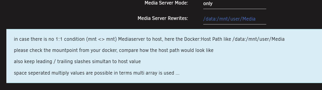

Media Server Rewrites needs to be /PlexContainerPath:/UnraidPathToSameFolder, right?
And will the first field work the way I have it? My folder names have spaces in them, so it needed a separator of some sort. Double quotes didn't save.

6 hours ago, RuneMason1 said:
Gotcha, i assumed "Blue" values meant "default value is this" and you didn't have to change anything.
alot did i guess, i just added blueprints to better understand what should be ... ;)
as note, your cron entries are still "empty"
when you mouseover a field description, a ? mark will appear, i added some help text to each point
so depends on your docker setup, as Plex returns its own path the plugin needs to know what the root path would be

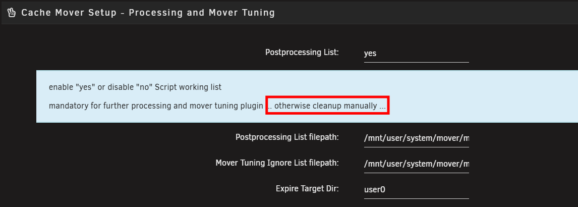

What should I put in the postprocessing section? A lot of it I don't exactly understand what it does.
same here with help
short, if thats not properly setup / configured ... the plugin will
1/ not auto clean the copied files from cache away
2/ wont exclude those files from mover in terms you use the mover function ...
so yes, its more or less mandatory to have full benefit.

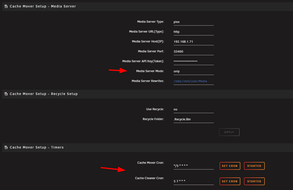

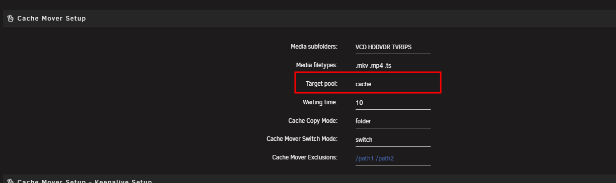

I have a movie loaded from my 4k library and nothing shows up in the logs. However, there's this:
as i prefer not creating any dirs just like that and let users choose what, where ...
may atleast create the directory /mnt/user/system/mover
when i look further, you "Cache", is it really uppercase and may not "cache" ?
and while playback runs, test your Plex return, replace YOUR_TOKEN_HERE with your token and paste result please
KEY=$(curl -s "http://192.168.2.1:32400/status/sessions?X-Plex-Token=YOUR_TOKEN_HERE" 2> /dev/null | grep -oP 'ratingKey="\K[^"]+' | shuf -n 1)

Cache is for sure capitalized.
went and created the system/mover folder.
Grep result: /mastermedia/4k films/The Amazing Spider-Man (2012) {imdb-tt0948470}/The Amazing Spider-Man (2012) {imdb-tt0948470} [Remux-2160p Proper][HDR10][TrueHD Atmos 7.1][HEVC]-FGT.mkv.

this is the line:
/data:/mnt/user/Filme/ /data:/mnt/user/Anime Filme/
i almost guess, too many special characters ... especially the {} ... may run this while your movie is playing
/usr/local/emhttp/plugins/cache-mover/scripts/cache_mover4
that cant be nice, 2x same docker path on 2 different host pathes ...
may a screen from your docker mappings please as this is not a good setup at all
