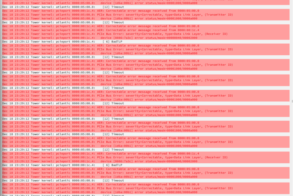

Thanks alturismo for your pointers.
is it stable in all terms in the setup
L0s L1 turned out to be unstable (judging by the logs). I suspect this is because the PCIe root, according to ASPM Helper and my BIOS settings, only supports L1. So not only does L1 lower power consumption by around 8W compared to L0s L1, it is also more stable.
What enabling L0s L1 through ASPM Helper causes

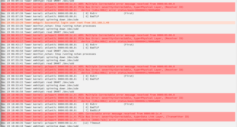

I do have another question: L1 has been stable so far in the sense that all my apps work, and (as far as I can see) I never lose connection. But in the logs I now see the same errors I saw with L0s L1, just much less frequent. Is it safe to leave L1 enabled in ASPM Helper, or is it a sign I should live with no ASPM on that device, or replace it with a NIC that natively supports ASPM?
For context, I get this error every hour or two, instead of hundreds of times per second with L0s L1.
Here is a text copy for your convenience. The root and device addresses match the device I force enabled L1 to. 05:00.0 is my TEG-10GECSFP 10Gbe SFP+ NIC. 00:1c.4 is the PCIe root it is connected to.
NIC error:
Dec 19 10:40:35 Tower kernel: pcieport 0000:00:1c.4: AER: Multiple Correctable error message received from 0000:05:00.0
Dec 19 10:40:35 Tower kernel: atlantic 0000:05:00.0: PCIe Bus Error: severity=Correctable, type=Physical Layer, (Receiver ID)
Dec 19 10:40:35 Tower kernel: atlantic 0000:05:00.0:   device [1d6a:00b1] error status/mask=000000c1/0000a000
Root error (which the NIC is connected to):
Dec 19 10:40:35 Tower kernel: pcieport 0000:00:1c.4: AER: Correctable error message received from 0000:00:1c.4
Dec 19 10:40:35 Tower kernel: pcieport 0000:00:1c.4: PCIe Bus Error: severity=Correctable, type=Data Link Layer, (Transmitter ID)
Dec 19 10:40:35 Tower kernel: pcieport 0000:00:1c.4:   device [8086:7a3c] error status/mask=00001000/00002000
Thanks again for your time.
well, if it stays stable, if your file transfers are all fine, if you checked file integrity, if ... i may would live with it when its a ~ 8+ Watt change ;)
and disable the AER reporting then, either in BIOS or as Kernel Parameter (pci=noaer) or syslog filter or ..., but keep in mind if you see issues to remember and howto enable it again ;)
Good idea for file integrity, I didn't think about that!
I'm hoping this works, because my TEG-10GECSFP is the only 10Gbe SFP+ NIC (that isn't a 130€ Intel X710) which "supports" ASPM where I live. If I can't get it to work stable, I guess I'll just switch back to RJ45.
I'm firmly in the camp of scrolling down in the log, rather than potentially missing something important ha ha
Thanks for your help!
