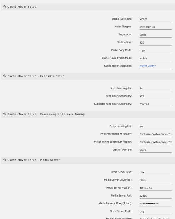

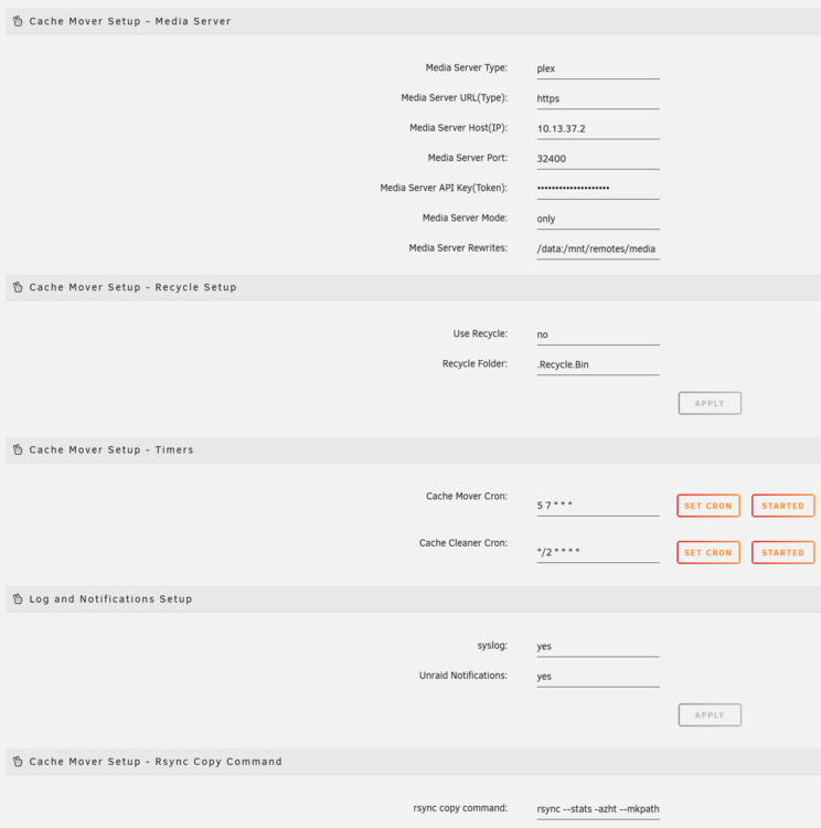

I tried to setup cache mover but it does nothing but running the crontabs.
In Unraid I can access /mnt/remotes/media and I see my directory "Videos"
In Plex I have to access /data to see the directory "Videos"
directory /cached doesn't exist (where should it be?)
the two profcessing and mover tuning file path or the files didn't exist as well, I created the necessary directory and touched the files.
in short @an3k , /mnt/remotes/... currently not supported like described in discord.

  1. essentially it locks on to disk1 rather then user and tries to move the downloaded files rather then the one in the post radarr/sonarr file I see this #012 error
  2. Cache Mover settings
  3. JellyFin settings
