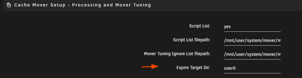

8 minutes ago, simatra said:
I have now Target pool: pointing to the standard pool for my media.
thats exactly how it should be, most likely user0 (user0 is without cache drive array only, user is including cache drive)
i think i have to rewrite some readme ;) but you did it the right way ... if we talk about this here ...
there the plugin looks for existing File to decide moving back to array (if not existend) or (if existend) then either wipe or delete to recycle is enabled ...
so its mandatory that this is your /mnt/user0 path where the hdd's are lying under ... and where we grab the files for caching

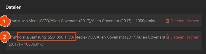

20 hours ago, MarianKoniuszko said:
can I use my second SSD drive that is connected with USB? I use it only for emby transcoding folder and it have only 8GB space used.
ok, made some tests here with plex, rewriting live to an external disk aint the point, working fine and also working "live", but ... the issue is the priority in plex, whatever i do the cached file would be almost anytime "2nd choice" only for now ...
even the chronologie is adjusted
means in the end, "copy" wouldnt work, only move forward to external, when watched and after N time, move backwards to array ... as this is not my recommended way in my terms i ll have to dig further to get the complete feature working as it should be ...
because once you hit stop and start again, plex will take the 1st hit which would be array disk again ...
so sorry for now, aint a easy solution for now ... suggestion, get a bigger cache drive ;) sorry to say ... ;)

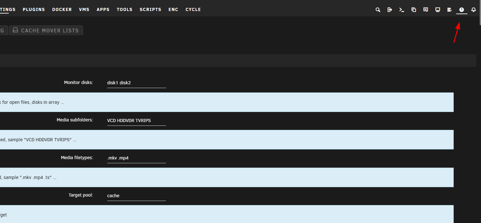

@alturismo for example how to fill that fields?
1. Put disk1 disk2 disk3 with only space or comma [disk1,disk2,disk3].
2. Media subfolders to put whole path? `/mnt/user/data/media/movies` or like on screenshot?
3. What is `Subfolder Keep Hour Secondary?
4. Do i need to change something else in that settings?
do I have to change something in rsync command?
Regards.

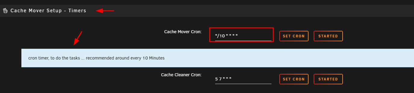

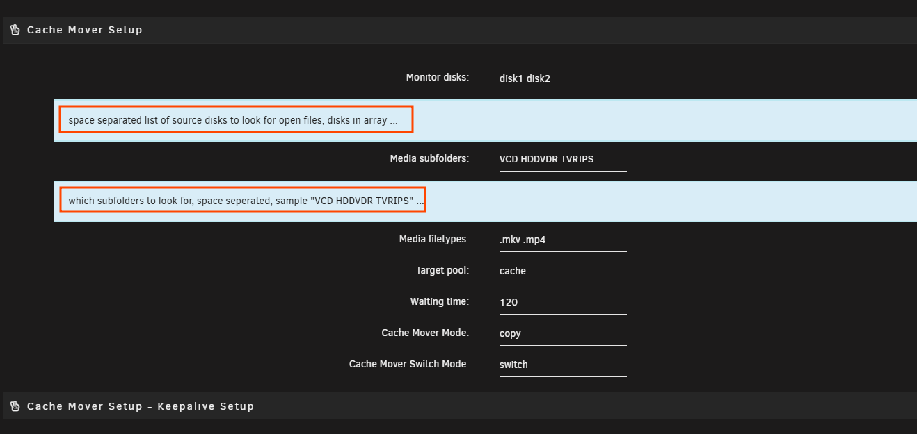

you know there is a "mouse over" description on each point ? which pops up when you klick on the question mark then
most common in many plugins ;)
like on screenshot and also here
sample from the "Help"

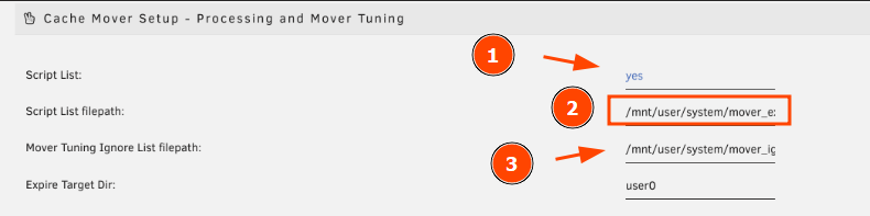

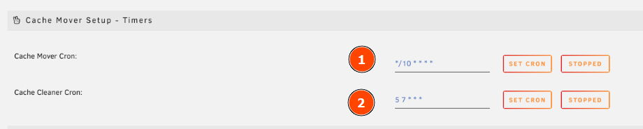

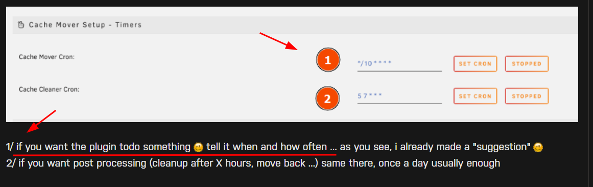

1/ if you want post processing, set to yes (and you should .use it)
2/ set here a filepath where to store "history list" for post processing
3/ if you are using mover tuning exclusion list, then the path to that existing file
1/ if you want the plugin todo something ;) tell it when and how often ... as you see, i already made a "suggestion" ;)
2/ if you want post processing (cleanup after X hours, move back ...) same there, once a day usually enough

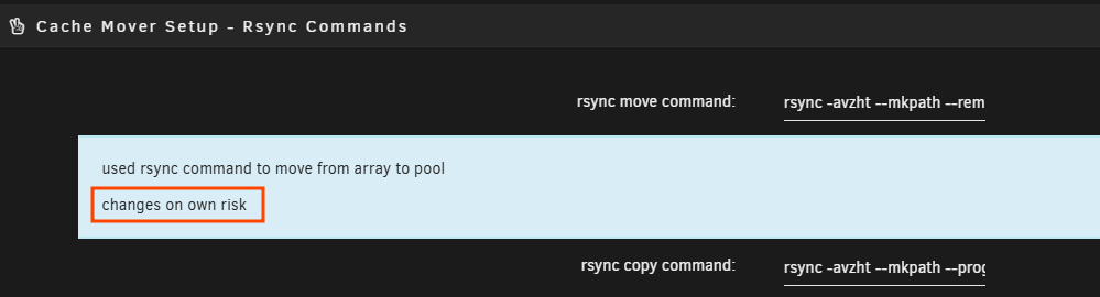

should be self explaining ...
honestly, make yourself a little more familiar with howto read plugins, helps, ... before you shoot something down ;)
i answer question anytime, but please not what is obviously standing there ;) thanks.

if you would takeover this setting, it would check every 10 minutes (0, 10, 20, 30, 40, 50) ... so as sample 22:10 it will look here again for open files ... and then do its job.

this is the timer ? you can set when it runs here (actually you must ...  ;))
to stop it, simply empty the field and click "set cron"
