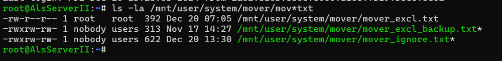

Dec 20 09:50:01 Jarvis root: cache-cleaner: cat: /mnt/user/system/mover_excl.txt: No such file or directory
Dec 20 09:50:01 Jarvis root: cache-cleaner: cat: /mnt/user/system/mover_ignore.txt: No such file or directory
Dec 20 09:50:01 Jarvis root: cache-cleaner: cp: cannot create regular file '/mnt/user/system/mover_ignore.txt': No such file or directory
but I checked on both files a present at the location
Edited by simatra
20 minutes ago, simatra said:
but I checked on both files a present ant the location
may please a screenshot from Terminal
ls -la /mnt/user/system/mover*.txt
like this (i have them in a subfolder, doesnt matter, just need to be there)
here we go
4 minutes ago, simatra said:
here we go
hmm, looking good.
would you may try chmod 777 them
chmod 777 /mnt/user/system/mover*.txt
just to make sure ...
this did the trick thanks
thanks for the feedback, i ll put something in the install routine then for the future ;)

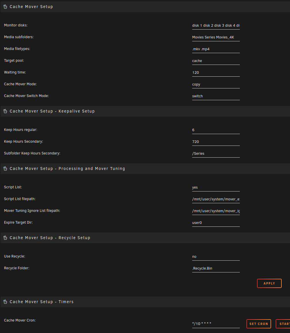

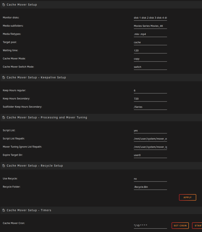

Problem with cache-mover, it keep making a cache folder with number like my disks.
Cache Mover - Cached
/mnt/cache4/Movies/Venom - The Last Dance [2024]
/mnt/cache4/Movies/Heretic [2024]
Mover Tuning - Exluded
/mnt/cache9/Series/American Dad!/Season 21
Invalid folder cache1 contained within /mnt
Invalid folder cache4 contained within /mnt
Invalid folder cache9 contained within /mnt
Edited by ChillZwix
may show me your setup page please

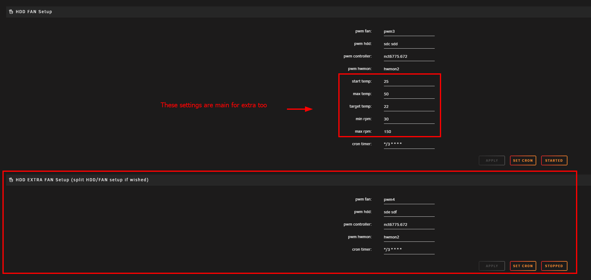

On 12/18/2024 at 5:59 PM, Bfox135 said:
There is only 2 active control settings. is there any possibility to add more fan settings to control more fan separately from each other?
So all of the fans don't have to speed up based on one Hard drive Temp?
good morning
2024.12.21 - added extra HDD Section for split setup (following main temp fan rules)
so now you can split some fans specific to other hdd's
in sum now 3 possible controls (1 extra now)
CPU (1 fan only following CPU Temp)
HDD (multiple fans / multiple hdd's)
HDD extra (multiple fans / multiple hdd's)
@ChillZwix
do you have a space between disk 1 ... ? disk1 disk2 ... would be correct
5 minutes ago, alturismo said:
@ChillZwix
crap, yes... Did fix it now!! Will now try to check.

On 12/21/2024 at 3:32 AM, alturismo said:
good morning
You are AMAZING!!
Thank you!!
