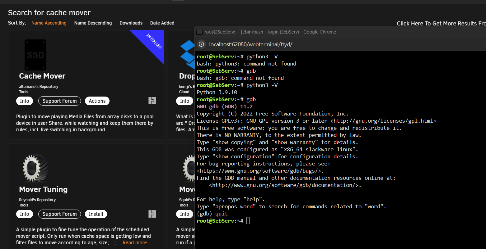

4 hours ago, alturismo said:
just missing some feedback from 6.12 users here if live switch (gdb) is working now ... my tests went fine, just want to close this issue here for me now ;)

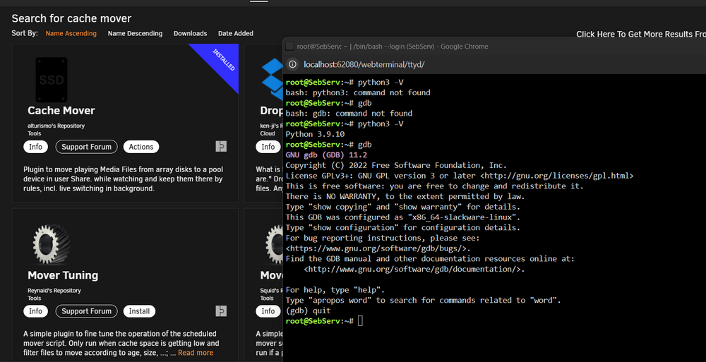

I ran into an update issue: the updater complained about a corrupt libunistring-0.9.10-x86_64-3.txz file.
Trying to resolve it on my own: I did a clean plugin install, same issue (see logs below)
Maybe something to look into?
To fix it manually i downloaded the libunistring package and installed it manually. it looks like gdb is now working!!
Thank you so mutch for this quick fix. Really cool feature tho!

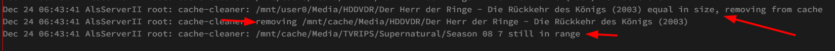

6/ when the "Cleaner" cron runs, now ... look what we have moved
7/ check if the files are still in wanted last access hours range
8/ if yes, nothing todo, if no ...
either now wipe the dublette on pool, or ... move it to recycle (if configured), or ... move back to array (user0) if it has been moved instead copied (which is not recommended, ping pong ...).

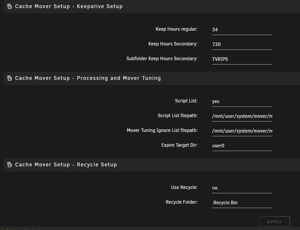

make sure file is also on array, then ... and if file is still "in range, 7 hours agao last access ..."

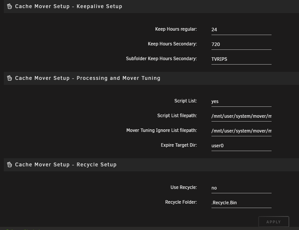

the "keephours" can be setted up so 1 section (secondary) can be kept longer, in my sample's TVRIPS ... as once i start a Show its not like a movie thats been watched directly, Shows here (woman or daughter) a episode may be watched "today, next week, ...) so i set this to be kept longer cached ...
these settings are responsible therefore
i also merge my list to the mover tuning plugin exclusion list to make sure the regular mover is not moving ... cached files or whatever ...
this only matters if you are using the mover tuning plugin ;) if not ...

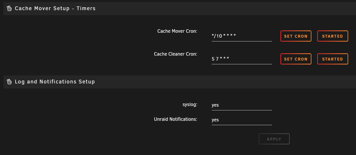

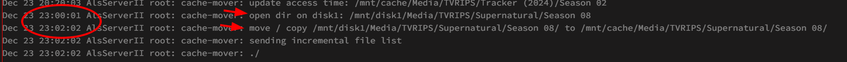

1/ part 1 ... when does the plugin look for open files and so on ... (here every 10 Minutes)
means, every 10 mins i look for open files (between there is happening nothing), so as sample usecase here again

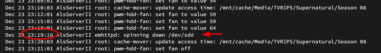

- watching started at ~ 22.55 (spinup disk ...)
- plugin (every 10 min) looked at 23.00
- plugin (every 120 seconds) checked again and started job as "ok"
- plugin ended job at ~ 23.04 (copy done, live switch done)
- - as note, if the job takes longer then 10 mins ... it will keep alive and new job wont start untel its done

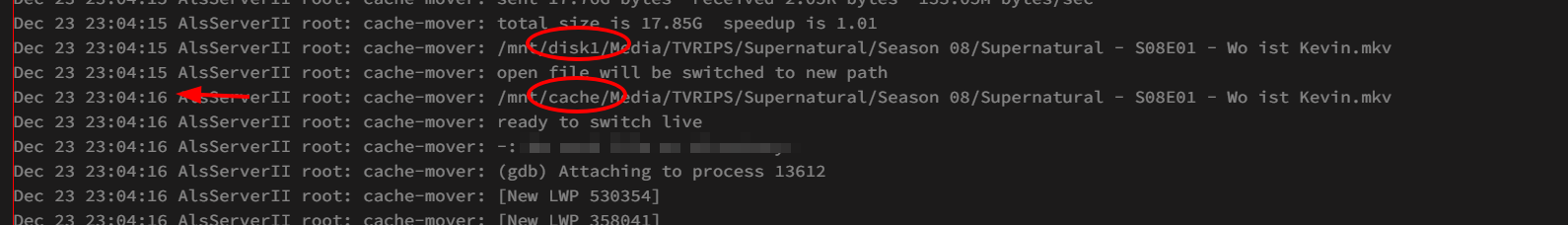

Dec 23 22:55:51 AlsServerII emhttpd: read SMART /dev/sdd
Dec 23 23:00:01 AlsServerII root: cache-mover: open dir on disk1: /mnt/disk1/Media/TVRIPS/Supernatural/Season 08
Dec 23 23:02:02 AlsServerII root: cache-mover: move / copy /mnt/disk1/Media/TVRIPS/Supernatural/Season 08/ to /mnt/cache/Media/TVRIPS/Supernatural/Season 08/
Dec 23 23:04:15 AlsServerII root: cache-mover: total size is 17.85G  speedup is 1.01
Dec 23 23:04:15 AlsServerII root: cache-mover: /mnt/disk1/Media/TVRIPS/Supernatural/Season 08/Supernatural - S08E01 - Wo ist Kevin.mkv
Dec 23 23:04:15 AlsServerII root: cache-mover: open file will be switched to new path
Dec 23 23:04:16 AlsServerII root: cache-mover: /mnt/cache/Media/TVRIPS/Supernatural/Season 08/Supernatural - S08E01 - Wo ist Kevin.mkv
Dec 23 23:04:16 AlsServerII root: cache-mover: ready to switch live
Dec 23 23:19:16 AlsServerII emhttpd: spinning down /dev/sdd
Dec 23 23:20:03 AlsServerII root: cache-mover: update access time: /mnt/cache/Media/TVRIPS/Supernatural/Season 08
Dec 23 23:30:03 AlsServerII root: cache-mover: update access time: /mnt/cache/Media/TVRIPS/Supernatural/Season 08

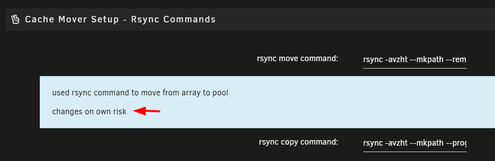

the buttom 2 lines shouldnt be touched, but if someone would like to change the copy / move commands, be free ...
and when you move the mouse over a setting name, a help / Info mark (help) can be popped up, as shown here

fresh install, working
How can I see that the plugin works? Cache Mover Logs and Cache Mover Lists ---> keeps empty. Doesn't matter if I open a file with vlc player or Plex.
install done, gdb seems to run

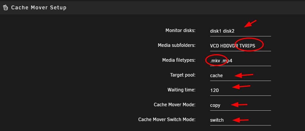

Configuration done as described:

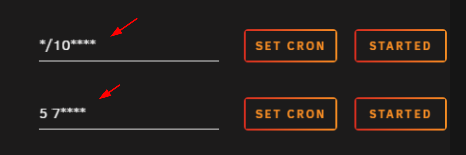

and i would say it never runs as you forgot some spaces here ;) when i interpret your picture correctly ...
sample from here ...
Yes, great, thank you for this hint. Some spaces at the right place can be a miracle. Now it works. Thanks for this great plugin.

Dec 24 23:03:39 AulakhHome root: cache-mover: Unable to find gdb, check readme
Dec 24 23:03:44 AulakhHome crond[1642]: exit status 1 from user root /usr/local/emhttp/plugins/cache-mover/scripts/cache_mover2
I see the unable to find gdb, when I run it in terminal I get:
gdb: /lib64/libm.so.6: version `GLIBC_2.38' not found (required by gdb)
gdb: /usr/lib64/libdebuginfod.so.1: version `ELFUTILS_0.188' not found (required by gdb)
gdb: /usr/lib64/libstdc++.so.6: version `CXXABI_1.3.15' not found (required by gdb)
gdb: /usr/lib64/libtinfo.so.6: no version information available (required by gdb)
gdb: /lib64/libncursesw.so.6: no version information available (required by gdb)
gdb: /lib64/libc.so.6: version `GLIBC_2.38' not found (required by gdb)
gdb: /lib64/libm.so.6: version `GLIBC_2.38' not found (required by /usr/lib64/libpython3.11.so.1.0)
gdb: /lib64/libc.so.6: version `GLIBC_2.38' not found (required by /usr/lib64/libpython3.11.so.1.0)
not sure what it means, would love your advice :)
there is something missing ...
what Unraid Version are you running on ? may provide some diagnostics as of now with the latest version i actually cant tell ... gdb should install fine on either 6.12.13+ and v7.0+

added a exclusion function, be aware, should be a unique name ....
usecase, some working directory on the array (encoders, downloaders, ...) which may also fit in the search patterns and files are in read mode there ... so to exclude them from copy to cache ... thats what this is about.
sample, files in
/mnt/disk1/work_directory/Media/VCD/somefile.mkv
would be "work in progress" to get moved to
/mnt/disk1/Media/VCD/somefile.mkv
and the rules would be
disk1 disk2
VCD HDDVDR
.mkv
plugin would consider both source pathes as valid to be used while files in read mode  ... so to exclude we would add
/work_directory
so everything in /work_directory would be skipped
doesnt matter if its a root Share Name or a sub directory, its a regex search pattern.

14 hours ago, alturismo said:
this happens as
I'm on 6.12.14 I have attache something form the diagnostics run.
