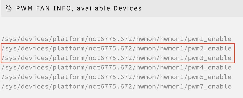

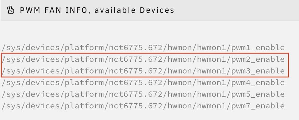

I'm having troubles getting the PWM fan plugin working.
Under "PWM INFO & HELP" tab, I don't have anything listed under "PWM FAN INFO, available Devices". Does that mean this plugin will not work for me?
Following the info/help tab, I attempted to execute the command listed for step 1, but there isn't anything named "hwmon" and it returns an error there is no such file or directory. I'm assuming that's because there are no available devices?
Thanks
pretty sure, sadly yes ... the plugin is looking for pwm fan controllers (and it only works with pwm, no dc control).
Ok thanks. Do you think there is a way to add more support for more PWM controllers in the future? This plugin was exactly what I was looking for (PWM fan control based on HDD temps).
i dont think i understand you question ... as soon your controllers are defined by the OS it should be ok ...
this plugin does not provide any drivers ...

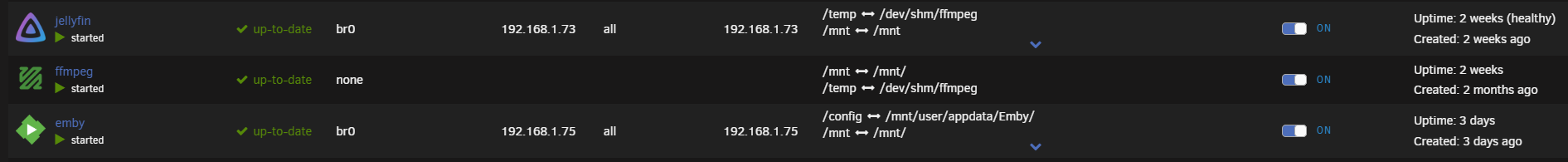

Just installed today on 7.0.0-rc.2. At first, nothing was happening. Loaded movie from Jellyfin in browser, waited, waited some more. Before I knew it, the movie had been playing for 30 minutes in the background. Checked Cache Mover Log and Cache Mover Lists. Both blank.
Read through forum posts. Added "/" after my subfolders as below. Also loaded up a movie on a Jellyfin app on the Shield. Waited for the cron to fire - SUCCESS.
Maybe it was the "/" in the keywords, or maybe it was the browser was just caching too much of the movie and not keeping the connection open long enough for the plugin to see it.
Hope this helps someone else out there.
Many thanks!
adding a slash shouldnt make any difference (plugin does check lead, trailing slashes)
jellyfin, ok, you are now user nr. 2 im aware off and i could reproduce it, but sadly have no solution ... yet.
Jelly as sample does on remux only really short read a file, create its HLS snipplets and release the running Media File immediately again ... so for the OS, there is no "file in use" by the OS as Jelly is Serving its HLS snipplets from its own cache (always building a few minutes stream caching).
while on direct play (as expected) and transcoding (this wonders me) the used Mediafile stays open ...
thanks for the feedback
as note, you can always cross check by opening a media file via smb in VLC as saample ...
and about witing time, its described in the pinned post (Top), depending on your cron schedule, the recommended is every 10 mins ... so it ll look on 0, 10, 20, 30, 40, 50, ... so when start as sample at 6.12 o'clock, 8 minutes nothing will happen, at 6.20 o'clock the trigger comes ...then waiting N seconds (recommended 120 seconds), then if still open ... run ;)
so, nice to see its working for you, sadly i ll look if i find some workaround for Jelly it seems.
besides Plex (alway working) i installed emby and jelly to cross check all possibilities and see what i can do ...
on my Shield TV running direct play everything works, on Browser with transcoding also, but as soon thos 2 are remuxing for container compatibility ...
and wont be an easy fix as its "invisible" to me per default ;) considering a lookup in their cache folders and may "reverse lookup" then "somehow" ...

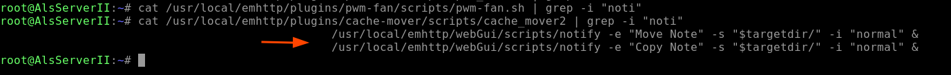

sorry still having a question to pwm fan and it seems noone else had for now.
I have set it up for CPU HDD HDD-extra
I can see HDD and HDD-extra in the log (plugin) . Not the CPU fan.
BUT: I get an email for every change the HDD fans do....
Sender:    Console and webGui login account
Topic:      cron for user root /usr/local/emhttp/plugins/pwm-fan/scripts/pwm-fan.sh
Text:       set fan to value 134
or:
Topic: cron for user root /usr/local/emhttp/plugins/pwm-fan/scripts/pwm_hdd_extra.sh
Text:  set fan to value 228
There is no log (in plugin) and no mail from CPU fan.. pwm2.... but I can control it.
So every 2 minutes there is an email from unraid.
In Unraid Notification settings there is email only selected for alerts...
But I should get alerts also on Telegram, but there is no notification for fan...
What do I have to disable?   Makes no difference if "syslog" is  yes or no or empty
Sorry if it is that simple and I only cannot see...
Mike
actually there is no unraid notifications included in pwm-fan ... just checked here as you confused me ;)
sorry, but i cant say what kinda notifications you have running, looks more like some watchdog over cronjobs which then is sending notifications ... whyever ...
and there are no notifications in any ...
i wanted to add them maybe, but as this would be way too much spam ... i dropped it.
as sample, cache mover has notifications ...
sorry, but cant help here

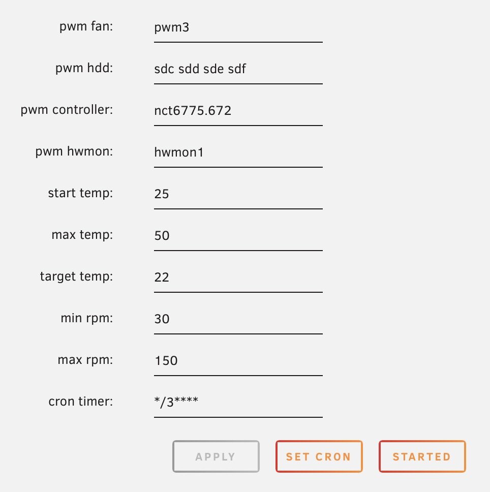

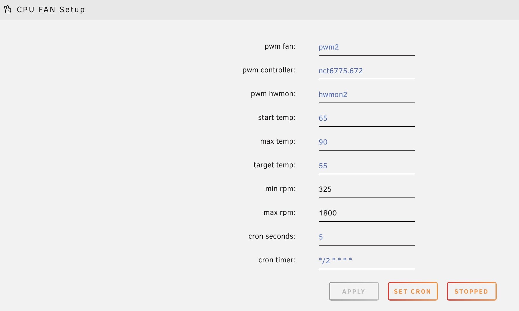

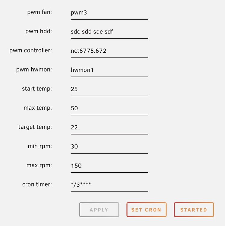

Hello alturismo,
First of all, a big thank you for your pwn-fan plugin and the effort you put into its development!
I just started using Unraid yesterday and am still getting familiar with it. My system consists of an ASRock N100M motherboard on which I’ve installed two Noctua fans (1x CPU and 1x HDD). I successfully installed the plugin, but I’m unsure if there’s anything else I need to consider to ensure everything runs correctly. For example, do I need to configure anything additional to enable the plugin to autostart?
I’ve also entered the minimum and maximum RPM values provided by Noctua. Is that fine, or is there anything specific I should keep in mind?
Thank you in advance for your help, and once again, great work on the plugin!
Hallo alturismo,
zuerst einmal ein großes Dankeschön für dein pwn-fan Plugin und die Arbeit, die du in die Entwicklung steckst!
Ich bin seit gestern neu bei Unraid und noch dabei, mich einzuarbeiten. Mein System besteht aus einem ASRock N100M Mainboard, auf dem ich zwei Noctua-Lüfter installiert habe (1x CPU und 1x HDD). Das Plugin habe ich erfolgreich installiert, aber ich bin mir unsicher, ob ich noch etwas weiteres beachten muss, damit alles korrekt läuft. Muss ich zum Beispiel zusätzlich noch irgendetwas für den Autostart des Plugins einstellen?
Außerdem habe ich bei den Minimal- und Maximal-Drehzahlen einfach die Werte von Noctua eingetragen. Ist das so in Ordnung, oder gibt es da etwas Spezielles zu beachten?
Vielen Dank vorab für deine Hilfe und noch einmal großes Lob für das Plugin!
I'm getting the exact same notifications over and over every time the cron runs. Doesn't matter if syslog is on or off in the plug-in settings. I've scoured through all the settings I can find and so far haven't found anything relevant. Any luck figuring out how to get these to stop sending over and over?

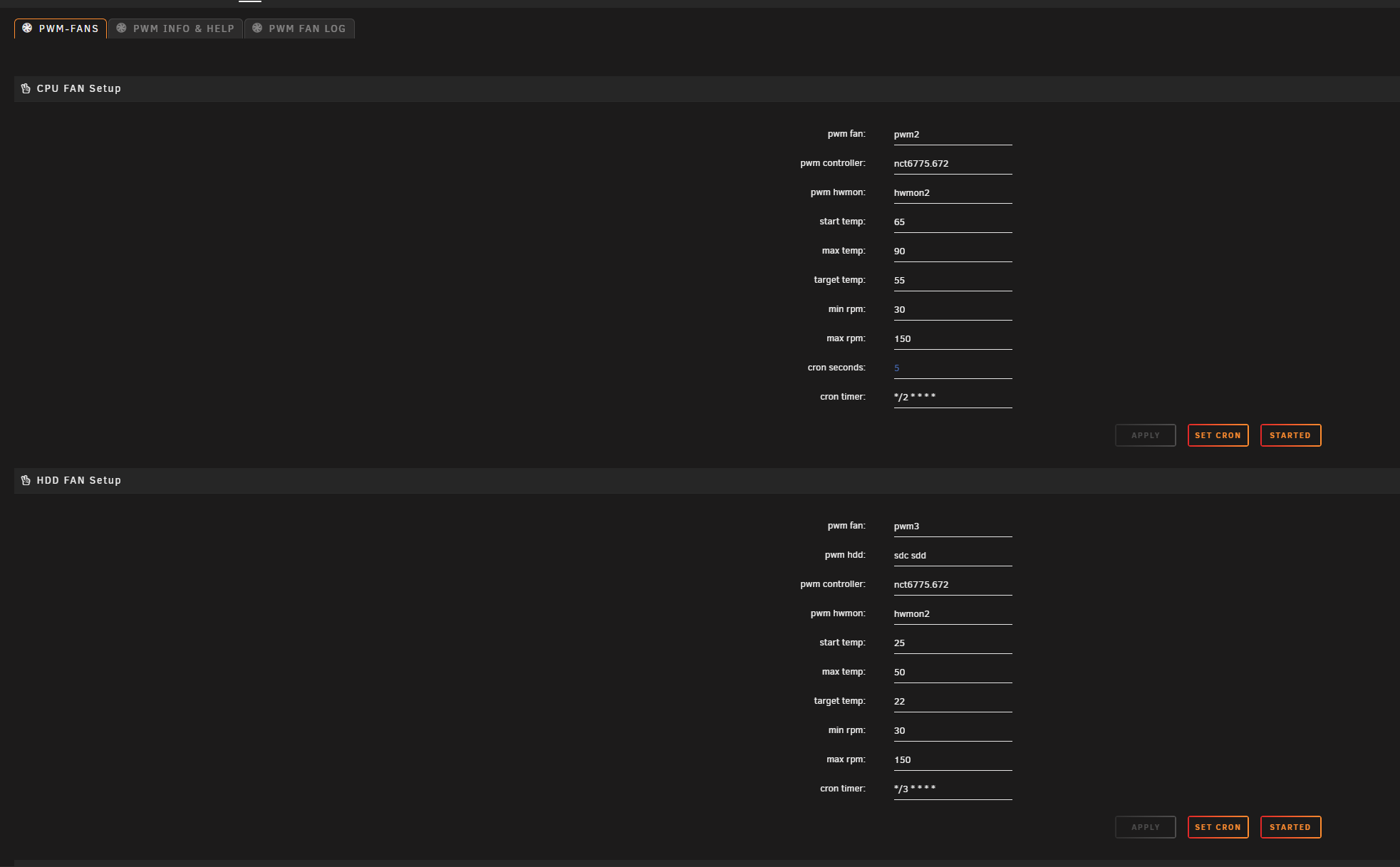

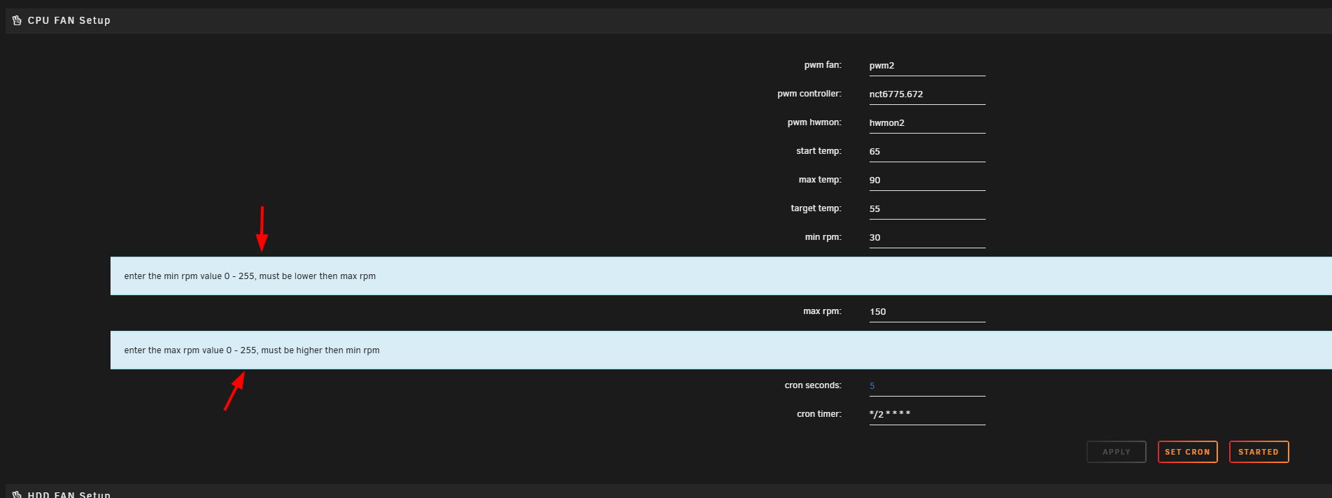

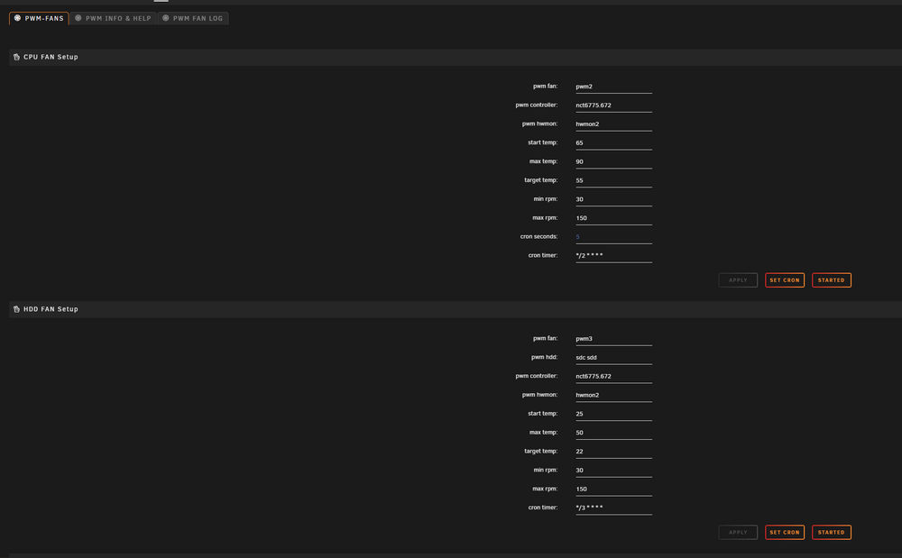

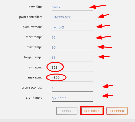

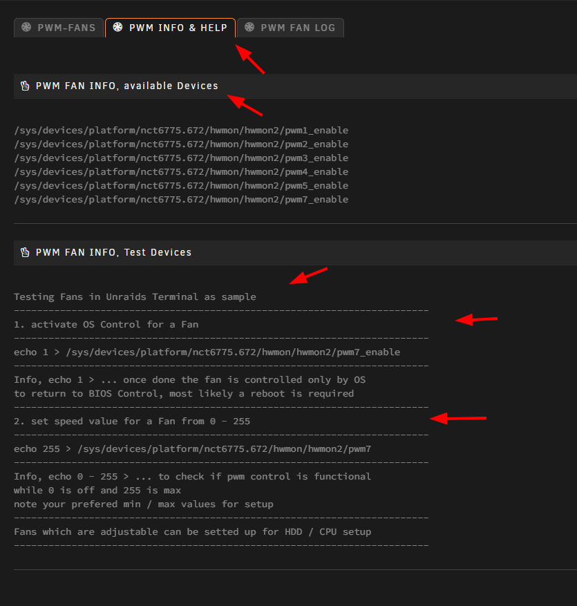

actually you didnt configured anything really ... sample
those fields are not configured from your side, the "light blue" are just samples what could be in there ...
and your rpm values are way off ...
when you mouseover slightly left from the setting name, there comes a "?" ... when you click it, it ll open a help for each field ...
also here
but as sample, here also on a asrock n100m, also noctua ;) my settings ... apply, set cron, thats it

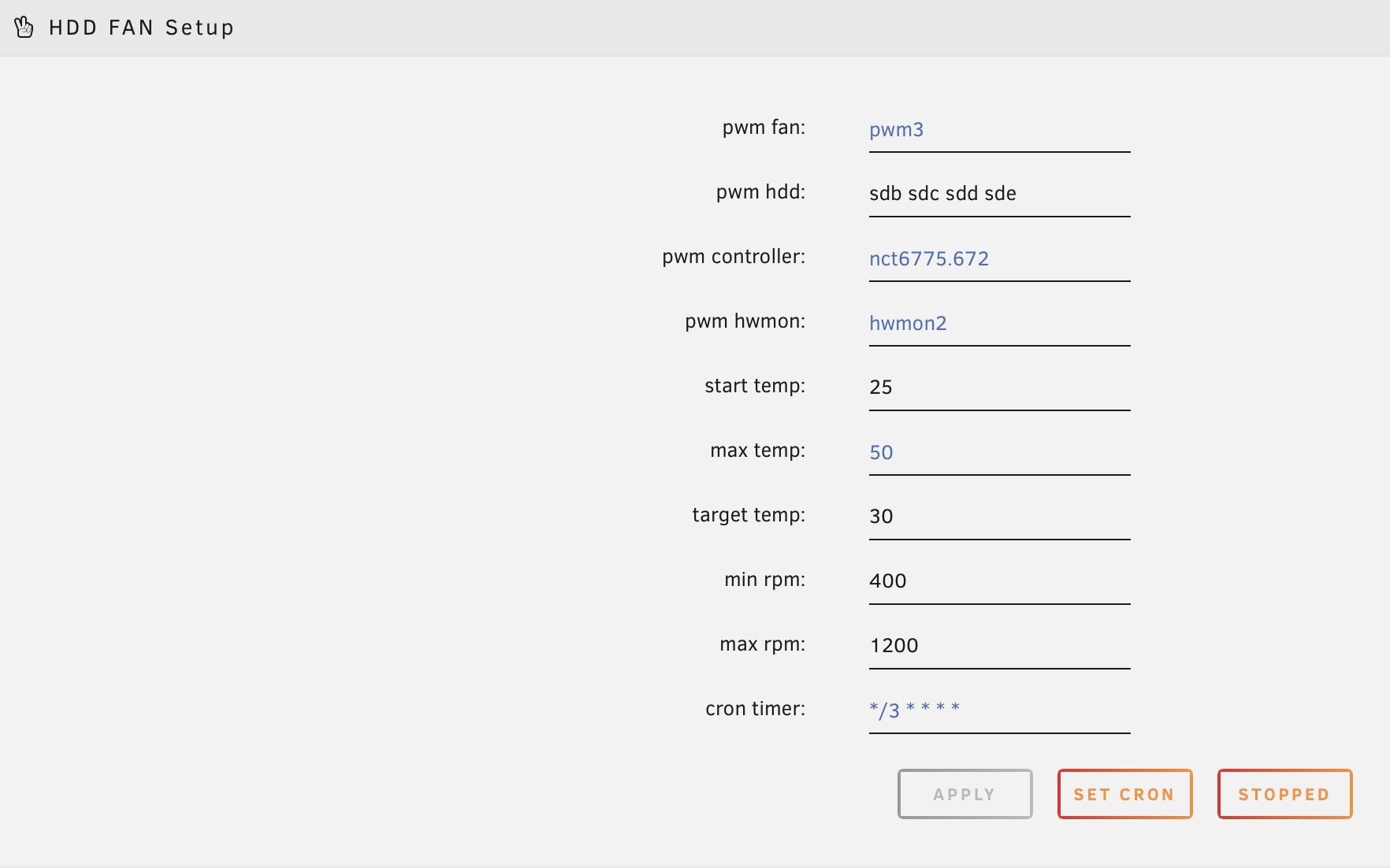

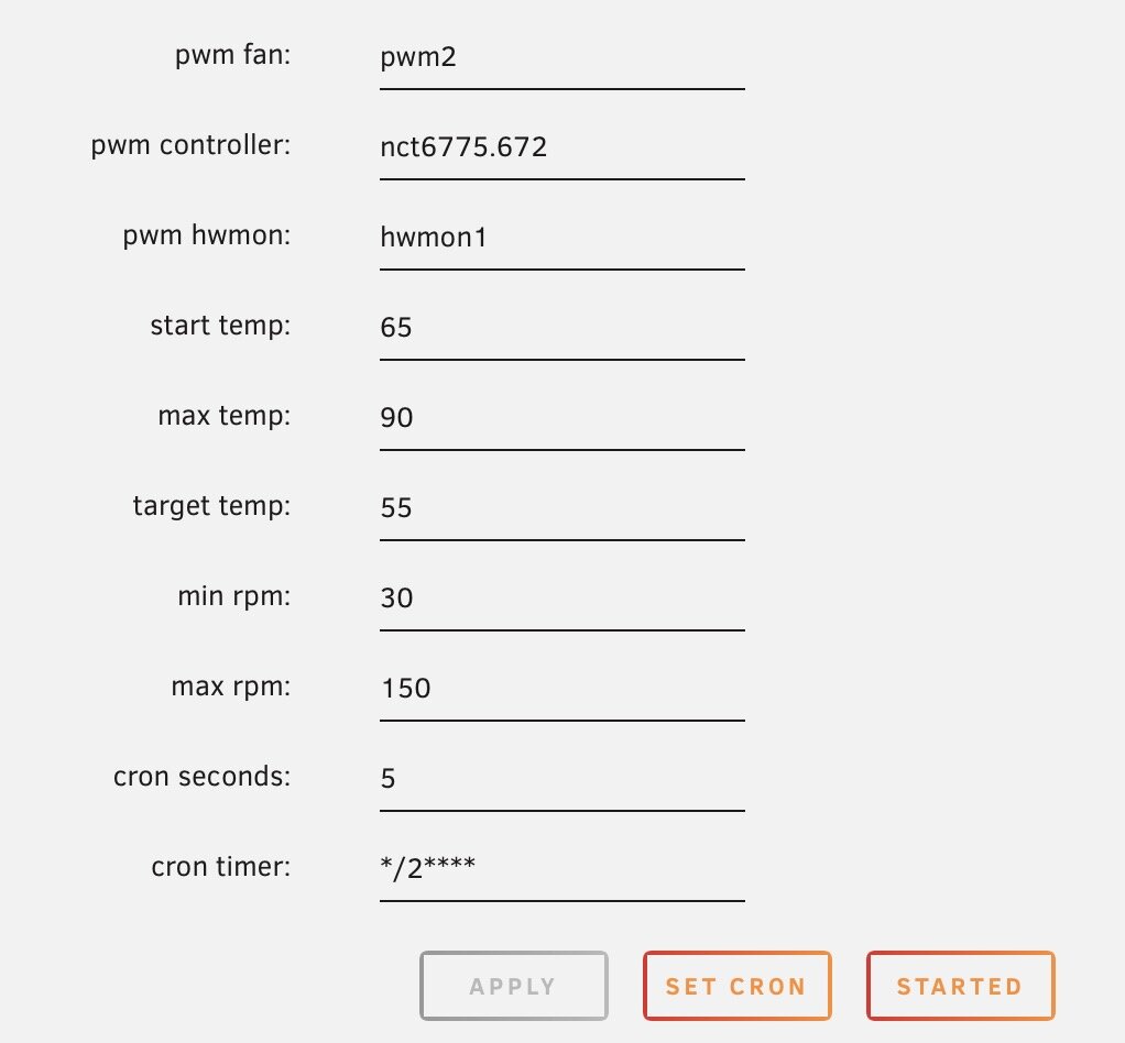

Thank you very much for your detailed response and help!
I have now largely copied your settings. The only differences are "hwmon1" instead of "hwmon2," as "hwmon1" is displayed under the PWM Fan Info, and the HDD drive designations — I have a total of 4. Is this correct?
Unfortunately, the plugin doesn't seem to work for me; I can't see any changes in the fan speeds (HDD Fan stays around 600rpm and CPU Fan around 400rpm), even when both the HDD and CPU temperatures exceed the threshold. Additionally, the log unfortunately remains empty. Can you help me somehow?
Edited by MRLDKR
Added RPM Speeds

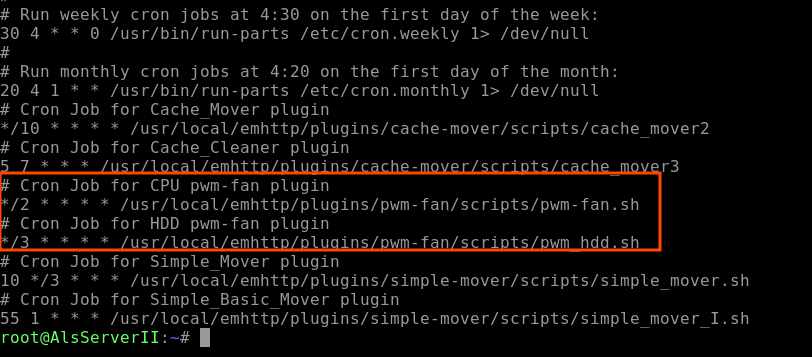

with this, well, your cron entries are failed ...
yours
*/3****
correct would be with spaces
*/3 * * * *
and if it works or not, when you check the help page i pointed out upper, you can test your fans manually
replace hwmon, pwm... with yours and try in terminal ... but may just start with fixing your crons ;)
Testing Fans in Unraids Terminal as sample
1. activate OS Control for a Fan
echo 1 > /sys/devices/platform/nct6775.672/hwmon/hwmon2/pwm7_enable
Info, echo 1 > ... once done the fan is controlled only by OS
to return to BIOS Control, most likely a reboot is required
2. set speed value for a Fan from 0 - 255
echo 255 > /sys/devices/platform/nct6775.672/hwmon/hwmon2/pwm7
Info, echo 0 - 255 > ... to check if pwm control is functional
while 0 is off and 255 is max
note your prefered min / max values for setup
Fans which are adjustable can be setted up for HDD / CPU setup

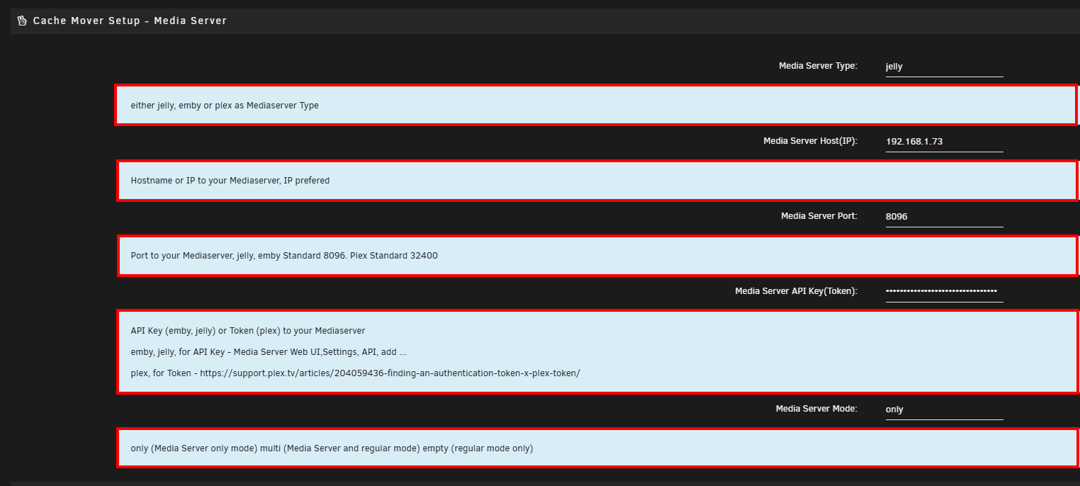

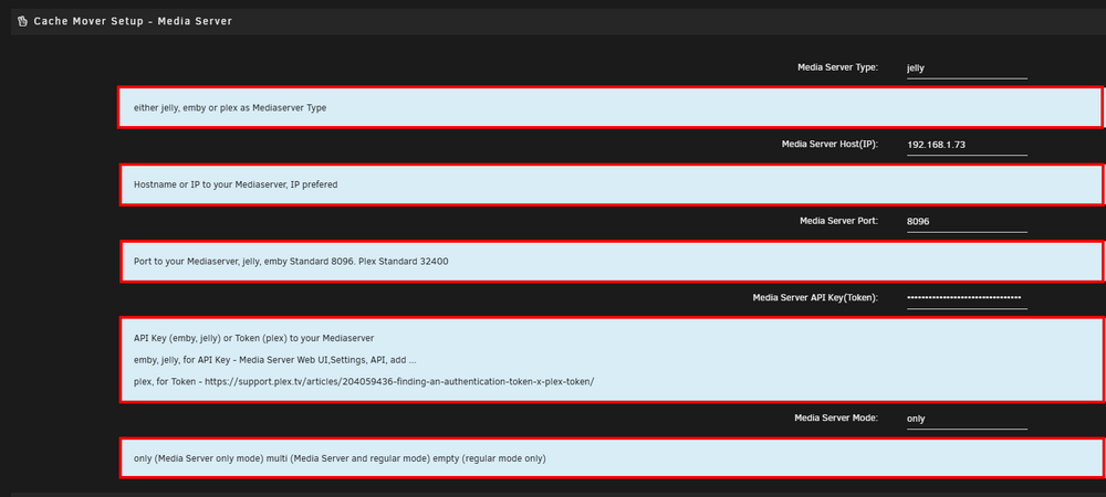

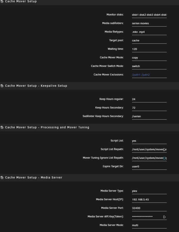

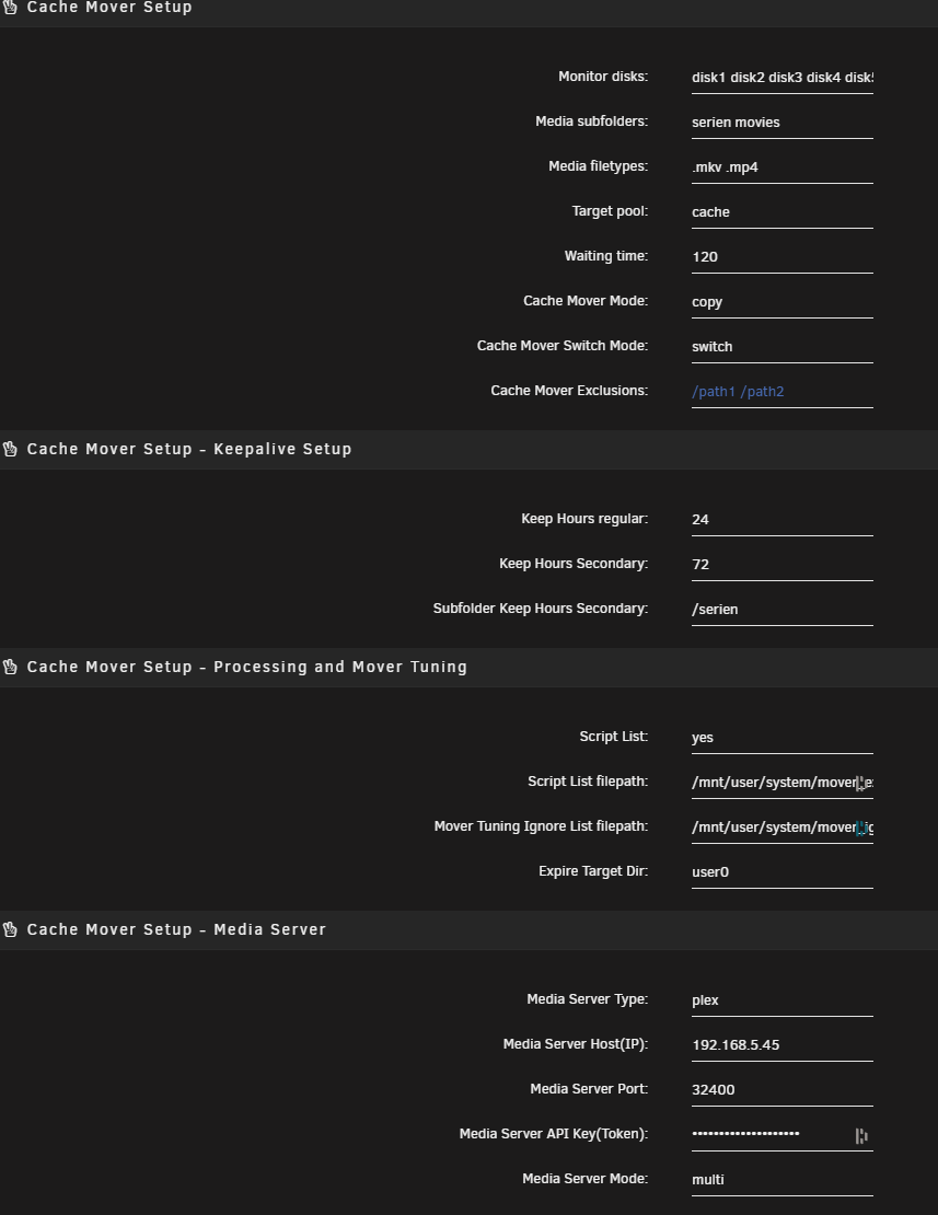

Cache Mover Update
see the extra part in the config page (here incl. opened help sections)
Media Server Mode:
off (or empty), will ONLY run regular mode like before ;)
only == will ONLY check open files from your Mediaserver's currently playback !!!
>> following regular rules (subfolder, filetype, exclusion, wait for double check)

Now that the Media Server option is available for Cache Mover, I thought I'd take another look at it. I have a scenario that you may not have come across. I've been collecting media for over 50 years now (yes, I'm old-AF). I've got over 750TB of media across all the different types - movies, tv, music, documentaries, concerts, etc. Alas with the unRAID array limited to 28 data drives, I eventually outgrew it and now have a split 'Media' folder.
My 2nd 'array' is actually a pool created using the mergerfs plugin. This pool uses an additional 28 data disks, all mounted using Unassigned Devices (UD) - they are mounted at /mnt/disks/<diskname>. As the Cache Mover plugin only looks at the disks for the main unRAID array, I couldn't previously watch for anything opened on the mergerfs pool. Because of this I never bothered with trying out the plugin.
The other aspect that makes my setup unique is that I run my mediaserver containers for Plex and Jellyfin on another unRAID system - a N100 based uSFF (Beelink EQ12 series). The media itself all resides on the main unRAID and the media servers access it via a 1Gbps network connection with the shares mapped under UD. Now that the Media Server option has been added, I'm taking another look at using the plugin.
My first issue is where to install the plugin. As I'll be using the Media Server option only, I suspect it should be installed on the N100 system. But as the media is on the other server, it looks like Cache Mover will try to copy the playing media from the other server to the only drive in the N100 system - a 512GB m.2 SSD which is just over half full with all of the Plex and Jellyfin config/metadata folders. That's assuming it works at all with the actual media files being located on the other server.
As I'm limited by both the size of the m.2 SSD and the 1Gbps NIC in the N100, it can affect the files that are being played. I can upgrade the m.2 SSD to something larger or even add a SATA SSD, but there's nothing I can do about the 1Gbps NIC. Well, I could try a USB to 2.5Gbps or 5Gbps NIC, which would also require a switch upgrade so it's a little costly.
Ideally I'd like Cache Mover to run on the main NAS as it has a larger 4TB cache pool for the temporary file moves. But with the split media folder between the unRAID and mergerfs arrays, I'll still only be to use the plugin with the media on the unRAID array. You state that even when using Media Server mode, it still requires setup for the array disks.
Any thoughts on how this scenario might be able to utilize the Cache Mover plugin? I understand if its too much work to implement a solution that would support my split arrays. Certainly there are likely only a few users with a setup similar to mine.  I could actually move the 28 data disks in the current unRAID array to the mergerfs pool, so all 56 disks under one array. But they still don't mount under /mnt but rather /mnt/disks.
Regardless, thanks for your contributions to the unRAID community!

46 minutes ago, alturismo said:
about your question, actually the plugin should work on the main NAS while checking the "remote" Plex, here its more a point how your Librarys are inserted into Plex ... and also, may easiest to run a 2nd instance on your 2nd Unraid if its all working as expected like i think ?
I do run a 2nd instance of Plex on the Main server (AnimNAS). That instance is for testing new releases of Plex before implementing on the AnimMini system. It is configured with a small subset of my media to use for testing. I don't run a 2nd instance of Jellyfin as it's not my main media server app - just a backup for troubleshooting when Plex refuses to play a file, although it does index the exact same folders for media as the Plex instance uses.
and with Plex there shouldnt be any issues, while jelly could make issues with "loosing" files, that was actually the reason for this update ... i ll make some tests here with a scene like this ...
Plex > Server1
Array/cache > Server2 (plugin 1)
Array/cache > Server3 (plugin 2)
but please let me know how your libs are setted up, /mnt/disks/...
cause when i think about it, Plex on 1/ should just access /mnt/remotes/server1 ?
My layout is the same on both the unRAID and mergerfs arrays on the main unRAID system (AnimNAS). Here are examples of 3 folders:
unRAID:
/mnt/user/Media/Movies
/mnt/user/Media/TV
/mnt/user/Media/Music
etc
mergerfs:
/mnt/addons/Media/Movies
/mnt/addons/Media/TV
/mnt/addons/Media/Music
etc
Below is the Main tab showing the layout of the AnimMini server that runs the Plex and Jellyfin containers. No media is stored on this machine unless Plex or JF are transcoding, and those transcoded items are never kept. You can see in the UD section there are mappings for 3 shares from the main unRAID.
Mountpoints:
AnimDL_Media is the mergerfs pool/array - 256TB of media
AnimNAS_Media is the unRAID array - 494TB of media
AnimNAS_tempstore is a share for my nightly backups of appdata (the Plex and Jellyfin config/metadata folders) but no media is stored in this share.
AnimMini is the Beelink EQ12 running an unRAID legacy Basic license used only for the Plex and Jellyfin Docker containers. I do this as the N100 has the same media encoders as the Intel iGPU on the 12th through 14th gen Intel CPUs so it's an excellent device for when transcoding is required. I play everything locally via Direct Play myself, but the Plex and JF instances are shared with family who occasionally need to have content transcoded (they all use Firesticks whereas I use a 2019 Nvidia Shield Pro).
As for layout of the mergerfs pool, the 28 disks are labelled DLPoolxxx, so they appear like this:
/mnt/disks/DLPool001
/mnt/disks/DLPool002
/mnt/disks/DLPool027
/mnt/disks/DLPool028
MergerFS combines these individual disks just like shfs does for the unRAID array of 28 data disks. The entire mergerfs pool is mounted at /mnt/addons. Both AnimNAS and AnimMini are running unRAID 7.0.0 stable as of yesterday.
Let me know if you need more info or clarification. Thanks!

Hello,
I updated to the new version. Now I'm getting this behavior.
an 11 17:52:03 Jarvis root: cache-mover: move / copy /data/serien/Raumschiff Enterprise - Das nächste Jahrhundert (1987)/Season 01/ to /data/serien/Raumschiff Enterprise - Das nächste Jahrhundert (1987)/Season 01/
Jan 11 17:52:03 Jarvis root: cache-mover: sending incremental file list
Jan 11 17:52:03 Jarvis root: cache-mover: sent 50 bytes  received 12 bytes  124.00 bytes/sec
Jan 11 17:52:03 Jarvis root: cache-mover: total size is 0  speedup is 0.00
Jan 11 17:52:03 Jarvis root: cache-mover: grep: Invalid range end
and its not copying
may please a scrrenshot from your settings, source and target are the same here ...
here we go
