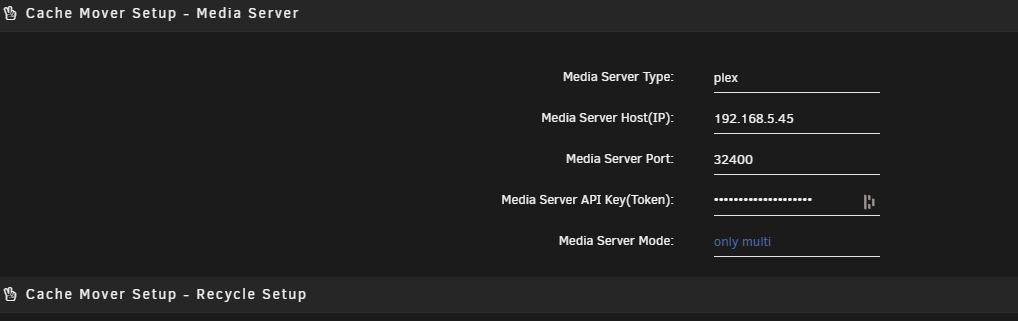

I switched just now to "multi" before I was trying the "only" mode for Media Server Mode:
with "multi" ist working like the old version

3 minutes ago, simatra said:
here we go

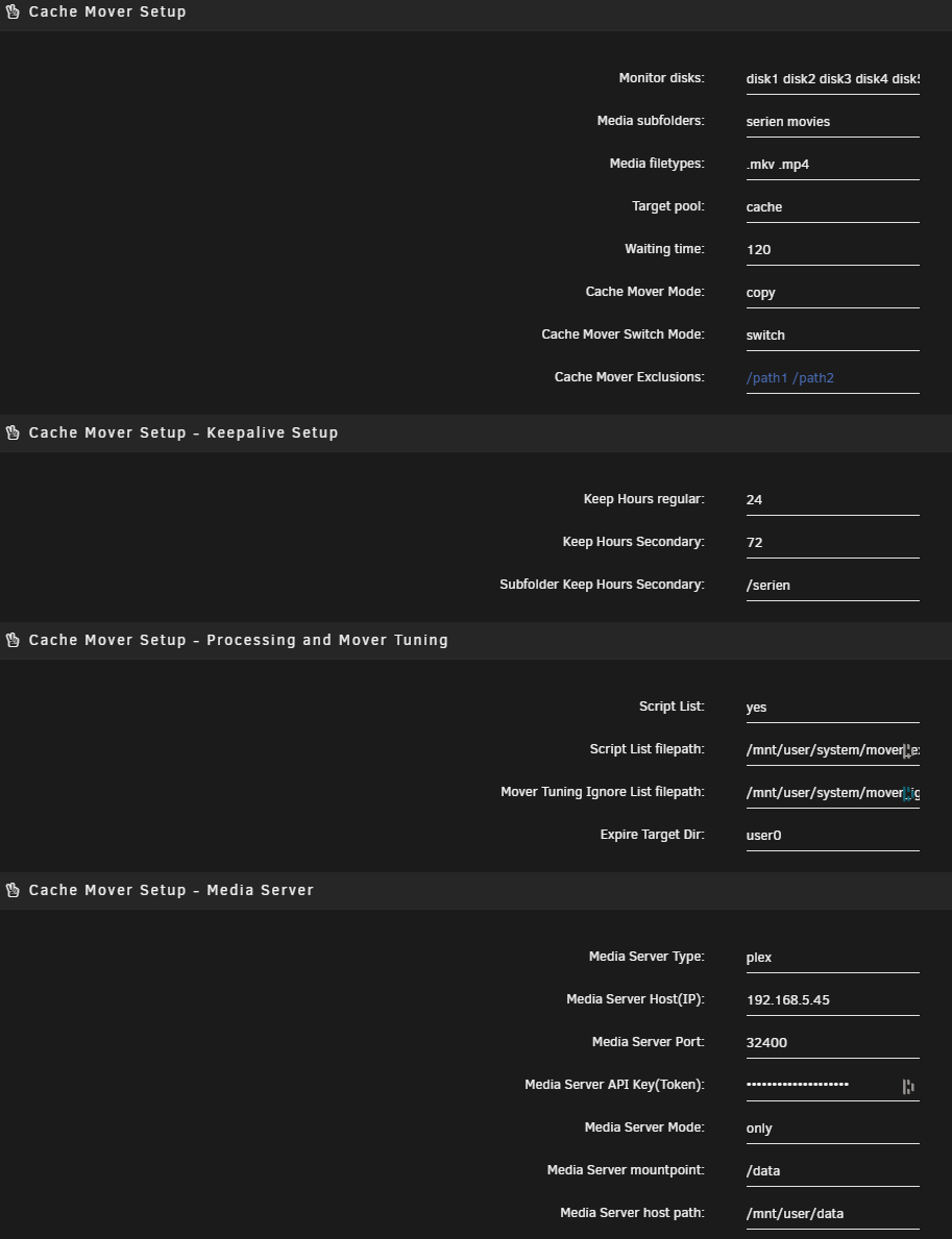

ok, with this setup you shouldnt use Mediaserver setup ... good point, i ll add to infos, i ll add a function to "rewrite"
you have not a 1:1 setup, so you use /data as mountpoint in plex ...
so plex is reporting a path which doesnt exist in Servers point of view ...
update will come, for now, please disable multi or only, wont work, regular mode should work anyway on plex anytime.

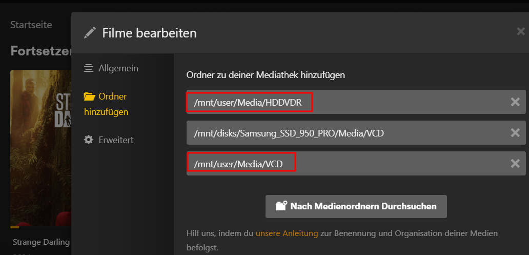

right now the plugin will only see the Media folder at /mnt/user/Media, not the folder at /mnt/addons/Media.
actually not, you "could" setup anything actually as its not bound in any way ... but its a matter of "the end"
the success feature is that the mediaserver will use the cached ssd file instead the array disk file ....
so, now for Plex, sample, a media file is located at /mnt/user/Media/movies/some movie/movie file.mkv, which is either a cached ssd (primary) or array disk (secondary) ... now, when i switch in background from lets say ../disk2/...file.mkv to ../cache/...file.mkv ... while playing it doesnt matter, file usage will switch and cache ssd will be used, now once you stop, pause, next episode, ... plex will again look at /mnt/user/Media/... and file should be now located on a cache ssd drive (promary) and also then we have a success ...
the plugin actually can move from > to anywhere, doesnt matter at all ... but the usage is the point, how can Plex as sample access the files from "somewhere" then and doesnt open the /mnt/user/... file, there is the point.
sample when i test here "wild", as you see ... also some pool disk ...
Jan 10 20:55:33 AlsServerII root: cache-mover: move / copy /mnt/disks/Samsung_SSD_950_PRO/Media/VCD/Atomic Blonde (2017)/ to /mnt/cache/Media/VCD/Atomic Blonde (2017)/

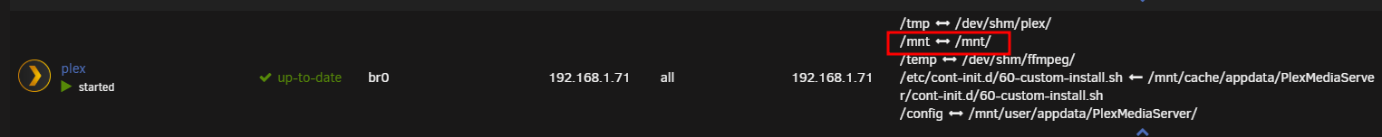

a 1:1 mount ... then we dont have to rewrite, rethink pathes depening on point of view (host or docker)
sample
then we have a 1:1 plex or host
so /mnt/user/Media/... is the same on Host and Plex
your setup is Plex Point of view /data/..... so we have to rewrite always, no big deal, i already implemented this in my ffmpeg transcoding plugin ... even i dont need it anymore, but i also had /date or /media ages ago ;)

would this be clear enough then ?
so, depending on your mountpoint, i assume something like this in your Plex setup
/data <> /mnt/user/Media
then you would add them like the blueprints ...

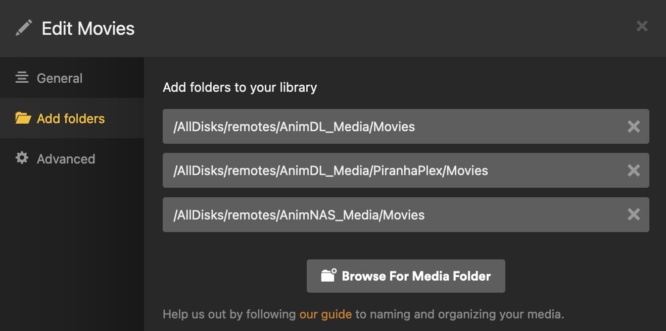

Some more info that may be helpful:
As my unRAID array is full, I no longer use mover. So for example, the share Media has a primary of cache (4TB SSD pool) but no secondary storage. When Plex or JF on AnimMini access /mnt/remotes/AnimNAS_Media, it still sees any files at /mnt/cache/Media merged with /mnt/user0/Media. shfs is still merging the paths even though secondary storage is not set.
When adding new media, it goes direct to the cache pool. The mover tuning plugin was causing some issues so I now have it turned off (set 'Disable Mover running on a schedule:' to yes). There's been a fork of it and a new maintainer (Reynald) so I have installed it, but it's still disabled since the array is full. I now manually move new content from the `cache` pool to /mnt/addons/Media/<subfolder> where <subfolder> is Movies, TV, Music, etc.
For the mergerfs pool, there is no concept of primary vs secondary storage as /mnt/addons is not merged by shfs. I have added the /mnt/addons/Media/<subfolder>` path to my libraries, at /AllDisks/remotes/AnimDL_Media/<subfolder> as shown in this screenshot for the Movies library. The AllDisks path is an added container path mapped to /mnt on the host. I add the AllDisks path to any of my containers that need access to disks/shares.
The middle path (containing `PiranhaPlex`) is the subset of data I use for testing with the Plex instance on AnimNAS. This allows it to be used for testing as well as having the data indexed in the Plex instance I and my family use (on AnimMini). Similar is done for other libraries.

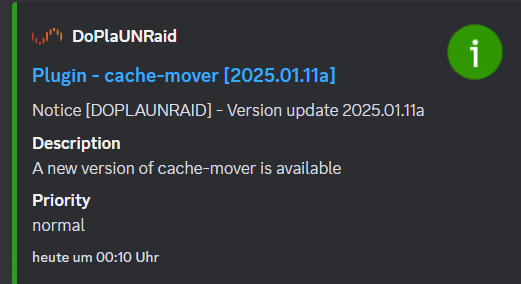

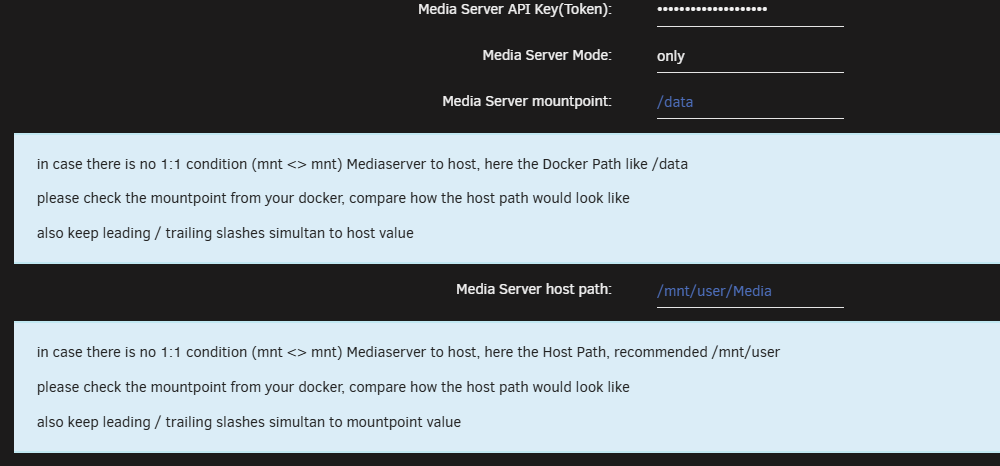

update pushed, couldnt test myself, let me know if it works, thanks.

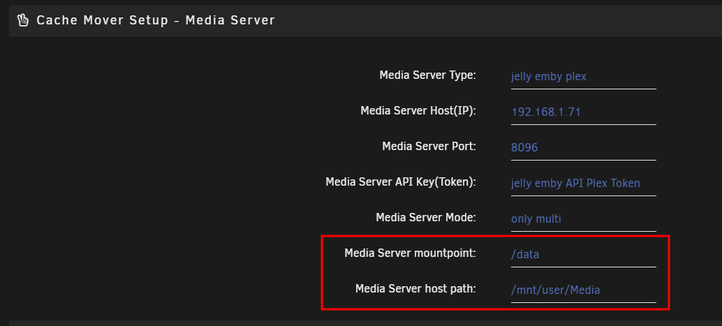

Yes this will work!
my Setup would be
Media Server mountpoint: /data
Media Server host path: /mnt/user/data/
I updated to 2025.01.11a  but I can't see that fields
Edited by simatra
on one of my test servers here
after update
may check in unraid console
cat /usr/local/emhttp/plugins/cache-mover/cache-mover.page | grep -i rewrite_source
when there is a return, its there ... may try refrshing browser
Version 2025.01.12 did the trick. It is working as intended. I'll keep you posted.
