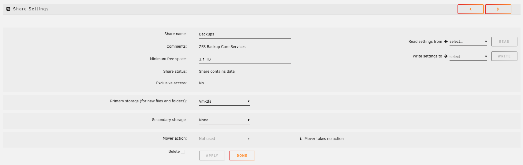

ok this sounds like a dataset was made in the main tab but may need share tab settings applied.
under share Tab click export
In share settings. Verify the primary storage:
then enables smb/nfs share/export setting
under smb:
SMB Security Settings
NFS Security Settings
if you edit something in share setting, click apply before moving or editing other things on the web page.

1 hour ago, Dragon99 said:
I just for some reason have no option to select the ZFS datasets as a storage location
You can only select the pool or array, the settings are per share, if that share is on zfs, by default it will be a dataset.
Okay but how do I put a share on a ZFS pool? I have no option to do so as far as I can tell.
You can see I have no shares for those datasets that were created. and when clicking add share you can see in my previous post I can only select array or cache. So I cant select to put a share on those pools.
So the question remains.
Edited by Dragon99
You set share up with the pool as the Primary Storage with no Secondary Storage set.
I am unable to select that as a option as shown in a previous screenshot.image.png.7d621af639148b74295b99bc9aae8c85.png

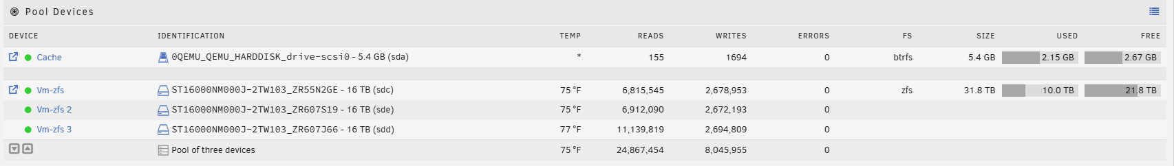

Cache is the only pool you have assigned, if you have more pools but are not assigned in the GUI, they cannot be used as part of the shares.
So, I managed to figure it out Perhaps I am out of practice with unraid as it's been a long time since unraid was my main NAS OS. (I keep the VM for the pure reason of testing and assisting others as needed. Main reason I was trying ZFS was to see if it was practical for a friend who just got new drives and is upgrading.)  For some reason and this is rather unclear from the Unraid dashboard (if the array is started at least which it by default is an on existing server) You have to first stop the array and then to create a pool that is completely separate from the array. You have to make sure to click onto this pool and set it as ZFS before starting the array even though you can create a ZFS pool via CLI while the array is running, and a pool separate from the array should have no direct impact on the array and on other OS at least could be created without having to take down your primary storage. A proper guide or docs regarding ZFS pool creations would be very handy in preventing these issues rather than having to rely on third party often outdated source and videos, but I at least was unable to find official documentation about using ZFS on unraid save the blog post which reads more as a add and information piece than a proper guide and how its implemented. https://unraid.net/blog/zfs-guide
On unraid things are expected to all be done from the GUI. Pools aren't really "separate" since shares are merged between array and pools, which explains why changing them requires stopping the whole array.
