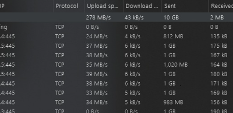

- send @ 280 MB/s, all data on unraid side sent over single interface eth0
- receive @ 360 MB/s - win 10 sends 245MB/s to 192.168.1.2, 115MB/s to 192.168.1.3
Looking on the unraid network I can see all data is sent over just 1 interface to the win10 desktop and capped at max speed of this  interface, 280 MB/s

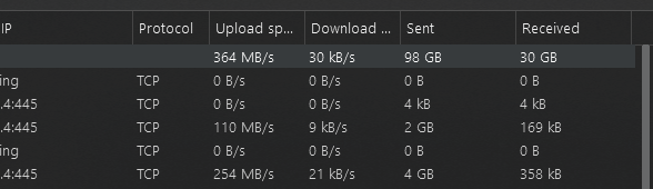

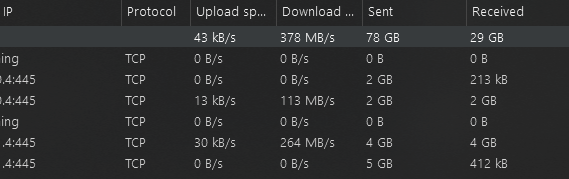

I was able to achieve full throughput for both send and receive by configuring a new subnet, while keeping my existing synology setup to work being:
configure the 2nd interface to have a different subnet
configure synology nic2 to 192.168.2.2/24
configure unraid nic2 to 192.168.2.4/24
configure win10 desktop nic2 to 192.168.2.4/24
downloads from unraid cache:
uploads to unraid cache:
