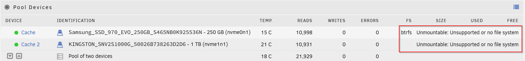

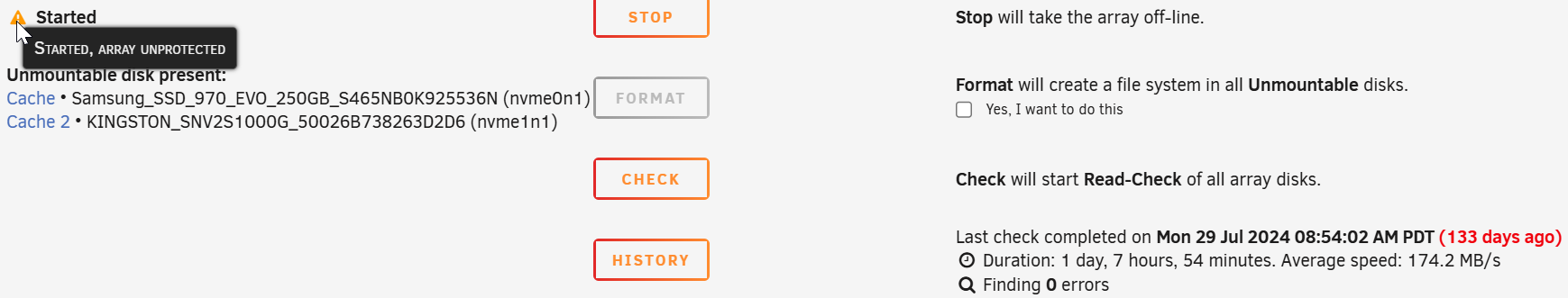

Hi.
I am still a noob. I shut down my Unraid server end of July, because of houserenovations, and fired it up again today, and I got shot in the face by the following. I am sorry  that I really don't understand how this happened at all. Only think I can think of is that I moved the server physically from one location in the house to another. But I have not touched anything, and it seems everything is alright on the inside.
Can anybody point me in the right direction to help myself here?
PS: Both cache disks are quite new, before this happened, as I setup Unraid fall of -23.

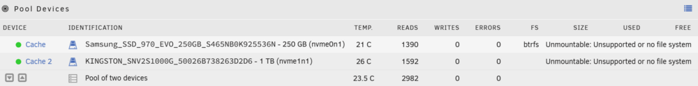

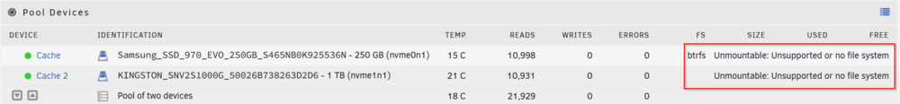

  • Try rebooting to see if those go away.
  • Yes, just copy the data, then re-format.   You can replace the device after the backup and before re-formatiing.
  • Thanks alot for your time and help @JorgeB. It seems like all is up and running again now. I am very very happy. Hopefully I get new ram sticks also, and then I am good to go again. Merry Christmas!
Type:
btrfs rescue zero-log /dev/nvme0n1p1
Then restart the array, but even if the pool mounts post new diags because there may be other issues, since btrfs is also detecting data corruption.

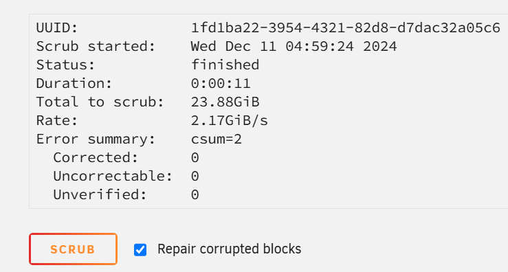

Regarding the pool, run a correcting scrub and post the results.
Should I remove thoose cables to, or can I just leave them now that I removed the drive?
Scrub Result (I did not choose to correct anything)
UUID: 1fd1ba22-3954-4321-82d8-d7dac32a05c6 Scrub started: Wed Dec 11 04:59:24 2024 Status: finished Duration: 0:00:11 Total to scrub: 23.88GiB Rate: 2.17GiB/s Error summary: csum=2 Corrected: 0 Uncorrectable: 0 Unverified: 0
If they are not connected to any drive, you can leave them for now.
Run a correcting scrub.
Seem like something is "Uncorrectable"... I did a reboot after and took a new diag report.
UUID: 1fd1ba22-3954-4321-82d8-d7dac32a05c6 Scrub started: Wed Dec 11 11:21:57 2024 Status: finished Duration: 0:00:09 Total to scrub: 23.88GiB Rate: 2.65GiB/s Error summary: csum=2 Corrected: 0 Uncorrectable: 2 Unverified: 0
tower-diagnostics.zip
Look in the syslog for the corrupt files list after the scrub and delete them/restore from a backup, then another scrub to confirm no more errors.

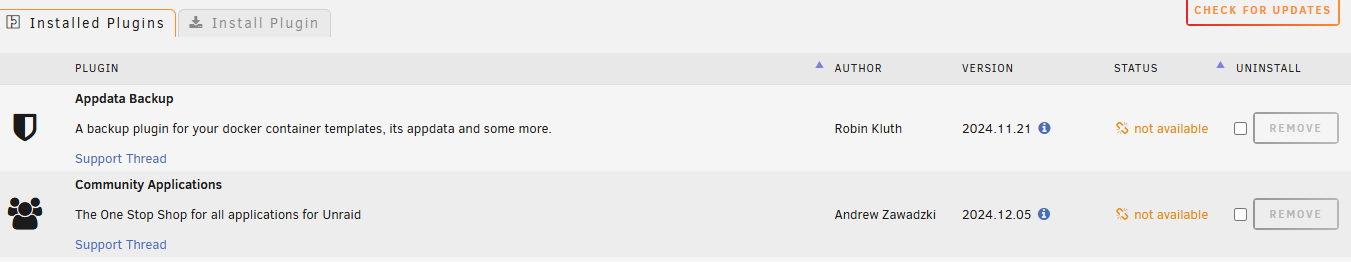

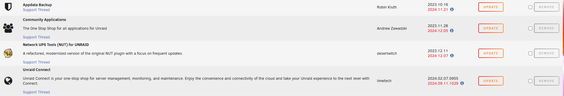

There are plugins that need an update, but I don't know if it is safe to install plugins before dockers is up and running:
Plugins are independent of docker containers so I would recommend updating them.
I did update them, but it says "not available". Still at least I can see the NUT plugin is working...image.thumb.png.b6650508f8adabb4c5dd848c49d4c477.png

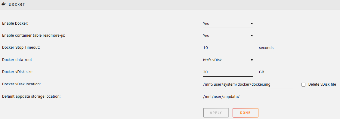

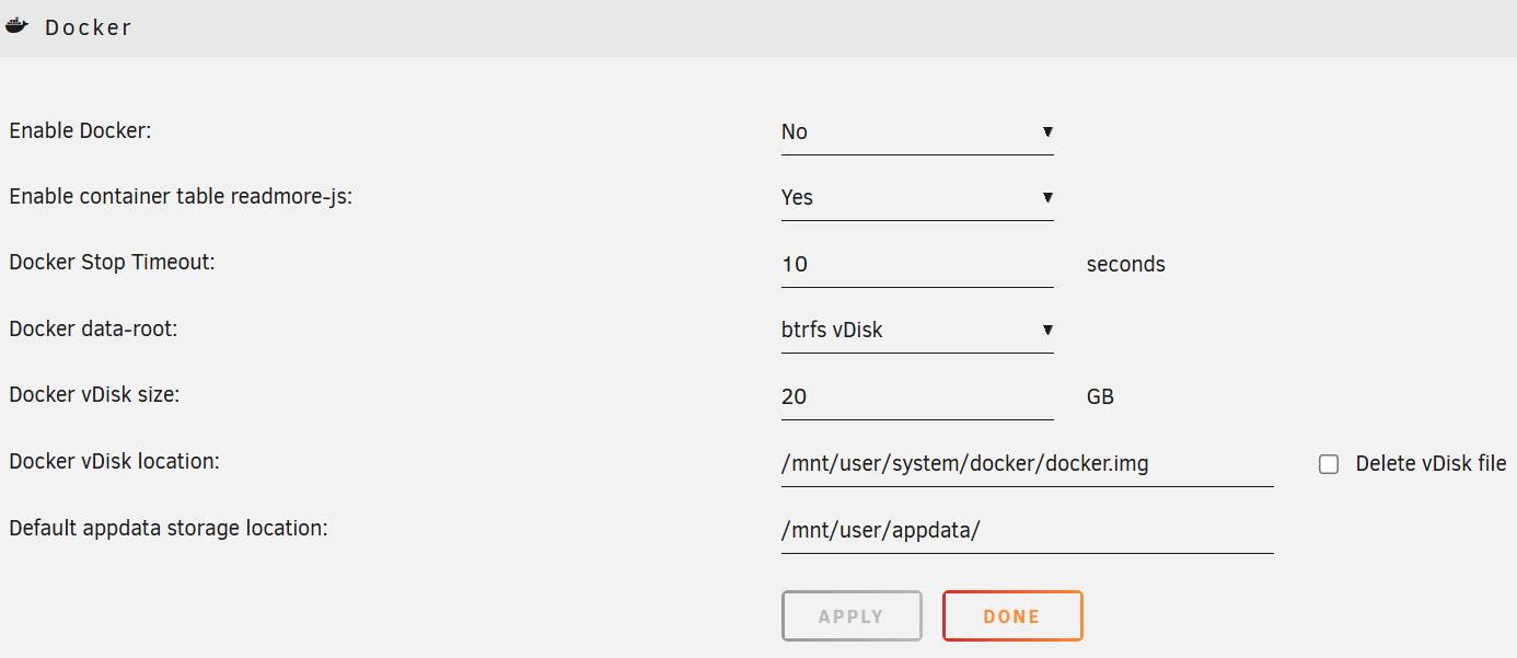

This is my Docker settings:
I will certainly try this.
Just one question before I continue. In the docker settings this is what it looks like now, I put no on "enable docker".
Notice the vDisk location.
I find the docker file at 22,5GB in disk2/system/docker which is a array disk. Is the directory location the same in the settings? When I choose the path manually I get to /mnt/disk2/system/docker/docker.img
Just wondering if the path somehow has got distorted? Should I try to point it directly to that path myself?
If so can you verify that the appdata storage folder is correct?
Also I notice the Docker vDisk size is set to 20GB while mine is actually 21,5... Could this be an issue?
Edited by tormi

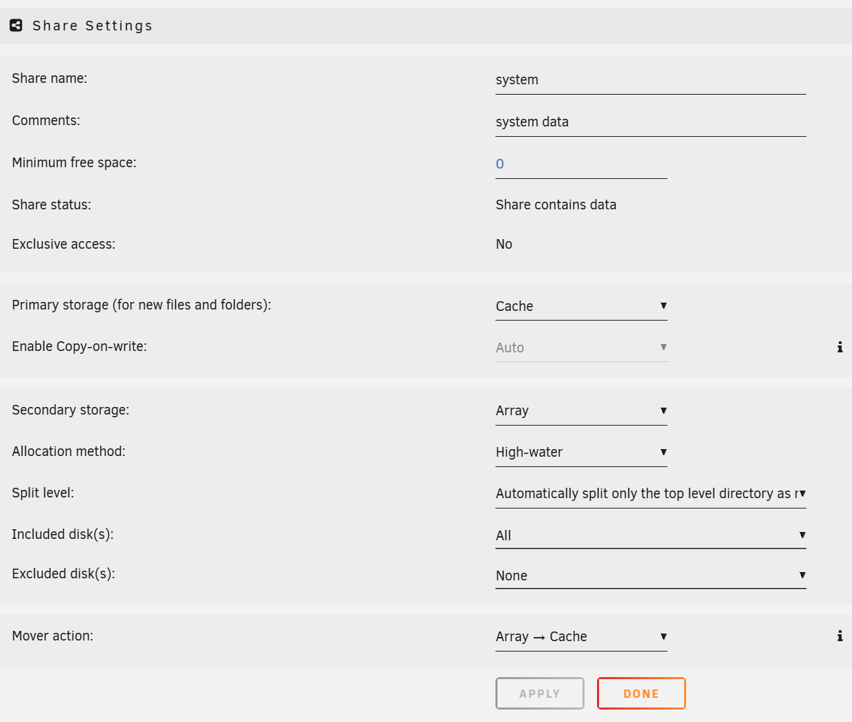

Since that location is part of the /mnt/user location then nothing wrong with that.   Ideally, however, you want all of the 'system' share on the 'cache' pool for best performance, but running Mover with the Docker and VM services disabled should achieve that.   After that is done you could set the 'system' array to be cache only.
Likely the difference between displaying the size in decimal and binary units.

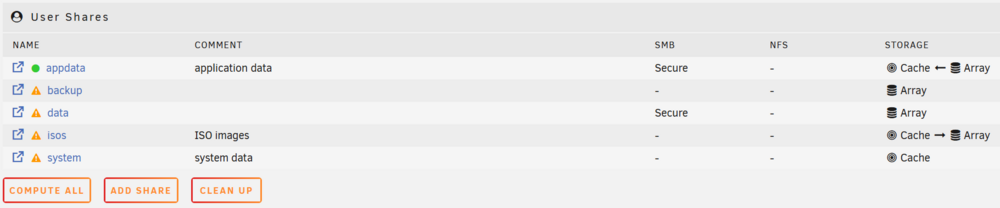

So all I do is click the "move" button at the "Main" tab, then I set the "System" array to cache only. After this I rebuild the docker container if needed?
Do I need to make any path alterations in any other places?
This is the settings for the "system" data btw:
Should I not include a secondary storage?
Edited by tormi
Yes.
Paths should be fine.
