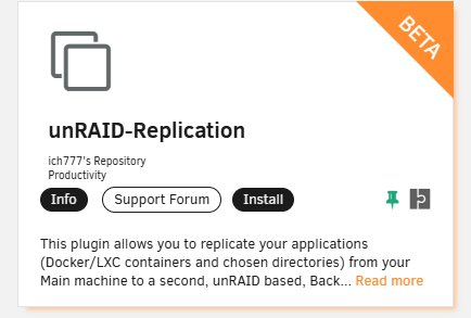

ICH777 recently made a plugin to sync data and maintain setting between 2 unraid systems.

@bmartino1 Thanks for the responses.
That plugin looks interesting but doesn't show up for me in Apps.  Maybe because it is a beta.
