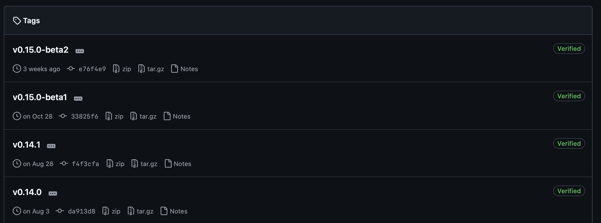

I believe that I need to edit the Repository: line in the docker config in unraid which currently reads this:
ghcr.io/blakeblackshear/frigate:stable
and change to:
ghcr.io/blakeblackshear/frigate:v0.14.0
Assuming I want to go to 0.14.0.

good guess, but leave out the "v".
ghcr.io/blakeblackshear/frigate:0.14.0
should do what you want. give it a try (cant harm anything, you can always go back to "latest")
0.14.1 was a maintenance release, basically bug fixes - "This is a maintenance release for Frigate 0.14 that includes bugfixes as well as performance and stability improvements."
0.14.0 had some major breaking changes.  Changelog can be found here: https://github.com/blakeblackshear/frigate/releases

Thanks - I was able to step back but it doesn't seem to be the issue so far.  I could go back pre- 0.14.0 but that would be a last resort
