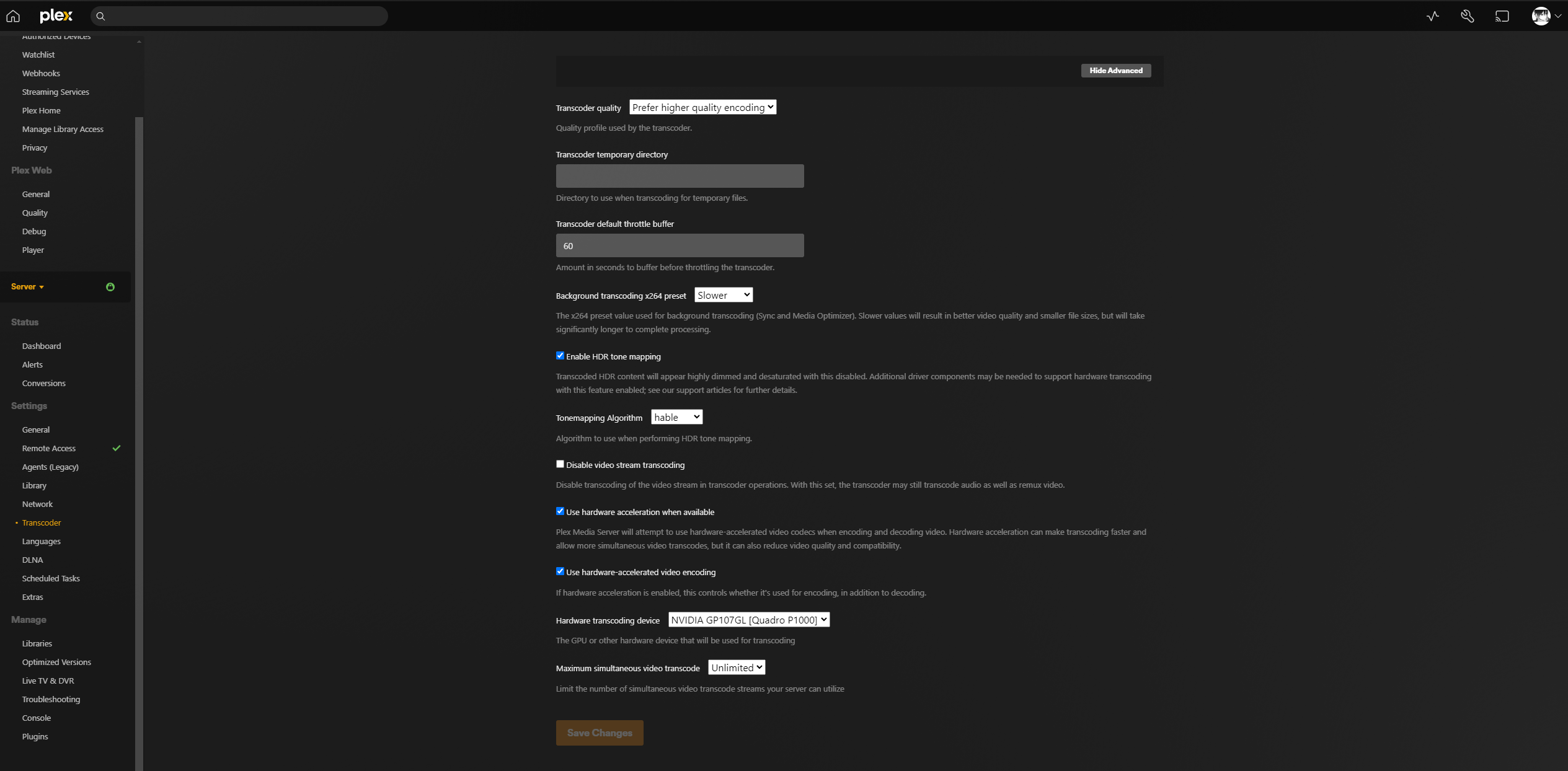

So I noticed yesterday that my gpu transcoding for plex is not working anymore. I cant exactly say for how long but it worked like 2 weeks or so ago and I didnt change anything besides updating plugins/docker regularly. I also set up sonarr and radarr recently.

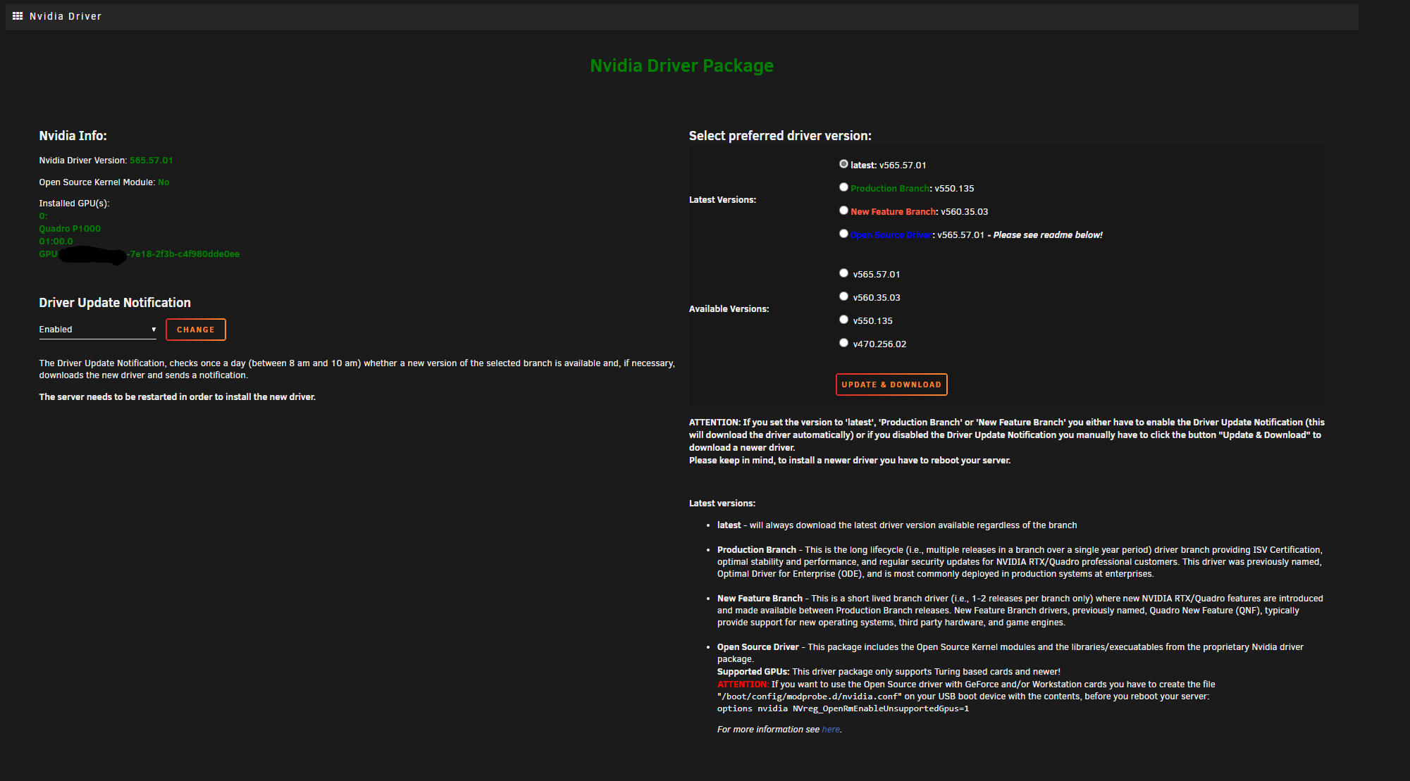

reinstalling nvidia-driver plugin from ich777

switch the settings within plex off and on

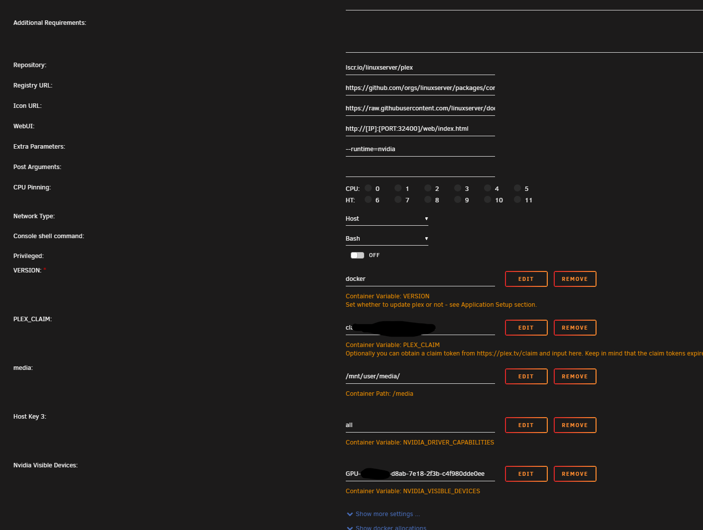

I'm using the plex docker from linuxserver with a lifetime plex pass, a quadro 1000 and I'm on unraid 6.12.14 now.

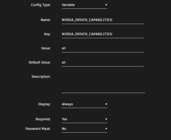

the driver need to be int he plex docker itself as well. I use linux server plex docker...
Nvidia dropped support for pascal cards... Since unraid sees the card you may be able to pass the nvidia device with this extra parameter.
and template options:
then in plex select the card and apply settings

I did had it set up like that with those parameters again (expet the --device...). Found a solution to my problem now luckily. Thanks for the help anyway!!
