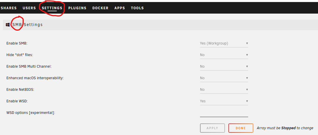

Did you go here and enable SMB?   (Most Unraid users will want this setup configuration.)
