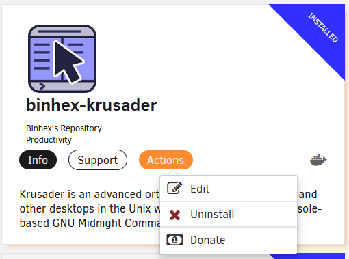

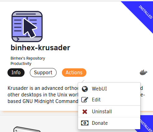

I've installed a few apps that have WebUI's - binhex-krusader, binhex-deluge and Firefox. I haven't quite uncovered a pattern but the WebUI option under "actions" disappears at random, it seems.
There's one solution that works every time: Editing the preferences and changing the Network Type. It doesn't matter to what - if it's currently at "Host" then use "Bridge" or "Custom" or vice versa.

Can you post a screenshot, not seeing what you mean.
The WebUI menu item disappears
image.png.41a55102ad70b32b114b820da728ffc5.pngimage.png.a033cd6025d70e7976d4fb4aec8ba424.png
Do you still have the WebUI link in the dashboard and Docker pages? If so it's likely a problem with the CA plugin only.
The typical place to get to a container webGUI is from the Docker page, if the problem is only with the CA page you should post that here:

I have only a few days of experience with Unraid and I think I figured out why I couldn't access the WebUI. I had no regard for whether the apps were running or not. I intuitively regarded clicking on "WebUI" as a way of starting the app and displaying its GUI in the browser.
As far as I can see now, if the app is actually started, the WebUI is also selectable from the "actions" menu button.
I also were not aware that the WebUI button were available from both the Dockers tab and the Main tab apart from the Apps tab where I had found it. Clicking the word and clicking the icon leads to different results and is maybe not the most intuitive design.
I'll observe again of course, but I think this is probably the explanation for the randomness in the availability of the WebUI function. Sometimes I had the docker app running and sometimes not. The server is brand spanking new and I'm not using it "in production" yet but merely experimenting.
