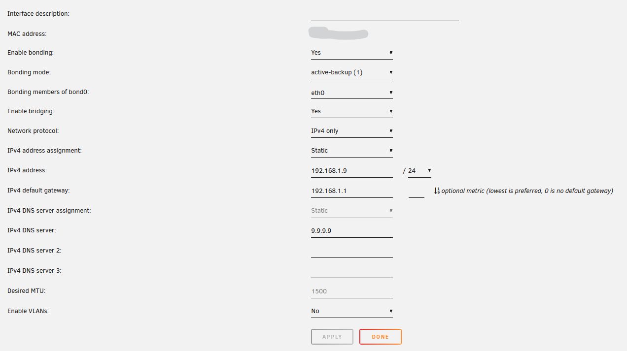

I was in version 6.12.13, I tried to upgrade to 6.12.14, same result. In Settings > Network Settings, I put 9.9.9.9 in IPv4 DNS server 2 and 149.112.112.112 IPv4 DNS server 3 but that doesn't change anything (before I had nothing in these fields).

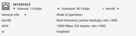

I see network activity on the dashboard even when the server is inaccessible :

Unfortunately it's not possible to change the DNS servers on the Orange Livebox 5 (yes, it's a heresy).
I checked, It was been 9.9.9.9 and 149.112.112.112 on server 2 and 3, those were probably obfuscated by the log.
I will try with 9.9.9.9 instead of 192.168.1.9.

It's now been 30 minutes since I restarted my modem and my server with the DNS server 9.9.9.9 instead of 192.168.1.1 in the network settings.
When I restarted the server 30 mins ago, I didn't even start the array to minimise the risk of further problems (whether from docker or a VM), I just open the terminal every 2-3 minutes to ping 8.8.8.8 and so far it's working.
