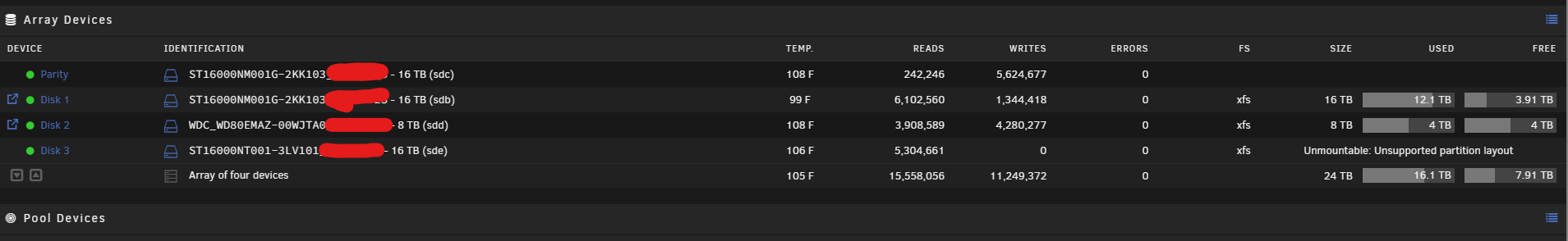

Hi all, looking for some assistance if possible. Installed a new 16TB drive to the Array a couple days ago. Formatted, waited for the clear and thenadded to the array and started adding media to it once it was online.  Today, it's suddenly unmountable.  Drive doesn't show any errors, it just kinda disappeared.

I saw it add two or three movies to this disk.  I was watching something on Plex on Friday night, and after I was done watching the movie, I went back to the main screen of Plex and saw that the movies that I recently added were gone. That's when I went to my computer and saw that the disk was unmountable.
