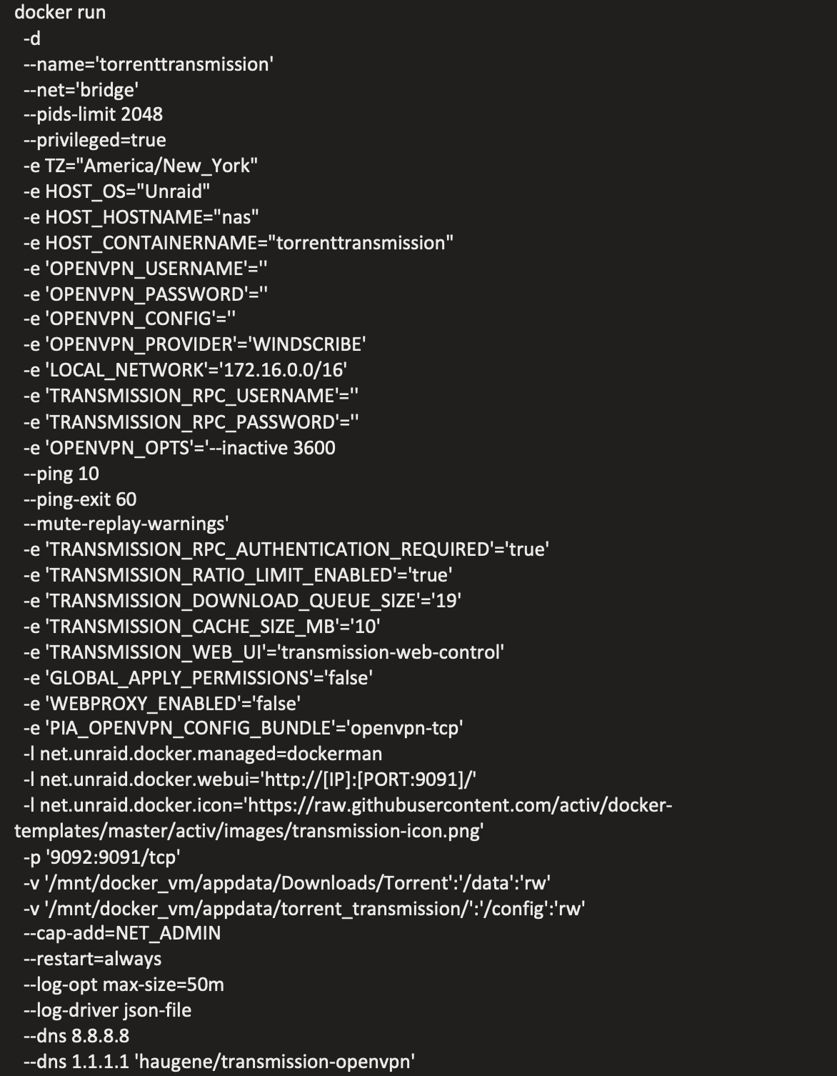

Hi so this problem started after I had a kernel panic and the array shutdown unclean.  a single container seems to always want to autostart.
I've tried:
1.  deleting and recreating the container
2.  renaming it
4.  deleting the docker.img file and recreating it
5.  flipping auto start to on, rebooting, then back to off
despite all of this, the container is always starting when the array starts, even though autostart is off.  i've attached my diags and below is the docker create command (sensitive info removed)
docker run
  -d
  --name='torrenttransmission'
  --net='bridge'
  --pids-limit 2048
  --privileged=true
  -e TZ="America/New_York"
  -e HOST_OS="Unraid"
  -e HOST_HOSTNAME="nas"
  -e HOST_CONTAINERNAME="torrenttransmission"
  -e 'OPENVPN_USERNAME'=''
  -e 'OPENVPN_PASSWORD'=''
  -e 'OPENVPN_CONFIG'=''
  -e 'OPENVPN_PROVIDER'='WINDSCRIBE'
  -e 'LOCAL_NETWORK'='172.16.0.0/16'
  -e 'TRANSMISSION_RPC_USERNAME'=''
  -e 'TRANSMISSION_RPC_PASSWORD'=''
  -e 'OPENVPN_OPTS'='--inactive 3600
  --ping 10
  --ping-exit 60
  --mute-replay-warnings'
  -e 'TRANSMISSION_RPC_AUTHENTICATION_REQUIRED'='true'
  -e 'TRANSMISSION_RATIO_LIMIT_ENABLED'='true'
  -e 'TRANSMISSION_DOWNLOAD_QUEUE_SIZE'='19'
  -e 'TRANSMISSION_CACHE_SIZE_MB'='10'
  -e 'TRANSMISSION_WEB_UI'='transmission-web-control'
  -e 'GLOBAL_APPLY_PERMISSIONS'='false'
  -e 'WEBPROXY_ENABLED'='false'
  -e 'PIA_OPENVPN_CONFIG_BUNDLE'='openvpn-tcp'
  -l net.unraid.docker.webui='http://[IP]:[PORT:9091]/'
  -l net.unraid.docker.icon='https://raw.githubusercontent.com/activ/docker-templates/master/activ/images/transmission-icon.png'
  -p '9092:9091/tcp'
  -v '/mnt/docker_vm/appdata/Downloads/Torrent':'/data':'rw'
  -v '/mnt/docker_vm/appdata/torrent_transmission/':'/config':'rw'
  --cap-add=NET_ADMIN
  --restart=always
  --log-opt max-size=50m
  --log-driver json-file
  --dns 8.8.8.8
  --dns 1.1.1.1 'haugene/transmission-openvpn'
nas-diagnostics-20241215-0704.zip
Solved by Mainfrezzer
2 hours ago, oliver said:
  --restart=always
I wonder why😄
8 minutes ago, Mainfrezzer said:
I wonder why😄
wow...just wow LOL.  i have no recollection of adding this (this problem had been going on for a while), thank you for pointing it out lol.
