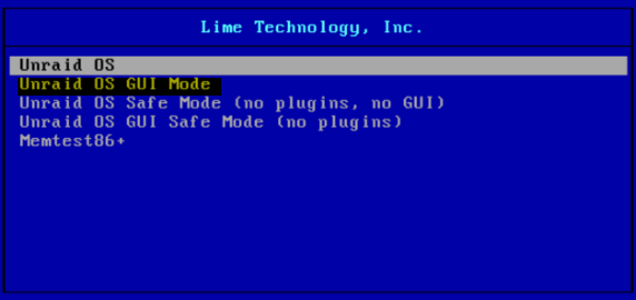

You can boot into GUI mode and uninstall the plugin, then reboot.
Well, that's the issue. The GUI won't load.
Using the GUI boot mode? That is done locally:
