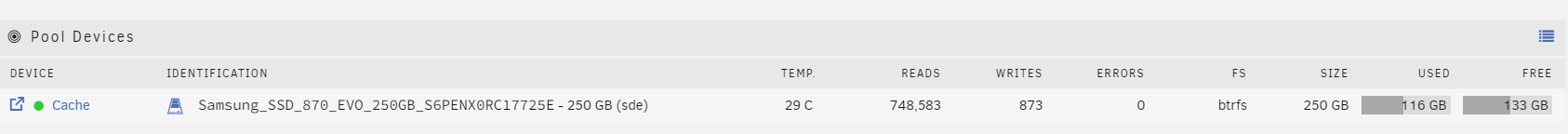

Cache Drive suddenly "unmountable: unsupported or no file system"
Cache drive suddenly unmountable/unsupported.
Tried stopping array, unassigning, reassigning etc.
Cache drive apparently is associated with my Docker so none of those show up now.

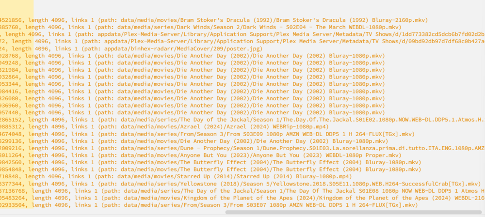

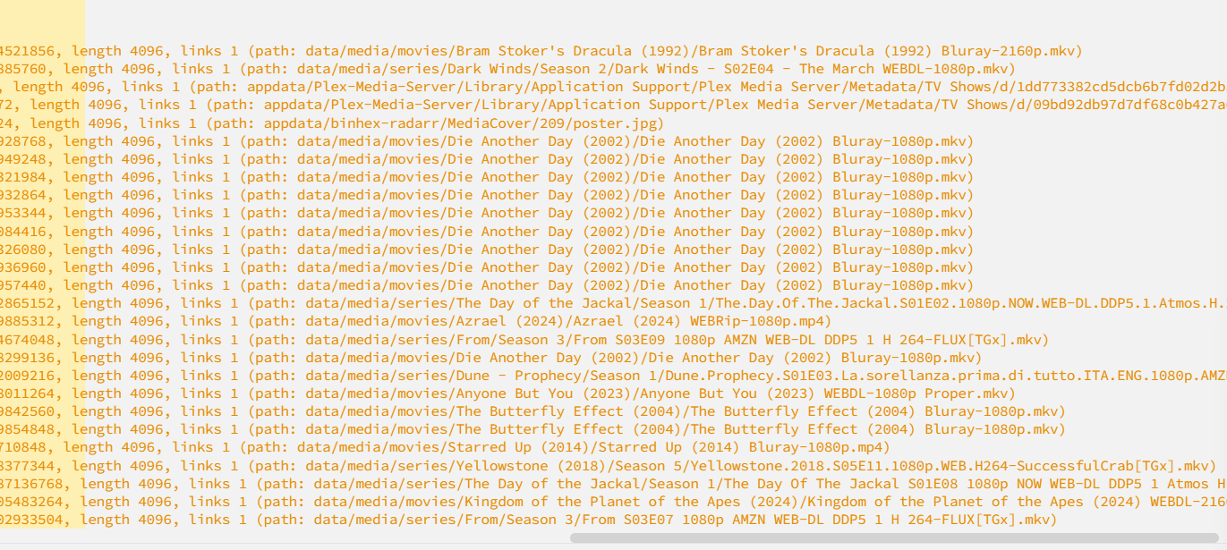

I can go to the sys log and looking at each of the log types am I right in saying its the "warnings" im interested in?
As that the only place i can see lines like
"Dec 17 10:07:51 Tower kernel: BTRFS warning (device sde1): checksum error at logical 104288641024 on dev /dev/sde1, physical 89264644096, root 5, inode 4074617, offset 373710848, length 4096, links 1 (path: data/media/movies/******/********.mp4)"
I haven no problem with just losing these data/movie files.
But i dont see anything listed related to Docker/my containers which is all that i am interested in.
Sorry, quite a noob at this.
Edited by ItzMar
Yes, they should be logged during the scrub, after deleting/restoring, run another scrub to confirm 0 errors.

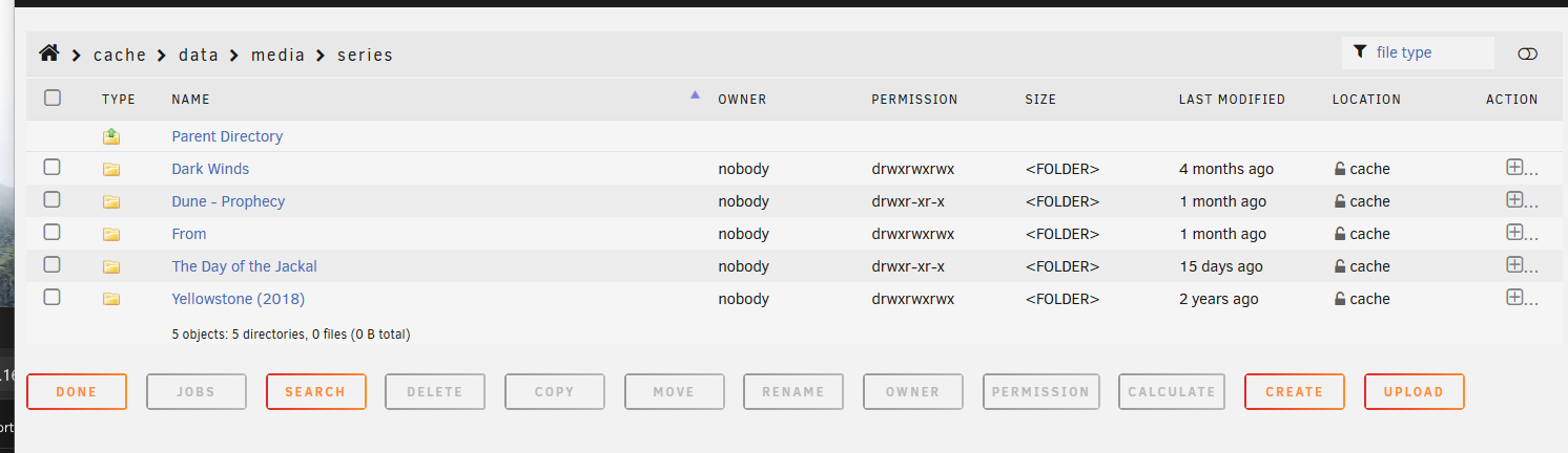

Im confused, i dont see anything about my docker containers in the logs only data files.
Then if i try to delete those data files i cannot, i see nobody is the owner, but it wont allow me to change the owner either.
That means those files are still in the pool, the mover will fail to move if they are corrupt, but you should be able to delete them manually, try using the CLI.
