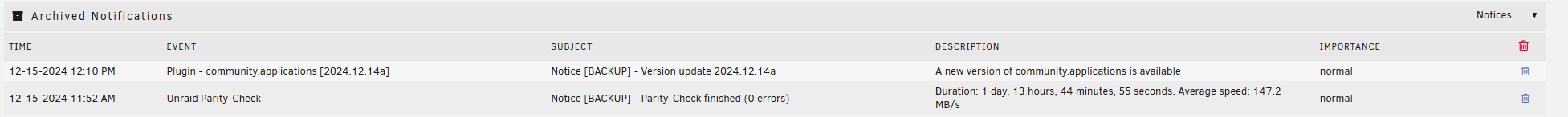

Alright, this one has my head scratching.  On friday, i ran my weekly backup to my server that is only booted up to do a backup.
I thought that a scheduled parity check just so happened to land on friday....that's fine, i'll just let it stay on for an extra 2 days while it does a check.

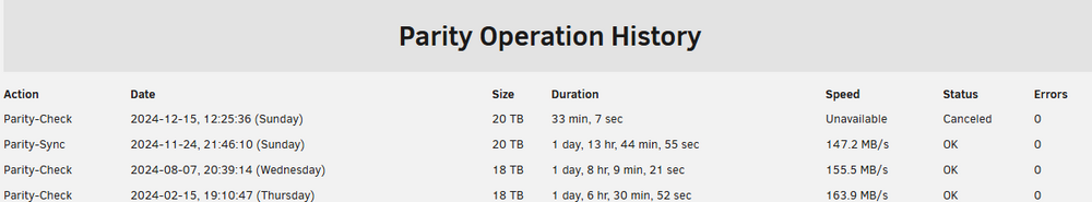

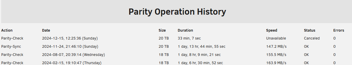

I go to check on it today (should be done) and it says it just started.  I look at the notification and says finished with zero errors....but it started another one and doesn't show the completed one in the history.
I then check my scheduler settings and realize that i disabled scheduled parity checks.  Hmm
So now i'm thinking that for some reason it did an unclean shutdown previously and ran one on startup....but i'm not sure why it would have started another one.
