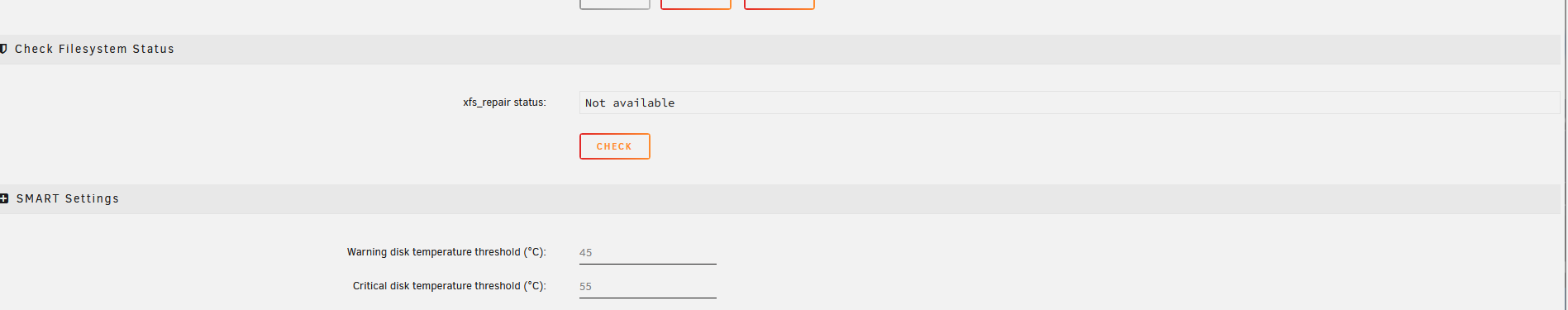

ive looked for the above, and read the link, but i dont have the option to do this via GUI. please see attatched screenshot
Click on "Check"

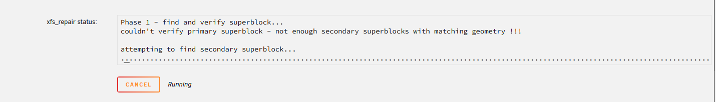

i did, but i just get an endless supply of dots that never finishes... is this normal? image.thumb.png.c7ca1feefe7b04b3119d58a4cab79069.png
That means there's no valid filesystem on that disk, we can't see what happened because the syslog rotated, but possibly the rebuild was incorrectly done, or there were errors.

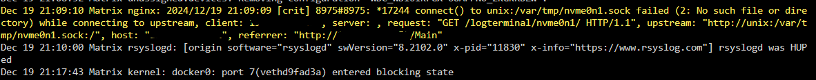

also. just check my log, and can see this message ive not seen before. do you know what this means?

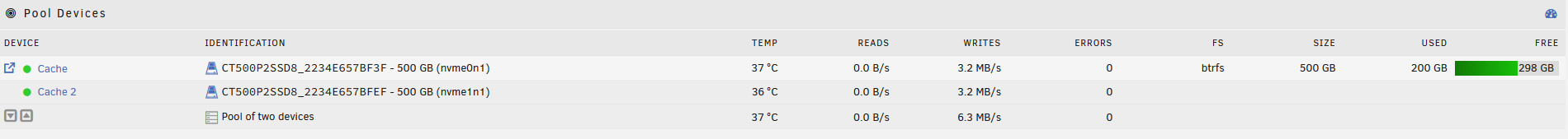

i did a Smart can on my NVME cache drives and it came back good with no errors.  i also thought i had 2x500gb nvme's but looks like 1? has one failed?

Those nginx errors should be harmless
