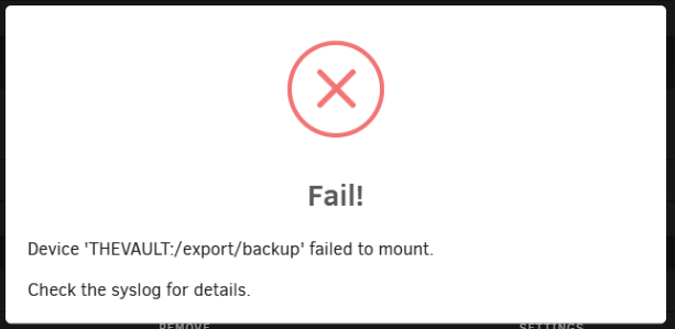

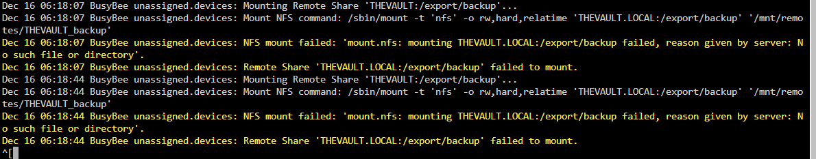

I added a new server this weekend, running v7.rc.1. When I went to bed last night, it was running everything perfect. When I woke up this morning, it no longer could connect to the NFS shares that I have available on 2 other machines (Unraid v6.12.24 & OpenMediaVault). It finds the servers & their shares, attempts to connect, but fails every time. I can connect to the failed servers NFS share without issue from either of the other 2 servers.I've rebooted multiple times, but the issue remains the same.

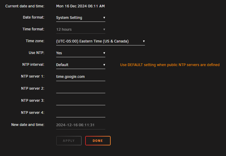

The only thing that I found was weird was the computer's time. I went into the BIOS at boot and the time was 5hrs ahead. It was showing the time as 10:58 when the local time was 05:58.

I *may* have found the issue. It's possible that the network cable wasn't making a good connection. I started having random internet disconnections on the v7 machine and swapped the cables. Rebooting everything now. Fingers crossed.
good news - the bad cable was the issue. Everything connected instantly on reboot.
