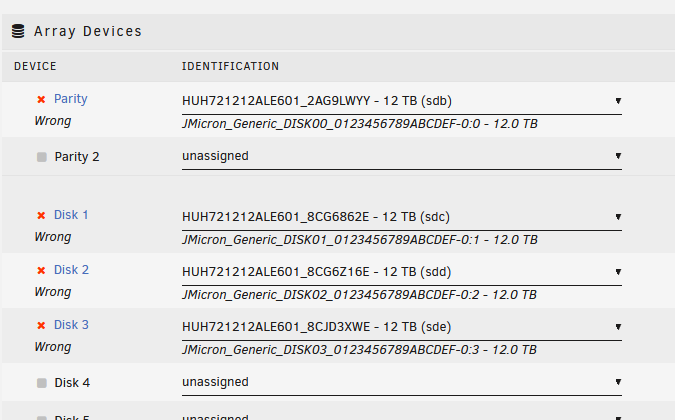

I ran into the issue with Unraid seeing the JMS567 controller port fake serial numbers as duplicated while attempting to add the 2x WD drives.
The new drives had the same serial numbers as the current drives.

Thank you. I have grabbed screenshots of the array under the "Main" screen. I have also gathered serial numbers using `hdparm -I /dev/sd# | grep Serial\ Number` .
I have a list mapping the array slots to the serial numbers. I now know which drive is Parity.
I will have the new drive enclosure this weekend. Wish me luck!

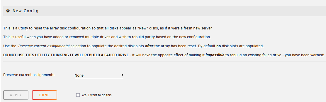

I have the 4 drives in the new array. I have assigned the parity drive to the parity 1 slot, and the other 3 drives to slots 2-4.
I am unable to start the array.
I do not know what to do on the "New config" screen. What should I do without loosing any data?
I see my data and parity is being rebuilt. :)
