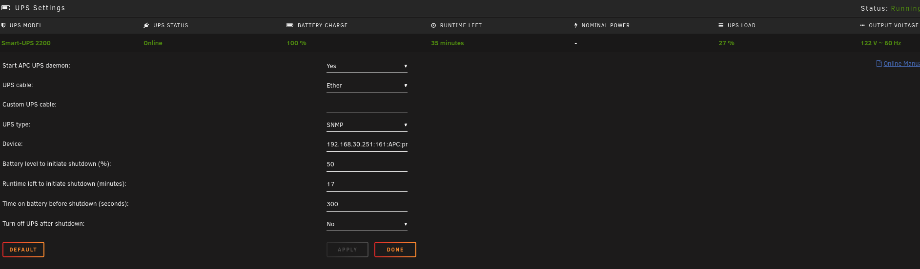

Unraid goes unresponsive during a power cut, even on UPS.
I have a recurring issue where Unraid freezes and is completely unresponsive whenever there is a power cut.  UPS has more than  enough power and can run for 30+ minutes on battery.  However, even if there is a 5 second power cut Unraid becomes complete unresponsive and I'm forced to do an unclean shutdown.  When I initially set it up and tested it by unplugging the UPS it shut down fine.  I'm afraid to test it again as it looks like everything is configured correctly.  When the server becomes unresponsive I can't even SSH into it, it's 100% unresponsive.  That being said, even though Unraid is totally unresponsive I can connect to numerous containers and they will run fine.  After the unclean shutdown I have to deal with corrupted files and databases.  Also, even if I turn off all my VMs and containers performance is terrible.  So bad that trying to connect to a share from a Linux or Windows VM just times out.  My CPU utilization is at 50% consistently since the issue and the containers and VMs aren't causing the high utilization and there is only 1 disk being checked or file integrity.  It makes the system unusable as Plex thinks the server is down the performance is so bad,
I've scoured the syslog every time to see if I can find any hint of an error but there is nothing.  I can't figure it out and I've run out of ideas of what else I can do to investigate.  Anyone have any ideas what could cause this issue or what else I could do to further investigate?

First to verify does PC unresponsive due to power source switching, disable APCUPSD then try turn off and on main power source.

No, all networking equipment are on UPS'.  This is an enterprise 3000VA UPS and it doesn't have any surge only outlets.  When  Unraid shits the bed I can ping the server and it responds but it refuses any other interaction.
29 minutes ago, Bmalone said:
To be clear, you're suggesting that I disable the APC daemon and then just unplug the UPS from the mains?
Yes, this to verify does problem come from power source switching.

I don't think the UPS is underpowered as is 220v 3000va and even with both my primary and backup server running it's only at 40% load.  Also, the battery is 10 months old.

5 minutes ago, Frank1940 said:
Personally, I think the OP now has two problems.  The original one is probably in the UPS.  One thing I would be looking at is the actual storage capacity of the battery.  That server has a CPU with a 145W TDP and 19 drives in it.  IF that battery is more than about 18 months old, I suspect it can not power that server as it tries to shutdown and the output of the UPS goes bonky...
The second problem is the present running state of the server.  It is possible that the UPS wonky output corrupted something on the boot drive or in the Docker or VM configuration files.
This morning I stopped all containers except Syncthing, as I'm currently syncing to my backup server, and the CPU usage remains unchanged.
Disable the docker service and boot in safe mode, if all looks normal like that, recreate the docker image, and see if performance remains good:
https://docs.unraid.net/unraid-os/manual/docker-management/#re-create-the-docker-image-file
Then:
https://docs.unraid.net/unraid-os/manual/docker-management/#re-installing-docker-applications
Also see below if you have any custom docker networks:
https://docs.unraid.net/unraid-os/manual/docker-management/#docker-custom-networks
Then:
Thanks.  I'll try that.  I kicked off a restore of all my appdata and containers from before the incident so I'll just let that complete first.
Then:
So I tried this and I wasn't able to stop the array to boot into safe mode.  I did everything except booting into safe mode and performance looks good with the Docker service stopped, but deleting the docker image and reinstalling all the apps produces the same issue.  I see lots of these errors in the syslog.
Dec 26 11:33:05 Goathead root: rmdir: failed to remove '/mnt/user': Device or resource busy Dec 26 11:33:05 Goathead emhttpd: shcmd (1754): exit status: 1 Dec 26 11:33:05 Goathead emhttpd: shcmd (1756): rm -f /boot/config/plugins/dynamix/mover.cron Dec 26 11:33:05 Goathead emhttpd: shcmd (1757): /usr/local/sbin/update_cron Dec 26 11:33:05 Goathead emhttpd: Retry unmounting user share(s)... Dec 26 11:33:10 Goathead emhttpd: shcmd (1758): /usr/sbin/zfs unmount -a Dec 26 11:33:10 Goathead root: cannot unmount '/mnt/containers_cache/appdata': pool or dataset is busy Dec 26 11:33:10 Goathead root: cannot unmount '/mnt/containers_cache': pool or dataset is busy Dec 26 11:33:10 Goathead emhttpd: shcmd (1758): exit status: 1 Dec 26 11:33:10 Goathead emhttpd: shcmd (1759): umount /mnt/user Dec 26 11:33:10 Goathead root: umount: /mnt/user: target is busy. Dec 26 11:33:10 Goathead emhttpd: shcmd (1759): exit status: 32 Dec 26 11:33:10 Goathead emhttpd: shcmd (1760): rmdir /mnt/user Dec 26 11:33:10 Goathead root: rmdir: failed to remove '/mnt/user': Device or resource busy Dec 26 11:33:10 Goathead emhttpd: shcmd (1760): exit status: 1 Dec 26 11:33:10 Goathead emhttpd: shcmd (1762): rm -f /boot/config/plugins/dynamix/mover.cron Dec 26 11:33:10 Goathead emhttpd: shcmd (1763): /usr/local/sbin/update_cron Dec 26 11:33:10 Goathead emhttpd: Retry unmounting user share(s)... Dec 26 11:33:15 Goathead emhttpd: shcmd (1764): /usr/sbin/zfs unmount -a Dec 26 11:33:15 Goathead root: cannot unmount '/mnt/containers_cache/appdata': pool or dataset is busy Dec 26 11:33:15 Goathead root: cannot unmount '/mnt/containers_cache': pool or dataset is busy Dec 26 11:33:15 Goathead emhttpd: shcmd (1764): exit status: 1 Dec 26 11:33:15 Goathead emhttpd: shcmd (1765): umount /mnt/user Dec 26 11:33:15 Goathead root: umount: /mnt/user: target is busy. Dec 26 11:33:15 Goathead emhttpd: shcmd (1765): exit status: 32 Dec 26 11:33:15 Goathead emhttpd: shcmd (1766): rmdir /mnt/user Dec 26 11:33:15 Goathead root: rmdir: failed to remove '/mnt/user': Device or resource busy Dec 26 11:33:15 Goathead emhttpd: shcmd (1766): exit status: 1 Dec 26 11:33:15 Goathead emhttpd: shcmd (1768): rm -f /boot/config/plugins/dynamix/mover.cron Dec 26 11:33:15 Goathead emhttpd: shcmd (1769): /usr/local/sbin/update_cron Dec 26 11:33:15 Goathead emhttpd: Retry unmounting user share(s)... Dec 26 11:33:20 Goathead emhttpd: shcmd (1770): /usr/sbin/zfs unmount -a Dec 26 11:33:20 Goathead root: cannot unmount '/mnt/containers_cache/appdata': pool or dataset is busy Dec 26 11:33:20 Goathead root: cannot unmount '/mnt/containers_cache': pool or dataset is busy Dec 26 11:33:20 Goathead emhttpd: shcmd (1770): exit status: 1 Dec 26 11:33:20 Goathead emhttpd: shcmd (1771): umount /mnt/user Dec 26 11:33:20 Goathead root: umount: /mnt/user: target is busy. Dec 26 11:33:20 Goathead emhttpd: shcmd (1771): exit status: 32 Dec 26 11:33:20 Goathead emhttpd: shcmd (1772): rmdir /mnt/user Dec 26 11:33:20 Goathead root: rmdir: failed to remove '/mnt/user': Device or resource busy Dec 26 11:33:20 Goathead emhttpd: shcmd (1772): exit status: 1 Dec 26 11:33:20 Goathead emhttpd: shcmd (1774): rm -f /boot/config/plugins/dynamix/mover.cron Dec 26 11:33:20 Goathead emhttpd: shcmd (1775): /usr/local/sbin/update_cron Dec 26 11:33:20 Goathead emhttpd: Retry unmounting user share(s)...
There's something using those mount points preventing them from unmounting, you can start one container at a time and retest to see if it's one of them.
Could also be a plugin, so also good to start in safe mode to rule out those.
Performance issues solved, but no root cause of the issue.
So I followed the instructions and started one container at a time.  I would check CPU/RAM usage, speed of browsing file system, and then reviewing each line in the logs carefully after starting up the container.  I found more than one container that had a malformed DB or didn't show any clues in the logs but performance was notably impacted.  For those containers I deleted them and the appdata and recreated and reconfigured them.  Took a few days but it worked.  I think the thing that was preventing the array from stopping was an update to FileBot that required an opensubtitles.com login to be added to the container configuration.  Since it was started without this, there was no way to fix it, kill it (CLI or GUI) and so I just needed to do an unclean shutdown.
Now, what I still can't understand is how it is possible for a power outage where none of my servers powered off while attached to a fully functioning APC UPS to corrupt my containers.
Where are the clients located that write to those databases?   When the powercuts occur, does your UPS continue to power the entire LAN so that these clients are not dropping the connection to the containers?
Is the battery in the UPS capable of powering the full load required?  (Don't tell us that the software 'says' that it will!  Test it using an actual load to determine the run time to UPS shutdown--- Incandescent lamps are good for doing this.)
