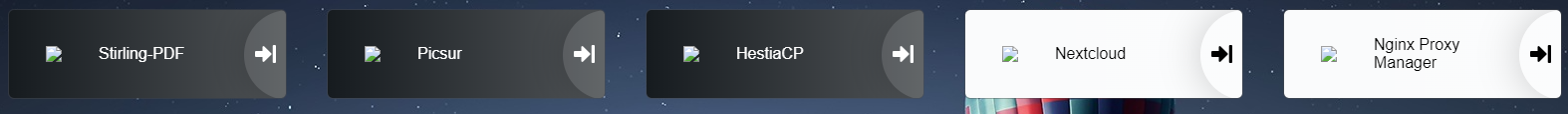

Heimdall. This began yesterday. The created dashboard items no longer display their icons. I proceeded to remove the app, reinstalled, and re-created dashboard items. Everything worked as expected until this morning where things are back to being broken. In the past when creating some known dashboard items (eg. Deluge) Heimdall would fetch the app icon automatically. That no longer happens

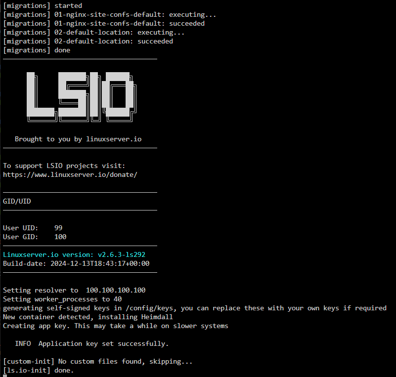

This i what is contained in the Heimdall Log
Not seeing anything relevant in the log, lot of SSH spam, but I assume they are connections you are doing, and should be unrelated.
@JorgeB STOP the presses. By the way, I neglected to mention that I have been using Brave browser as my default browser for the longest time.  I thought that I might try accessing the Heimdall dashboard using Firefox and/or Brave in a private window. Everything appeared as it should. Also functioned well when accessing from another PC. I should have known better. Been at this long enough. Thanks again for your time and patience. Greatly appreciated. Have a wonderful day!
