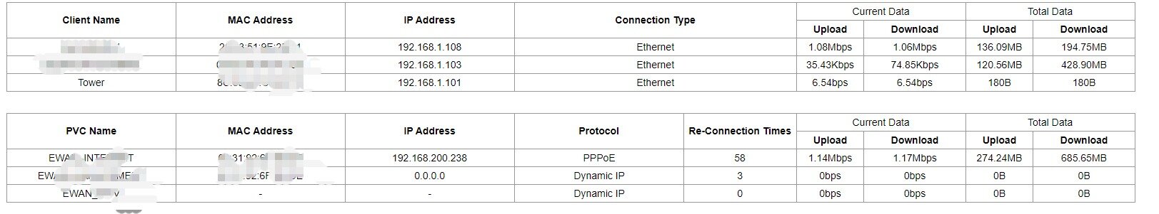

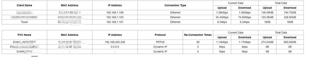

then till now ı am not able to reach tower/local nor to ip address which is shown up on the server (by the way ı have entered the username as root and ı think it worked) and also ı have checked my router. ı will give screenshuts of them.

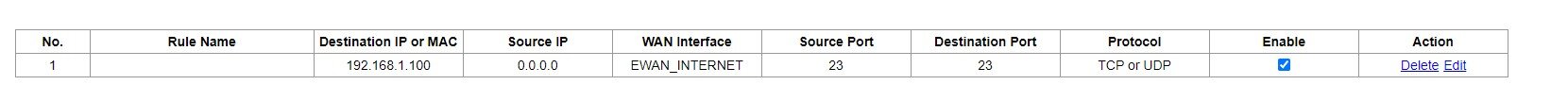

there was a port arrangement in one form ı dopnt know if it i,s related to me. but ı tried to arrange it somehow. ı dont understand those issues quite perfectly

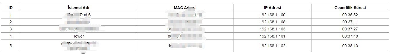

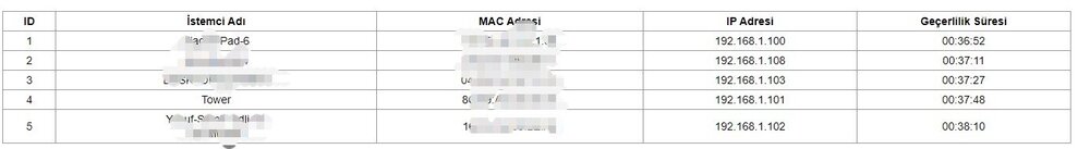

ı have also put some photos of my router since ı dont know which parts are relevant

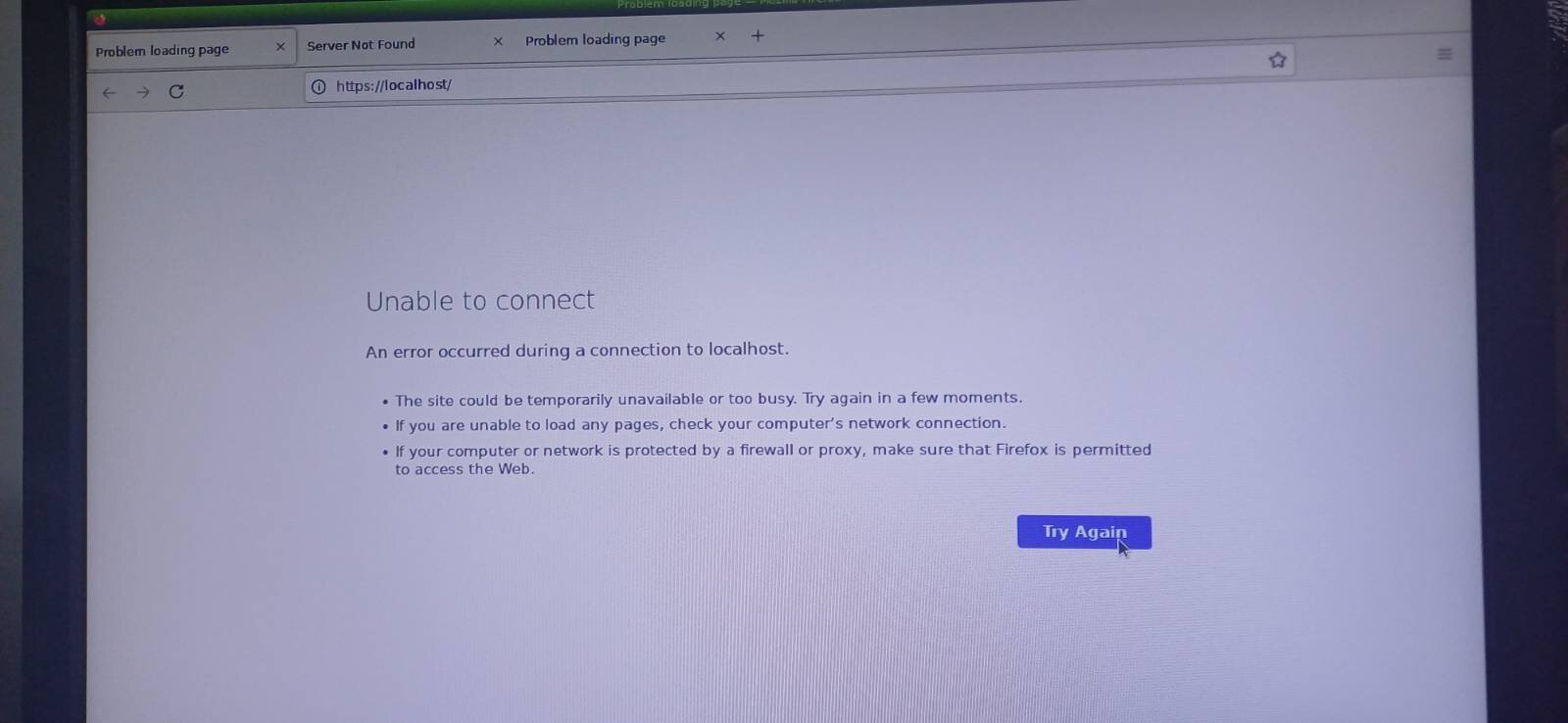

now ı also tried unraid gui sections during booting it seems something also going on there
Flash drive is missing files, including the go file, you will need to recreate it.
